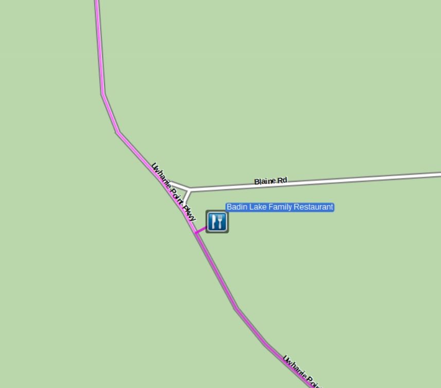

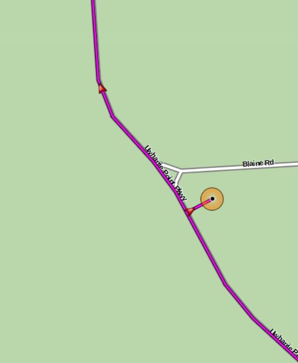

It doesn't need to be a new shaping point. I am just thinking about the ramifications of replacing via points with alerting points. Below is an example where I have replaced a lunch stop at the POI via point Badin Lake Family Restaurant with an alerting shaping point named Badin Lake Family Restaurant. The coordinates of this POI via point may not be off-road enough that the XT would force me to skip if I didn't pull in but usually they are. This problem is alleviated with the alerting shaping point. The XT will route me to it but won't care if I bypass it and continue on the route.
WP vs SP 3.JPG (26.55 KiB) Viewed 3961 times
WP vs SP 5.JPG (23.24 KiB) Viewed 3960 times
