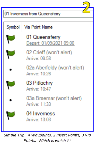

7. Assign Via Point or Shaping Point Status  Pic 2
In The Data Window, bottom left pane, open the route properties - (double click on a PC). This will show all of the route points in order. Some will be in dark lettering. These are the Via Points. Some will be in grey lettering with the comment (wont alert) after the name. These are the Shaping Points. Right click on each point that is not set correctly and choose the option ‘Alert on Arrival’ or ‘Do Not Alert on Arrival - Shaping Point’. You can change a whole contiguous block of points at once.
While you have the route properties dialog box open, change the name of the route. I like it to show where I am going first rather than where I am when I start the route, and will often put the day number or date at the front. So 01 Inverness from Queensferry, or just 01 Inverness.
