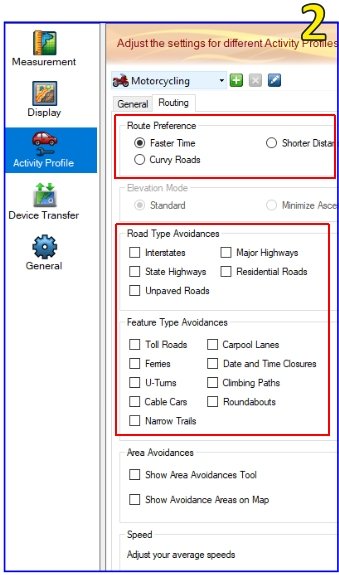

I do however, use several custom profiles in BC (like "MostlyDirt" with only "Unpaved roads" left unchecked and "MainHwys" with only "Interstates" and "Major Highways" checked) to get BC plot the magenta line close to the way I want it. Then I will 'nail down" the route with via/shaping points by switching between the "Motorycle" profile and the custom profile. When the magenta line stays put between the two I figure it is good to export to the XT.

Thanks for the very kind comments, and for your contribution.groundhog719 wrote: ↑23 Feb 2022 18:29 I do however, use several custom profiles in BC (like "MostlyDirt" with only "Unpaved roads" left unchecked and "MainHwys" with only "Interstates" and "Major Highways" checked) to get BC plot the magenta line close to the way I want it. Then I will 'nail down" the route with via/shaping points by switching between the "Motorycle" profile and the custom profile. When the magenta line stays put between the two I figure it is good to export to the XT.
Regarding the use of custom profiles. That is an excellent way of doing things. Please allow me to add a little.
Profiles contain all of the information about routing and avoidances that you want to use every time for the vehicle that you specify.
None of that information gets transferred to the Zumo though - except the vehicle and the shorter/faster routing option.
When you edit the preferences in the profile in Basecamp, it recalculates every route that has used that profile.
A custom route doesn't do this. The same routing and avoidance options that can be set in a profile are also available for a custom route - but they are stored as part of the custom route. Change anything in that dialogue box and the changes to the map are instant - you don't have to close down the dialog box before you see them - so you can experiment with the changes and see the effect very quickly.
If you place a track on the map of where you want to go, the small deviations will be very easy to spot.
When finished, simply apply the motorcycle profile. Or not. The XT defaults to using the motorcycle profile for any route that it receives that is not a car or a motorcycle. It also resorts to using faster time unless shorter distance is selected - even if curvy roads is chosen.
