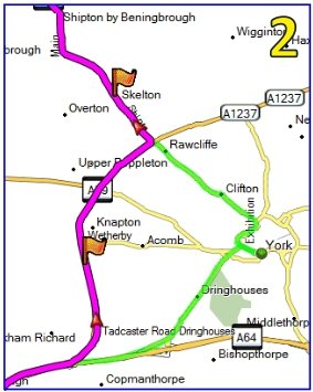

See Pic 2. I have placed 2 Via Points on the intended route. Only
one of them is needed, and the route will stay the same if either of
them was removed. So which one do you get rid of?
Consider this: If you
deviate from the original route and head into York for lunch (on the
green line) - which point works best for the route AND for the deviation?

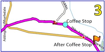

- At coffee stops, give yourself an option - whether to stop or not. Put the Via Point on the road that you want to be on after the coffee stop, whether or not you actually stop for a break. Mark the coffee stop with a Shaping Point.
See Pic 3. If you decide not to stop and stay on the yellow road - the satnav will still try to navigate you to the blue disc
shaping point, by the quickest way. ie go back. About half way along the yellow road, it will have worked out that it is faster to carry on and
turn left at the red circle (so for a while it is happy for you to continue as you are.
At the red circle it will tell you to turn left - still trying to get you to the blue disc. Just carry on past the left
turn, and all will be well. You have missed out a shaping point, but have joined the magenta route after the shaping point - and that is allowed.
Or you could just press the Skip button to miss out the coffee stop - but on the XT, that means closing down any display that you have on the right hand side, and then putting it back again.
