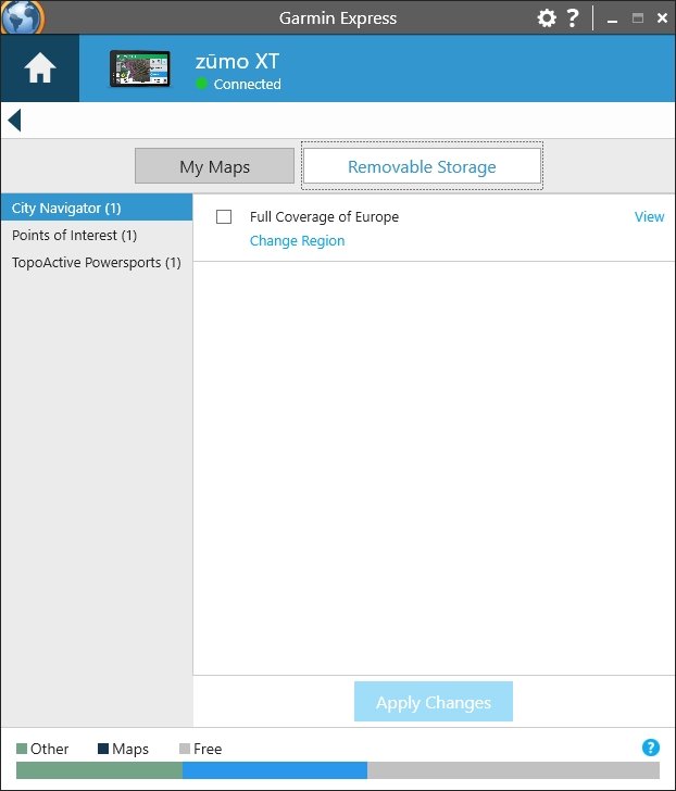

Excuse this question becasue it may sound impertinent if you have done it this way already. But if you haven't done it this way, I wouldn't be surprised. I've never bothered looking at this part of Express before. So I am just checking.....
I have just tried to install onto my SD card - it won't let me because I have the map in internal storage already - but it struck me that the way to install the map onto the SD card isn't quite where I expected the option to appear. The image will enlarge to 100% size if you click it.
Express Map SD Card.jpg (36.52 KiB) Viewed 4231 times
To get to this screen from Express. Select Manage Maps. Not the Install All button or the Map details link.
That gives the above screen with the tab that is labelled Removable Storage.
It seems that it needs to be installed from there. I ticked the box and selected Apply Changes. It asked me to confirm that I wanted to move it from Internal Storage. I can't have it installed in both places.
So following that route should work. This is version 7.9.1.0 of Garmin Express.

I am also using version 7.9.1.0 of Garmin Express. On the home page where one can update maps or firmware, if I click on Map Details, it shows only “Full Coverage of North America 2022.25”, despite Basecamp showing the unit as having “City Navigator Europe NTU 2022.2 installed.
In the tab “Tools and Content” I can select the tab “Purchased”, where it allows me to re-download either or both of the Europe maps that I have purchased. If I select the most recent Europe map, it detects that there is a memory card inserted, and indicates that it will install the map to that memory card. If I then select “continue”, I get an error message “There was an error installing the content”, so…Express detects the card, but cannot download on to it. I have changed sd cards, I have double checked to make sure that the card was installed correctly and locked in place.
I note that I never see the screen that you posted a screen shot of..nor do I ever see “manage maps”
