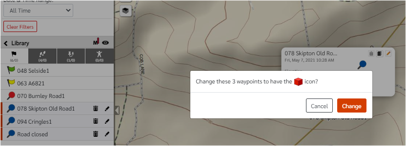

Ok - just done it. Send the waypoints from Basecamp to Zumo
Synch Explore Zumo XT with Explore account.
In Explore website, select all of the Waypoints that you want to change in the collection / Library pane on the left
(on PC, you click one, and then CTRL click the others you also want to select)
Then click on the pencil / edit icon for one of the selected waypoints and change it.
You wil get a message asking to confirm that you want to change x items.
Synch the XT with the Explore account again.
In the screen shot (click on it to get a larger image) I have selected the bottom 3 waypoints from the list.
