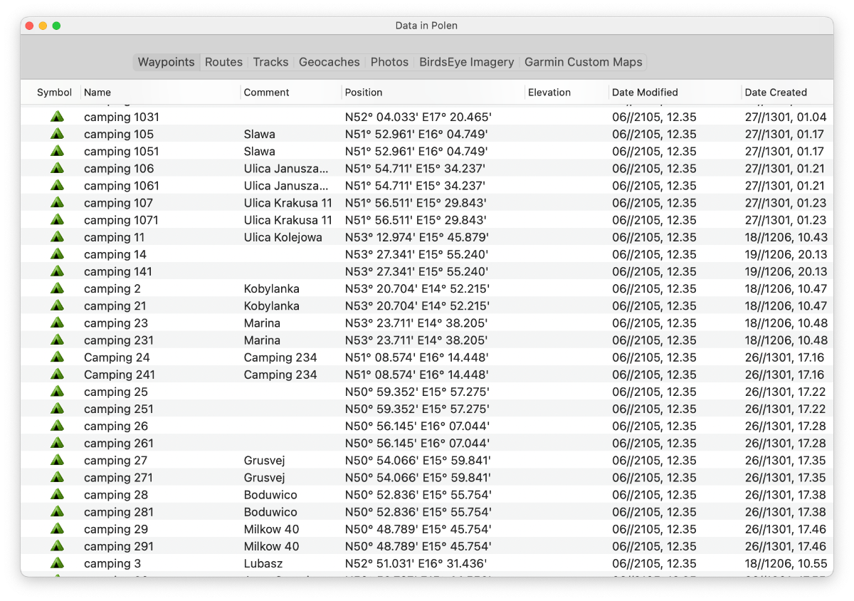

when in basecamp the window says waypoints, I would like them to show up on the map ;)

Re: How to see Waypoints
Mester wrote: Thu May 06, 2021 7:50 pm when in basecamp the window says waypoints, I would like them to show up on the map ;)
Because the gpx file 'came from a friend' - I had no idea what sort of point it would be. May people use the term 'waypoint' to refer to any point on a route. (As do some mapping programs, and some tech support people in my experience !).
True Garmin Waypoints (also referred to as Favourites in the XT) can be made to show up on the XT map using the following menu:
Settings->Map&Vehicle->Map Layers->Collections->Choose what you want to appear on the map.
also
Where To->Explore->Spanner Icon top left->Collections on Map-> to get to the same menu as above
These are linked to your Garmin Explore Account.
Is that screen shot that you included what you get on an Apple when you display the route details ?
We don't have that on the PC. We have one that is possible the PC version - but our is headed Via Point - and that heading isn't an accurate description, as some of the points listed are not Via Points ! I have come not to trust the programmer's terminology.
However, if your gpx file has come Via Garmin Explore, then it doesn't deal with any points other than Waypoints - so one of the above two methods should work.
