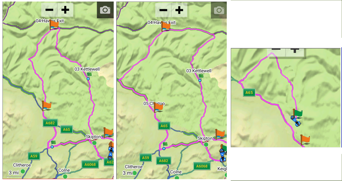

Ok I managed to get out on Monday. Time, Sunny day, dry roads - so I was able to do the 2nd and 3rd tests of my well tried and tested RUT test route.
Result - the XT2 is well capable of getting stuck in a RUT. But a very easy solution definitely fixes this behaviour.
The image on the left is the planned route as produced in Basecamp and how it appears in the Zumo XT2 after it has been imported. The route starts bottom right, and travels in a counter-clockwise direction passing through saved Waypoints
01 Start (about a mile up the road) from my current location.
02 A65 Skip this.
03 Kettlewell (set as a shaping point)
04 Hawes Exit
05 Cleatop
06 is another shaping point - and I'm not bothered about anything after 05 Cleatop.
The first image shows the original route from Basecamp. The second image shows the recalculated route - the same as that produced after pressing Skip to miss out 02 Skip This Via Point. I intend to take that early trun to the South of my first picture - thus deviating from the XT2s recalculated route.
The third image shows what happened on a previous test on the XT - I was 3 miles from the Via point at Cleatop having put up with 11 miles of U turn request every few hundred metres. It was sill insisting that I go back to the junction. In fact it isn't trying to get me to go to the junction - each U turn request only calculates a new section back to its previous calculated route - a few hundred metres back.
Ribblehead RUT v OK.png (767.73 KiB) Viewed 3749 times
But this final test using the Copied route on the XT2, the route recalculate south - just like image 2 - and it did it the moment that I took the road south instead of continuing along the plotted route.
And Yes, the mImport Byte fix makes it behave properly. But the Copy function on the XT2 is a nice easy option - similar to resaving the active route on the XT - but that methods adds your current location as the new start. The XT2s Cpy function doesn't - and the new route behaves exactly like a route that has been built on the XT2 itself.

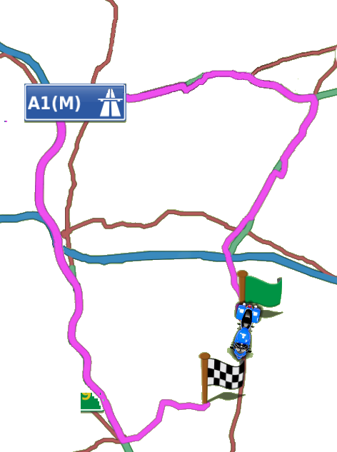

The key thing is to know whether you have RUT behaviour or whether the XT / XT2 wanting you to perform a U turn is actually the most sensible routing decision that the Zumo can make. If you turn off a plotted route, the XT and XT2 are perfectly entitled to say - "Oi you, stupid idiot, the route I have plotted will get you to the next route point in 10 miles/10 minutes. Going your way will take 20 miles/20 minutes. In quarter of a mile make a U turn."
Although it doesn't often say the first bit, it would be quite right in doing so. It would continue to be quite right in doing so for the next 5 miles/5 minutes. You haven't entered a RUT just because it keeps asking for a U turn every quarter of a mile for the next 5 miles.
After 5 miles, it is 15 miles to the next route point whichever way you go. So some time after that you could expect it to say - "Ok then, you're still a stupid idiot but we wil continue this way. Continue on B1234." (Again it doesn't often say that first sentence).
There are more definite indications of being stuck in a RUT - but you need to stop at the roadside and get screen shots to prove it.
In the attached screen shot the XT was stuck in a RUT loop. I am at the green flag less than 3 miles from my final destination. The magenta line is the route that the XT wants to take me in order to reach that point. This situation is described with detailed explanation and pictures here.
A1 RUT Example.png (101.64 KiB) Viewed 3412 times
