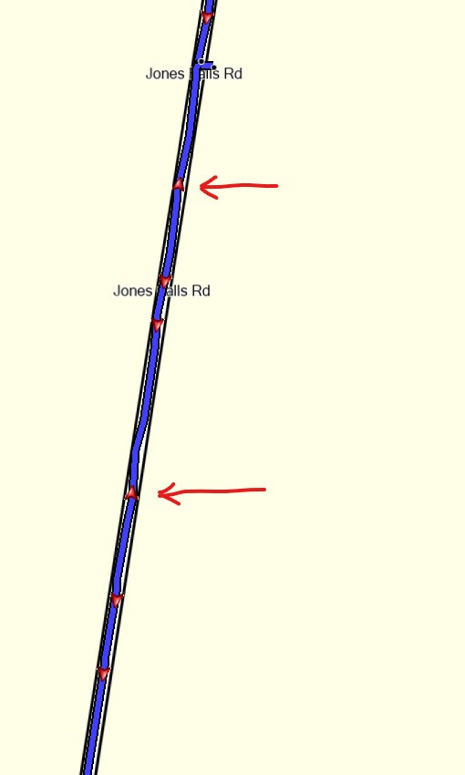

Now, I am attaching a screencap of a slightly different route. The sole difference between this one and the 'ice cream" one is that is does not head off to the ice cream store. You can see that in two spots, the route reverses direction. The correct direction of travel is down.
Question: What have I done to cause that?

gwilki wrote: Tue Jul 02, 2024 1:10 am You can see that in two spots, the route reverses direction. The correct direction of travel is down.
It usually means your points are not in the correct order. You might also see arrows pointing both ways when zoomed out on a divided highway, if you placed a point on the wrong side of the divider.
Jones Falls Rd is not divided, so in Basecamp set your map and zoom to show the route. Then open the point list and click on each point in turn to see them highlighted on the map. When the highlighted point moves backwards you have found the out of sequence point. This is an instance when "Center map" should NOT be checked in the point list, as it only shows one point at a time.

gwilki wrote: Tue Jul 02, 2024 1:10 am Now, I am attaching a screencap of a slightly different route. The sole difference between this one and the 'ice cream" one is that is does not head off to the ice cream store. You can see that in two spots, the route reverses direction. The correct direction of travel is down.
Answer: I don't know. But I can make a couple of guesses. (
[edit. Yes I do, Ive just spotted those two route points at the top of the shot.I'll leave my answer as it was and add a bit further down]
Info: The route points are out of order. Sometimes caused by dropping a point on the wrong side of a dual carriageway, or accidentally dragging and dropping a single point in the trip list. I like Basecamp for a lot of reasons, but one of the best features not offered by many web based programs is the multi-step undo button. And redo button. If you get a 'what happened then / what did I do' moment - you can just undo the last operation(s), and then redo them.
Solution To find them and check the route for others: Display the entire route on the screen. Open up the route list. Set the 'Center Map' and 'More Info' check boxes to not ticked. Move the route and the route list box so that you can see the entire route. Click on the first route point in the list. Note that the selected point is spotlighted on the map. Hold down the down cursor key - or tap it repeatedly. Watch the movement of the spotlight. Any points placed in the wrong order become very obvious as the spotlight seems to hesitate or go back and forth.
Speculation: It is sometimes caused by having too many route points and one or two of them being misplaced, or route points in the right order, but on the wrong side of the road, or on a side road where a turn to the offside is not possible.
[edit]I see two route points at the top of the map. At least one of them is misplaced. You drive on the right hand side of the road and one of the points is set on the east side - the left hand side in your direction of travel. In order to get to it it needs a left turn, across the oncoming traffic. This may or may not be allowed, but the map thinks that it isn't allowed. So there are three route lines plotted one heading south ignoring the left turn, one heading back north to get to the route point, now in the right hand side of the road, one heading back south to where it was trying to get to in the first place. I guess the second route point was placed trying to fix the problem before understanding what the problem was. Not surprising really. It took me a long time to spot it [/edit]
Solution: Having done the trick above with the route list spotlight, do it again with the 'Center Map' option ticked...select one point at a time using the cursor key to move down the list. It zooms in on each point in turn and will reveal misplaced points. Since it takes a little setting the route list and map on the screen, note which point it is in the trip list and continue with the checks on other points. Go back to fix any errors later.
