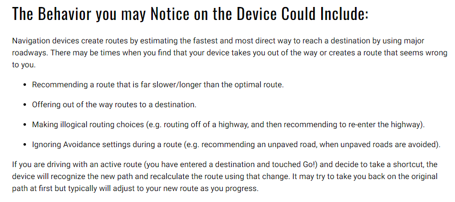

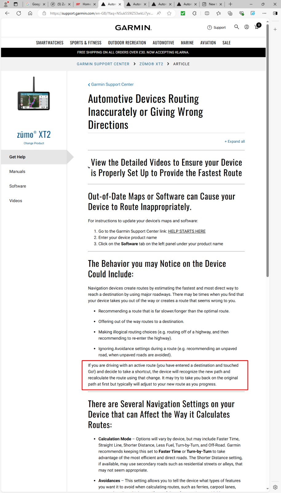

Garmin Support said: “These devices are designed with the assumption the user is following the guidance given and not deviating. In those cases where I ignore the guidance and deviate from my original route, I end the current route and restart it for the optimal guidance. Would you kindly test this and let me know you experience?”
I pointed out that this could not possibly be true since automatic recalculation when going off-route was a specific feature of the zumo.

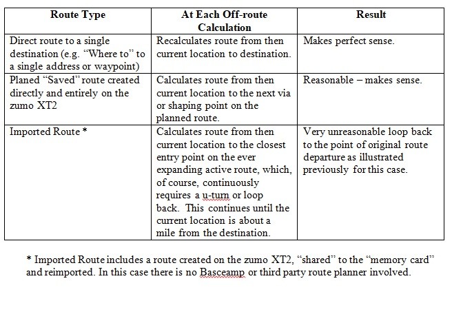

It would appear that the “Strange & Inconsistent Off-Route Behavior” (a.k.a “RUT”, a.k.a “Weird routing behaviour”) on the zumo XT and XT2 is not being fixed because it does not have enough “overall impact on [their] customer base”. In other words, perhaps, they have not heard from enough customers about the issue? (That may be true for other issues as well?)
Should you wish to help Garmin Support “track other customers reporting similar experiences”, their email address is: Product.Support@garmin.com
Should you wish to “share [your] ideas for improvements”, as Garmin requests, you can do so at: garmin.com/ideas

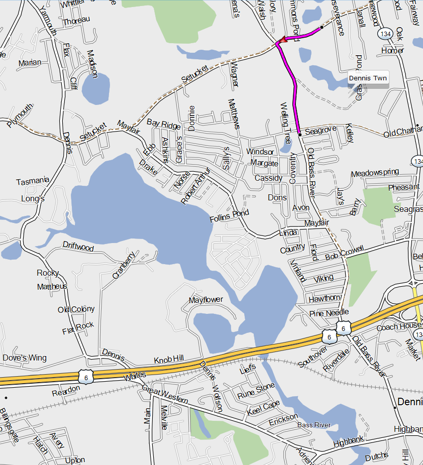

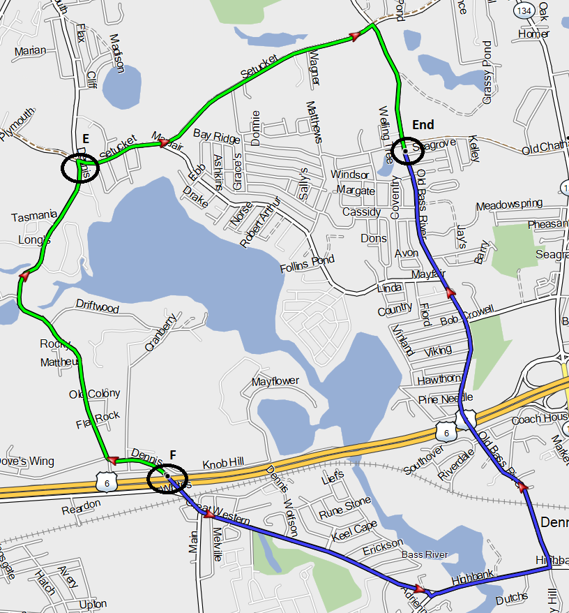

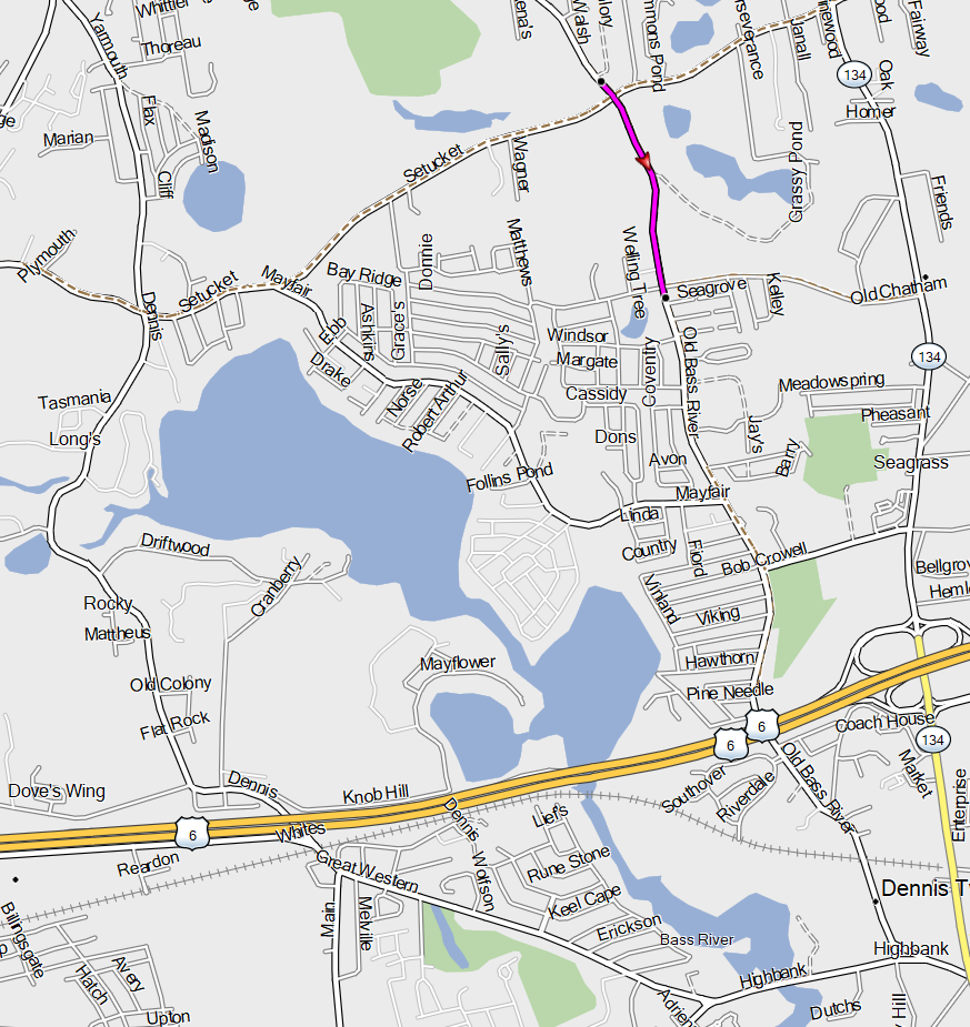

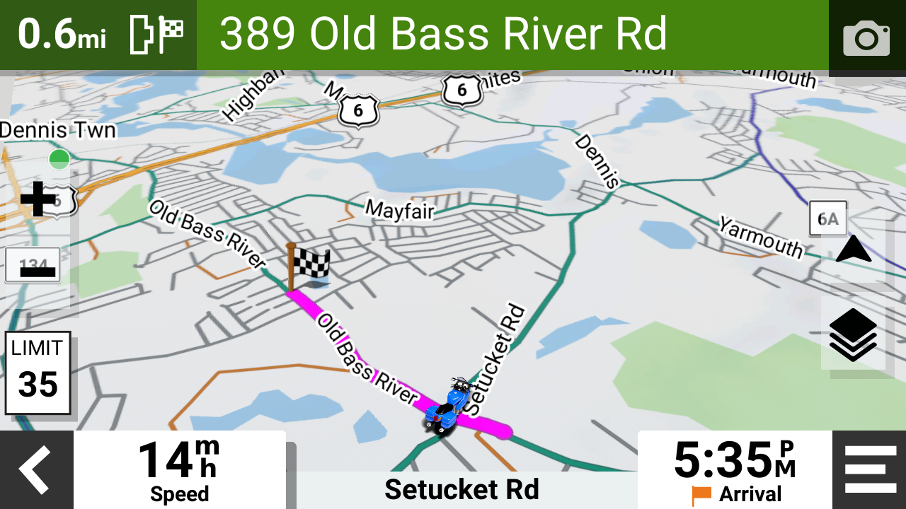

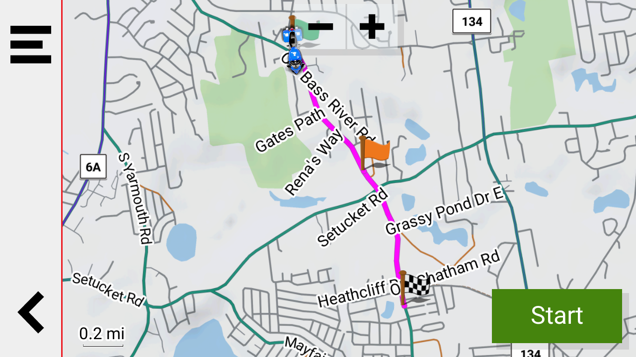

For those wondering how I've demonstrated the issue on the XT and XT2, I'll explain one of my two test routes. My test routes are the result of my own experience and testing as well as the insights provided on this forum by JFHeath and others.
My zumo is configured with automatic off-route recalculation, u-turns allowed and faster routes preferred. I start my routes using Closest Entry Point.
I'm using Basecamp here to illustrate, but an identical route was created on both the XT and XT2, then written to the sd card and imported, so that I had identical saved and imported routes on the device without using Basecamp or anything else.

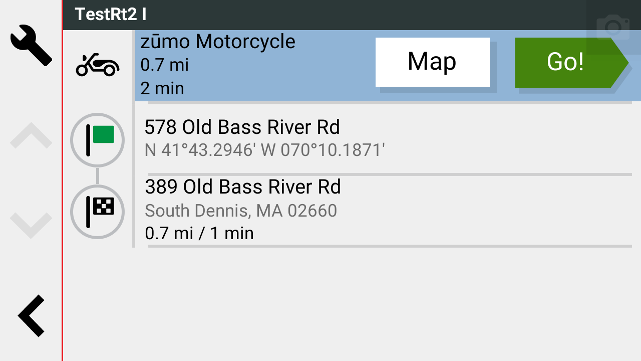

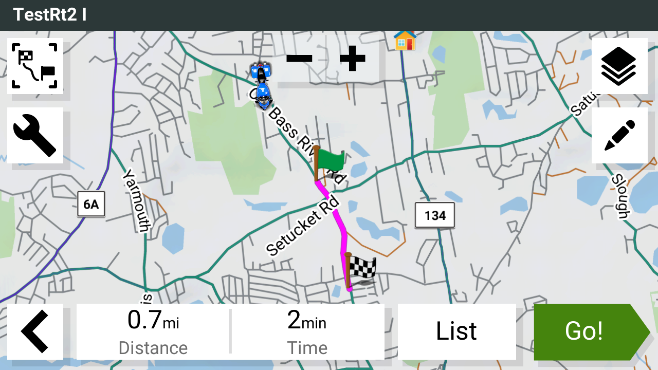

The planned short and simple two point route:

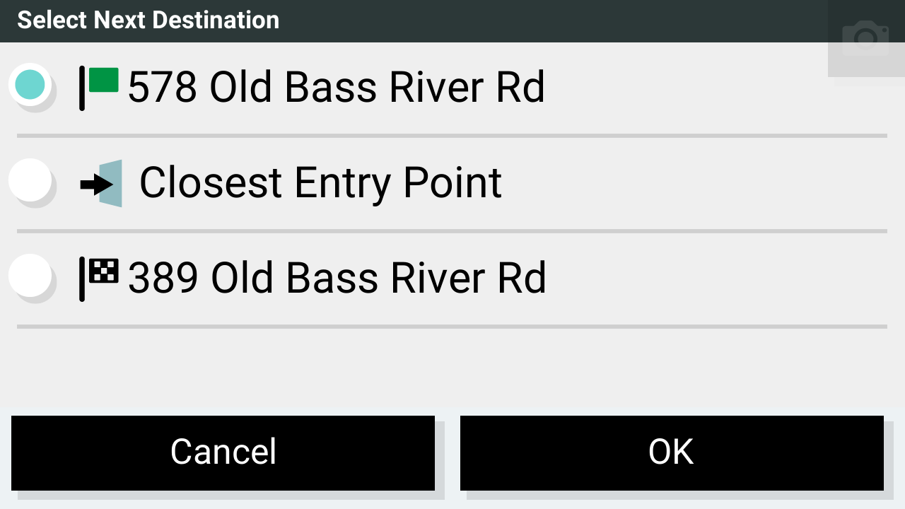

The route just after selecting Closest Entry Point: but I fail to make the left turn, instead continuing straight ahead. The zumo tells me to turn around, which initially is logical.

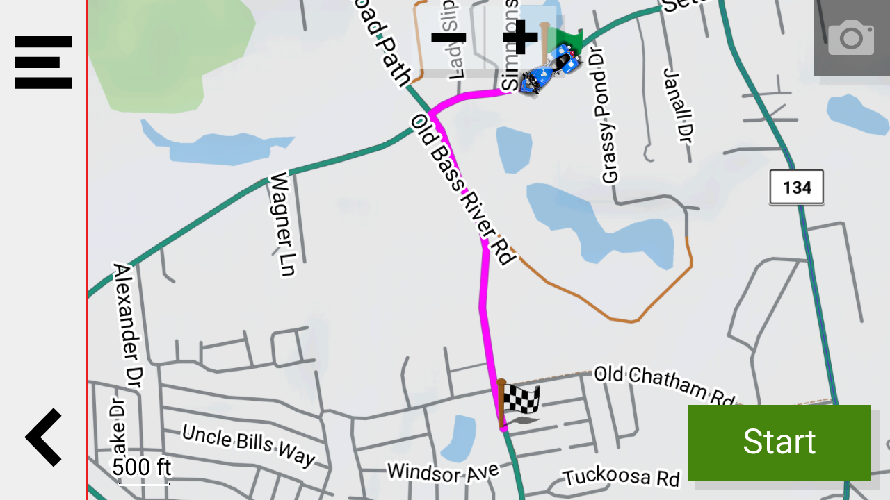

After missing the left turn at point D, I eventually turn left at point E and begin a long loop back toward the original endpoint. Note that until I reach point F, the faster route to the endpoint is to turn around. For both the imported and saved versions of the route, the zumo correctly tell me to do so.
After passing the "Tipping Point" at F, is where the variation comes into play.
Imported Route:
Both the zumo XT and XT2 continue to tell me to turn around until after point G, which is well past the point where it makes more sense to continue ahead: Identical Saved Route:
The routing behavior logically changes at point F. Prior to F, I am told to turn around to follow the faster green route back, but after F I am directed ahead to follow the faster the blue route: You may notice the extension of the imported route at Point E that does not occur for the saved route. Prior to turning left at E, the zumo has extended the route past that point as it directs me to turn around. For an imported route, it seems to continuously extend the route. For a saved route, it seems to recalculated the route as noted in the table above.
Imported Route:

There's one thing that I noticed about your route. Using Closest Entry Point. I tried this a coupe of times - but becasue I don't know exactly what it is doing and I need something that behaved the same way for any route - I adopted a route with a start point that I would definitley travel through and an additional route point that I could skip. The skipped route point was there simply to make the Zumo recalculate the imported route - my belief (still) is that the recalculation makes the route behave like a track that has been converted to a trip - so that it will:
- Go for the closest point back to the original route, rather than find a new way to the next route point.
- Ignore (ie delete) route points from the route if you miss a turn that is heading towards it.
The thing that spring to mind in your test is that you don't know where the selected closest entry point is located. That point could be treated as the start of the route, and if it is just after the left hand bend heading south, then by going straight on at the junction, you will have failed to go its selected start point !
That 'just after the junction' is a tendencey that I have seen on the XT - if you change a Via Point to a shaping point int he trip planner, it tends (ie often but not always) to place the shaping point onto the road that is the faster road between the route points on either side. And it places it just after the junction.
The 'always going back' to the point of deviation behaviour that we have seen with RUT is actually an incorrect statement that I made earlier on.
Indeed that is what it does if U tunrs are allowed. IN fact, it is finding the closest point of its new route, and if it has justa sked for a U turn, then the closest point is the section of route that it has just plotted heading back in the opposite direction.
If you turn off U turns - ie do not allow them - then it is forced to look further ahead to find a 'turn around loop' - eg by using side roads. On my favourite test route, there are very few of these opportunities, and at one point it had to look 7 miles ahead before it found a side road - and that side road led to the original faster route - so it headed for that.
But turning off U turns hides that something is going wrong. On one route I had missed a Via Point (In fact, I hadn't - I'd approached it from the other direction and it didn't recognise that I had passed straight through it) - it was trying to take me 15 miles to a turn round point and then 15 miles back. I have recorded this behaviour. I don't think I mentioned it on here, or to tech support. At the time, they were still trying to reproduce the fault using the XT simulator !!
The XT2 seems to limit the number of U turn requests that it makes before using loop back opportunities. I have yet to confirm it (I have seen it do this just twice). That may be Garmins response to people reporting the RUT behaviour, and someone, somehwere not quite grasping what it means.

Found it.
The same information is provided in all on-line manulals for the Zumo 590, 595, XT and XT2.
https://support.garmin.com/en-GB/?faq=N ... tab=topics
Click the image - I haven't reduced its size. You may need to save it to be able to read the screen shot - but the link above shows the page that I captured. Unless they change it.
It refers to an active route - and then says - if you have selected a destination and tapped Go !. I believe that method does exactly what it describes. But an active route could also be a stored route in trip planner - from a gpx file from elsewhere. So this doesn't actually clinch it, but its the best we have got on how it should behave.
Edited to add another screenshot

@jfheath Thanks for the support page link and the comments. As usual, you bring up good points. You inspired me to do a bit more testing.
After passing through the original planned route start point, I turned right to go off-route. The same RUT behavior occurred.
Side Note: from the above screen shot, it appears that once I passed through the original planned start point, the XT2 dropped the merged part from the active route, keeping just the original planned route as active.
Just after selecting CEP, but before I began to move, the route becomes
The XT2 appears to have selected the intersection ahead as the entry point to the original planned route, calculated a route from my current location to that point, merged the 2 routes together, and dropped the now irrelevant beginning part of the original planned route. The start point of the active route appears to be my current location. This route has only start and end via points (at least as it shows on the map). There are, of course several hidden or ghost points. I would expect one of those to be right at the intersection.
You may recall my theory of how CEP works here: viewtopic.php?p=20792#p20792

OK, so I approached my same two point imported test route by going straight up the road from before the start, selecting the start point rather than CEP. It appears that when I selected the start point as next destination, it calculated a route from my location to the start point and merged the 2 routes, making the combined route the active route.I adopted a route with a start point that I would definitley travel through and an additional route point that I could skip. The skipped route point was there simply to make the Zumo recalculate the imported route - my belief (still) is that the recalculation ...
So going back to the CEP approach, just before selecting a "next destination", the route looks like this.The thing that spring to mind in your test is that you don't know where the selected closest entry point is located. That point could be treated as the start of the route, and if it is just after the left hand bend heading south, then by going straight on at the junction, you will have failed to go its selected start point !
Hopefully some of this is helpful. Your testing efforts are more careful and more complete than mine. You provide results where I offer theories.
