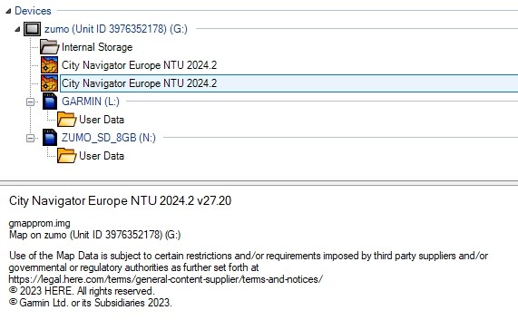

Plug in your Zumo and load Basecamp.
Basecamp should show the installed maps in the left hand pane.
Click on the one that you want to get rid of, and it shows some extra details - like this:
The other map (when I click it displays this info
All of the information that you need for the selected map is there. The filename and the location.
Rather than delete the file immediately, I suggest that you rename the file - eg rename d6210270a.img to d6210270a.imgxxx
That way the Zumo will not recognise it as a map, so you can check to see that it has disappeared from the available maps. If so then delete the file.

Thanks for the information. I don't use Basecamp but do have it only machine. I will see what I can do. I like renaming the files first. Good point.
