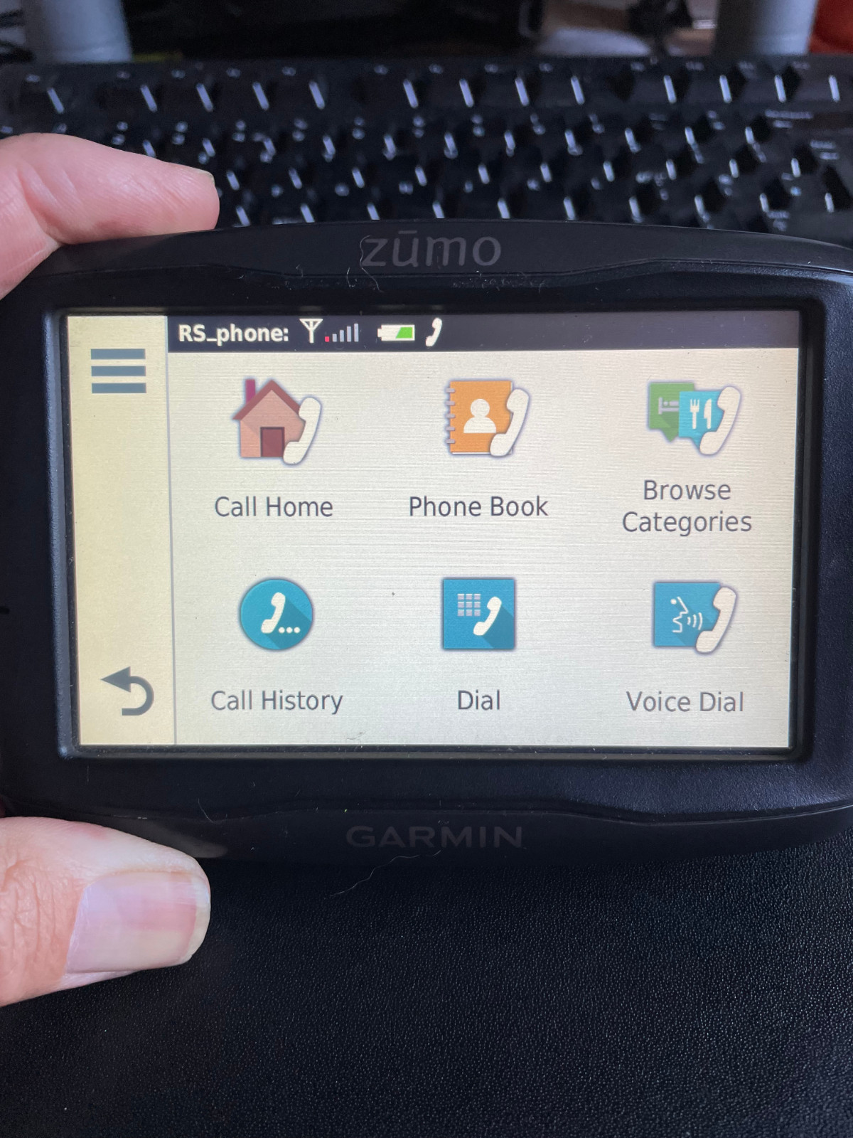

I can initiate calls from my 595 but all further control is routed to the phone. Also the phone "app" panel has gained a voice dial function. This situation persists whether I pair the 595 with a "dumb" headset or with a Packtalk Edge. This was not the case prior to pairing the 595 with the Edge and I wonder if doing so has broken something.
The wrench tool follwed by phone from the naviagtion screen only offers the opportunity to call one of the last four numbers
Pics attached which may explain the situation. Apologies for poor orientation - that wasn't my doing.
"595 phone app" shows the app as it now appears. "595 phone screen" shows how I would expect the active control panel to appear on the navigation screen and "595 nav" what I actually see on the navigation screen.
I'm wondering if a factory reset of the 595 might be beneficial.
