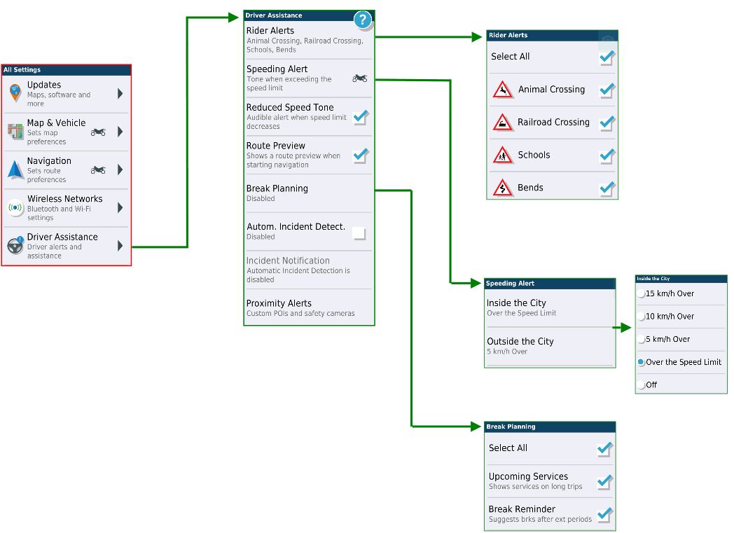

I reckon that it may be one of these. Note the various settings for both inside the city and outside - different amounts of lee-way.
The alternative is that it is relaying pings from your phone and has nothing to do with the XT at all.

I too, have been chasing this double tone alert...without success. JFHeath, my XT (USA model), does not have the secondary selections for Speeding Alert, i.e.,Inside city/Outside city and speed over. Maybe this is Europe only? The unit software is up to date.

That's interesting, so I had a play around with some settings.
Those options disappear from my UK XT if I change the locale to USA. And instead, I get the crash helmet warning option !
Locale is in the hidden menu obtained by long pressing the circular speedo button. Available in Configurations and Settings.
