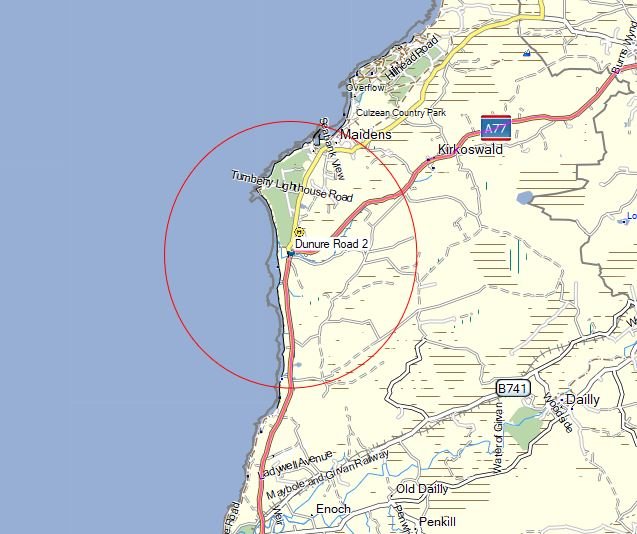

I've been using Basecamp and various Gps's for quite a while now but would like some info on the following queries.
In Basecamp I can specify a "Proximity" value on a waypoint (Denoted by a red ring - see attached jpg) - I assume the theory is if, for instance, I set a value of 1mile diameter and I get within 0.5miles of the waypoint the Gps assumes I have passed through it and won't force me back to it. Has anyone ever got this to work? (I use an XT, but on any Gps?)

Proximity points alert on handheld devices but not automotive ones, where they have no effect other than to provide the circle marking.
As for your other points, not that I'm aware on current devices, earlier devices using Route Planner if I recall correctly did accept start and finish times from BaseCamp.
