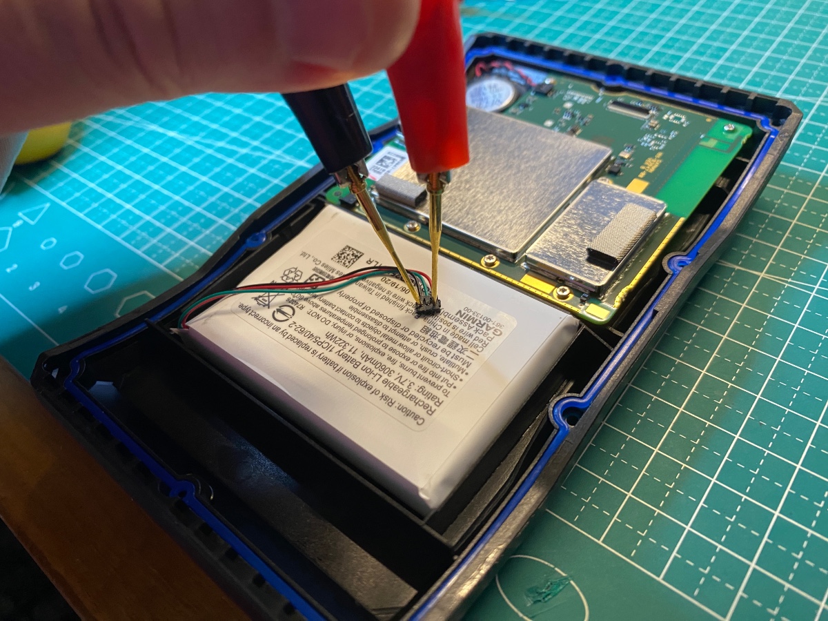

Unfortunately I left my Zumo XT connected to my bike over a long extended period and it must have completely drained the battery. This is how you carry out CPR on your Zumo……
The battery can be recovered if you have a little bit of electronic/ electrical experience.
If the battery has been left drained for a period of time the Zumo XT will not charge the battery no matter how long you leave it plugged into the charger.
You need to remove the screen, there is a video on YouTube showing you how to do this. Be very careful with the LCD screen ribbon connector. After removing the screen disconnect the battery from its terminal. Now you have to have some form of power supply to inject the battery independently to getting it going again. Setup your power supply with 5V and just under 1A current. Connect the power supply to the red and black connections respectively and hold them on for a while. After around 5 mins removethe power supply from the battery and check the voltage at the battery Black and Red terminal connector points. You want to keep going until it reaches 3.7Volts.
After you reach the 3.7V re-assemble the battery and screen then plug in the USB and hopefully the battery will jump back into life and begin to charge.

Re: My xt Does not charge..;
Welcome @johnnysneds , and thank you for your contribution.
So if the battery is absolutely dead, will it charge when the XT is mounted in the bike cradle instead of via the USB socket ?
