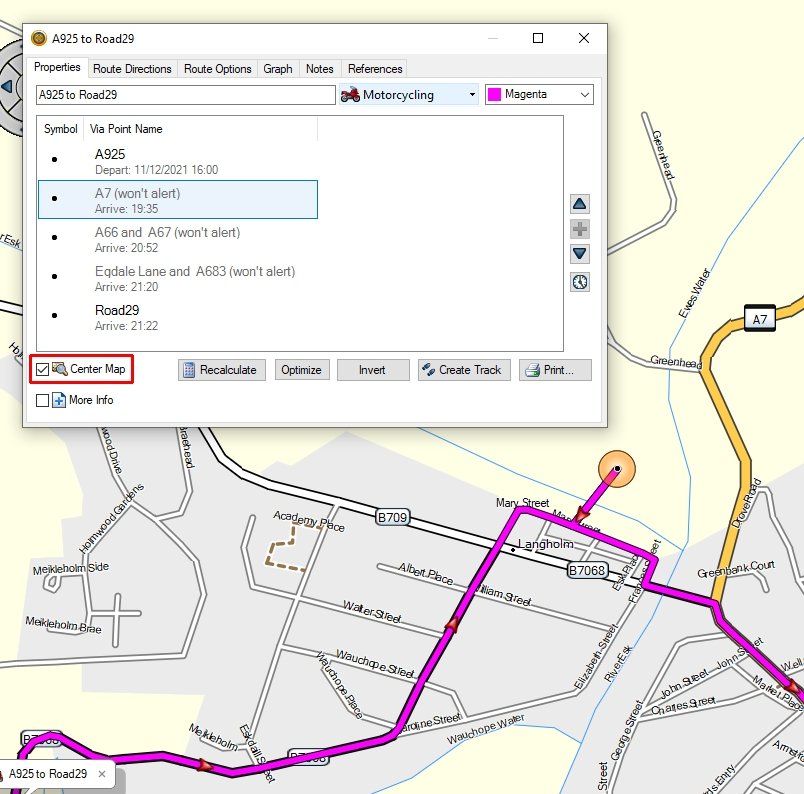

When you place a point using the insert tool (pencil) or the new route tool (3 green squares), you can often get unexpected behaviour.
The point that you place can often jump or snap to a point that is different from the place that you thought you were pointing to. This can be for a number of reasons.
eg -
- there is a 'known' location near to your pointer, and it has assumed that you wanted to select that point.
- The map is not plotted accurately enough. - eg your map is set to Low, Lower or Lowest - when roads are often plotted with straight sections rather than curves.
- You are not zoomed into the area where you are placing the point.
Once you have finished the route, double click on it to get the route properties dialogue box. See below.
Tick the 'Center Map' box (outlined in red in the picture above).
Then click on every point in turn in the list. The column is headed 'Via Point Name' - but it shows all of the points - Via Points and Shaping Points. The map will zoom in and show the point in the centre of the map, surrounded by an orange circle.
If it is incorrectly placed, then move it - right click on it and select Move Route Point (PC instruction).
Then double click the route again to continue.
Check every point that you have placed.
Make this a habit every time that you create a route. It is so easy to place a point on the wrong side of a dual carriageway. The problem is that to create a long route, you need to have a low level of detail map and show much of it on the screen at one. Otherwise the computer runs really slowly as it redraws all of the detail on the map.
But to place the points accurately, you need the map to be in High level of detail and zoomed in as close as you can get.
When I create a route these days, if I haven't already created the points that I need as waypoints, I just place them approximately, and then leave the accurate placing for when I check it later when it is zoomed in and showing a Higher level of detail
