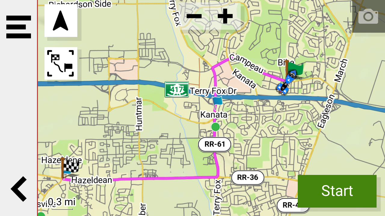

The end point is on Hazeldean just after the turn off of Terry Fox.
So, the entire route is start on Terry Fox just south of Campeau, continue south on Terry Fox to Hazeldean. Then, turn right/west on Hazeldean. I ended shortly after that turn. There is a large parking lot there that I can use to turn around and head home.

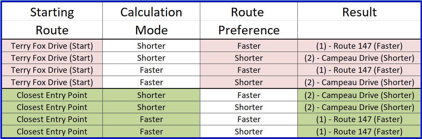

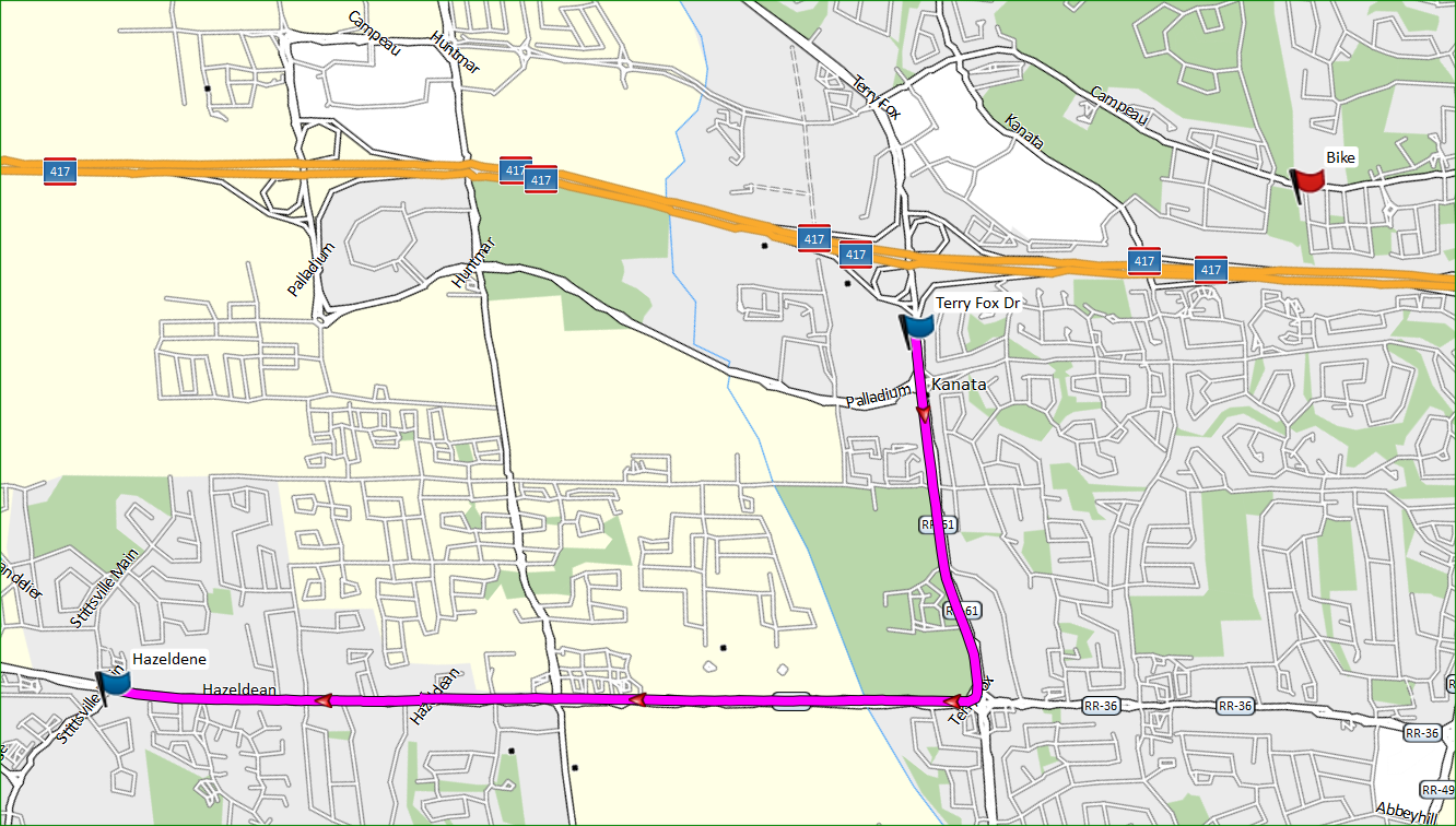

OK - so here is what I have.
I couldn't tell exactly where you placed Terrry Fox Drive - so I put it at the place where Basecamp shows that the route has just divided into two carriageways heading SE. (I've rotated the map 45 degrees to get more of it in the rectangle !!)
I placed the bike roughly where you pointed - about on the stop sign at the junction between Gray Crescent and Campeau Drive. That way the bike is free to turn left or right onto Campeau drive - there is no suggestion to the XT2 that we prefer to be heading left or right on the map.
I got just two results from 8 different tests.
Route 1 - Heading right to pick up the 417.
Route 2 - Heading left along Campeu Drive
The Tests

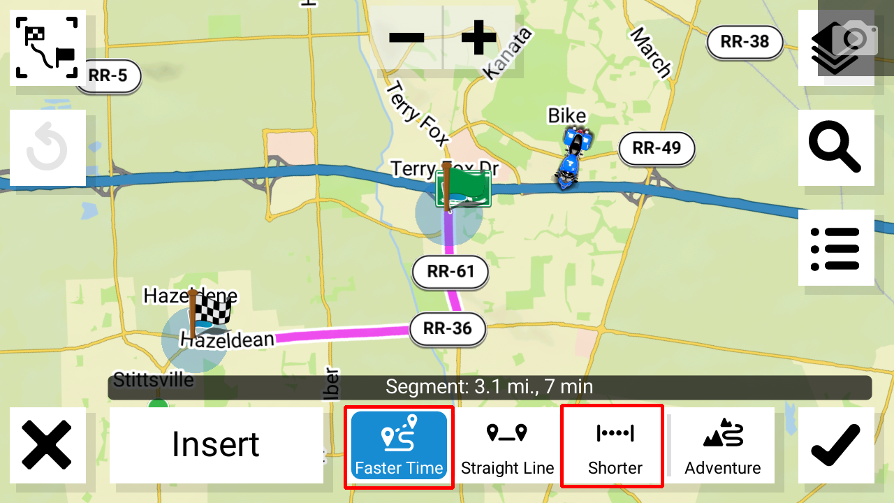

For the route I carried out all 8 combinations of selecting
Calculation Mode: Faster Time or Shorter Distance:
Route Preference : Faster or Shorter.
This is the preference which is attached to the route and usually over-rides the Calculation mode.
Starting Route: Closest Entry Point vs Start Point

The Results
What happens depends on how the route is started.
If you select the start point, then the route to the start is always calculated by the routing preference that is set for the route itself.
If you select Closest Entry Point then that section of the route is controlled by the Calcualtion mode preference set in Settings->Navigation.
Whether Campeau Drive is faster way or a shorter way than to go than Route 147 isn't up to us to decide. The Zumo thinks that Route 147 is faster and Campeau Drive is Shorter. When heading for the next point, if there was a fast road nearby, the XT seemed to head for whichever was faster - getting to the actual point or getting to the fast road that would take it to the point - as if it took no time at all to reach the point once you were on a fast road. I have good indications that this may not be the case with the XT2.

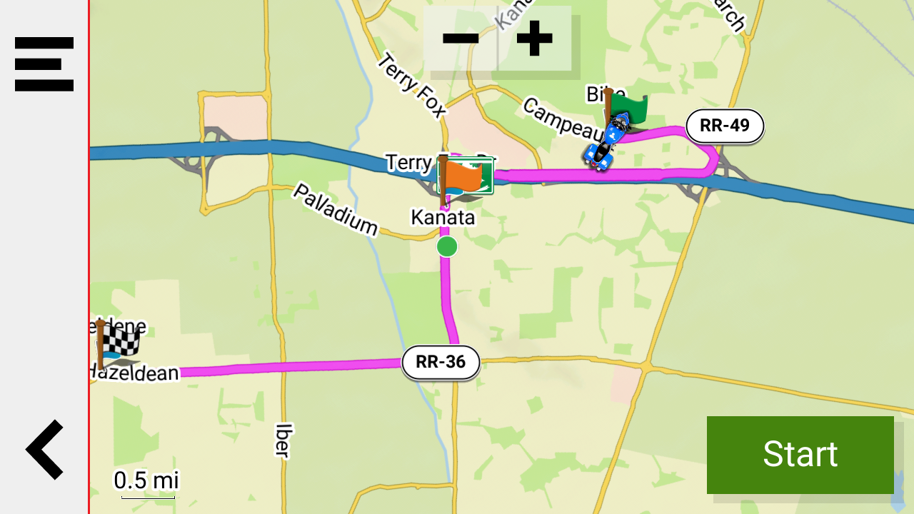

@jfheath Your route is close. It should start on the other side of 417. So, between Campeau and the 417 on Terry Fox. Mine ends sooner than yours on Hazeldean, but that's no matter. You are correct that I am sitting on Gray just off Campeau when I start the XT2 navigating.
I did as you advised. I created the route on the XT2. Two points - the start on Terry Fox just left/south of Campeau (this is north of the 417) and the end on Hazeldean just right/west of Terry Fox. I started it running on Gray near Campeau. This time, it did exactly what it should do. It had me turn left onto Campeau from Gray and follow that to Terry Fox. Then another left on Terry Fox. It announced the start point on Terry Fox, then a few metres later, told me to continue to Hazeldean, where it told me to turn right.
So, clearly, there is something in the route created by BC that differs from the seemingly same route created on the Zumo. Since I have no intention of trying to create routes on the XT2 small screen, I need to determine how to best have BC talk to it. I'm going to create this last route on BC again, but have the start point on Campeau some metres from the turn from Gray.

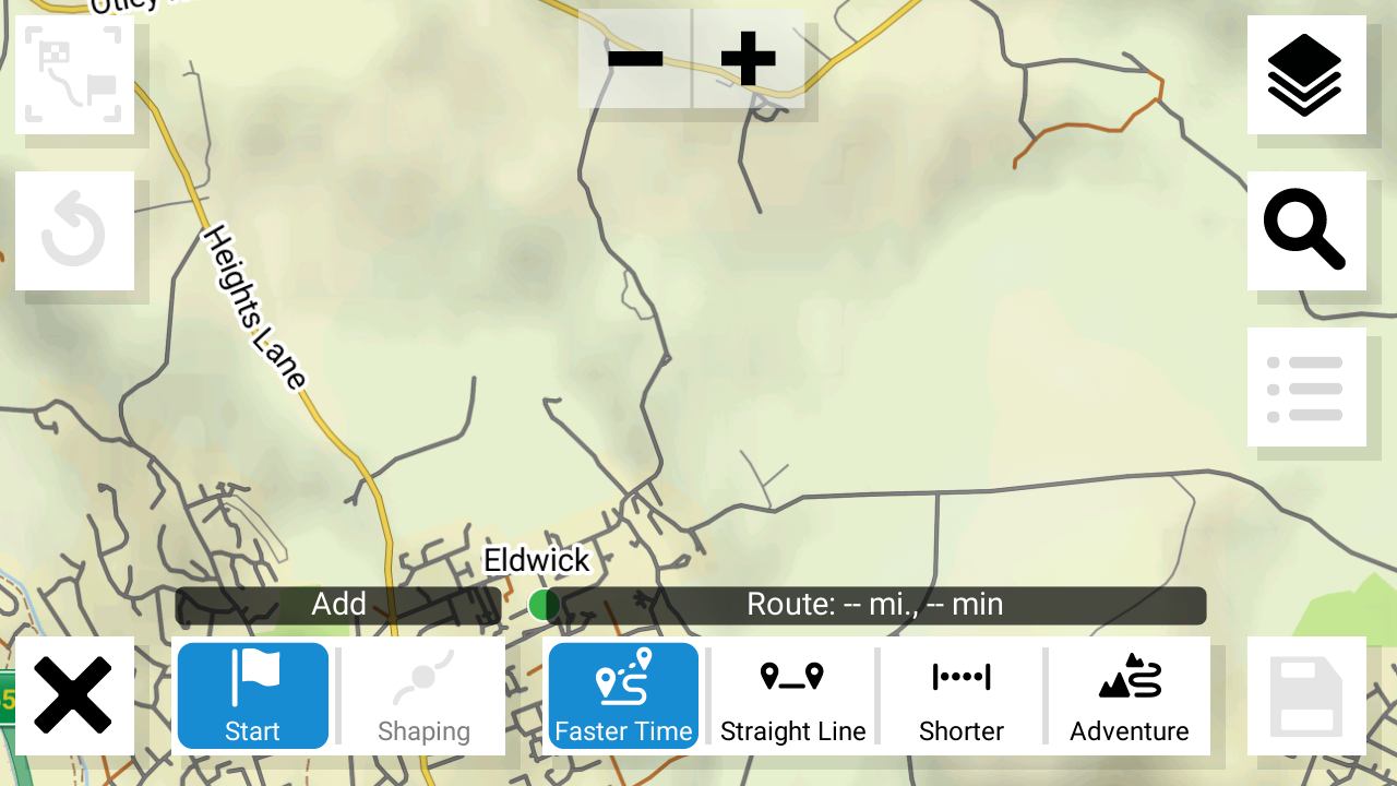

To build the route on the XT2 exactly - create your route points as Waypoints in Basecamp. Transfer those to the Zumo.
Build the route using the Waypoints. I jotted this down in a post last night or early this morning - but I was on my ipad and working from memory. I'll do it with XT2 in hand.
Assuming you have your waypoints in the XT2;
Apps Icon -> Route Planner. You get the map that looks like this
The start button should be selected, and the route pref - FAster Time.
Tap the magnifying glass
Select Waypoints
Choose your waypoint from the list - you may need to navigate collections to find it.
Select 'Select'
A Flag will appear on the map where your waypoint has been placed.
The Start button has changed to stop. Make sure it is selected. Tap the magnifying glass
Waypoints-> Choose the waypoint->Select
A straight dotted magenta line appears briefly on the screen, and it then changes to a route.
Click the black disc icon, bottom right.
Give your route a name.
Done
Select Go - or back out of it and find your route in Apps->Route
