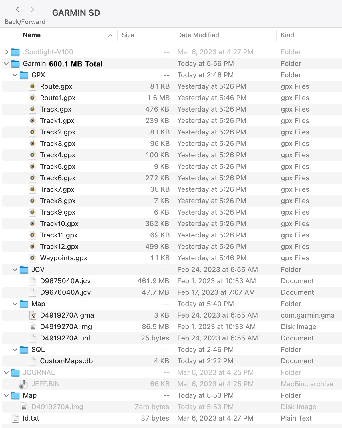

Well...... Been trying to get the 595LM to mount. No luck. I tried different cords, ports. I removed my SD card to see if that would make a difference. After I did that, I received the following pop up (below). I'm glad I copied it because I couldn't get that pop up again after several more tries of getting it to mount. I was very careful not to remove anything important. I do have everything that was on the Garmin Drive backed up but, I can't even load that to try due to it ejecting itself within 15 seconds or so. Currently at a loss.... Just when things were looking up. 🤬

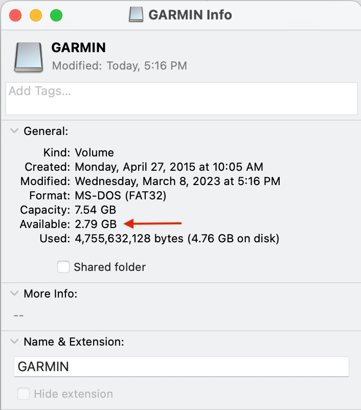

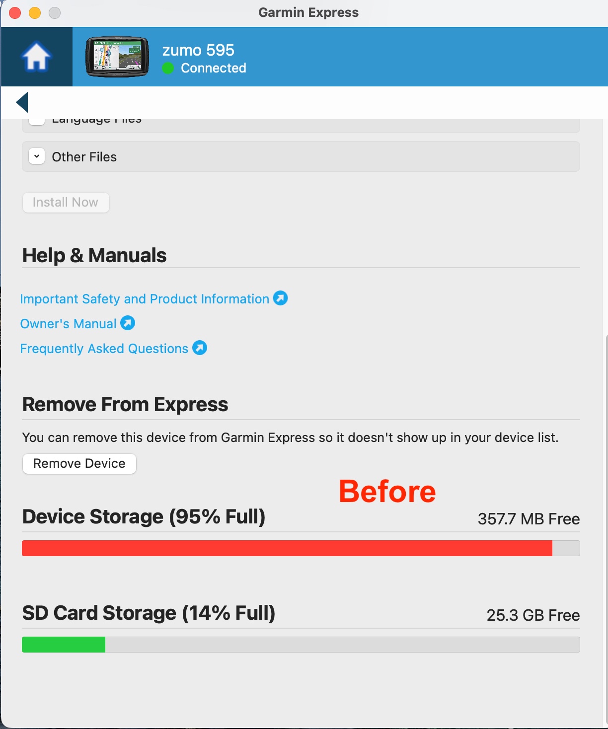

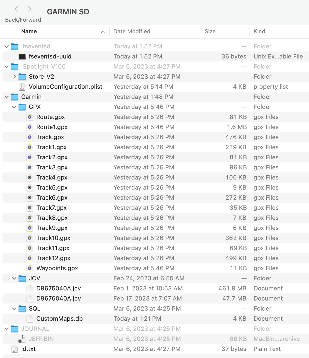

FINALLY!! After trying a million and one things, I finally got it to stay mounted. Luckily, I was able to do so through Garmin Express with a backup from March 6th. I had to try it several times within approx. 15 seconds due to the drive ejecting itself. I got lucky and got the backup completed before it was going to eject itself. Wheeeew....... :roll: I moved the entire Map folder into the SD Card Garmin folder. In addition, I deleted all of the .gma and .unl files except the ones that went with one .img file. I now have 2.79GB free space available!! That's HUGE compared to only having 357.7MB Free before. :o :shock:
You two are more than Awesome!!! There's no way in hell, I could have done this without you!!! I Sincerely Appreciate your time, knowledge and patience in helping me out!!! You're truly an Awesome asset to this forums community.
THANK YOU!!!!! 🤗

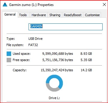

My 595 has 16Gb memory, not just 8Gb. It looks like they may have updated it at some point due to the problems that it was causing.
(nb this is a genuine 595, not a 590 running 595 software - the battery connection broke on that model and my 'repairs' failed).
So in future, for 595 users, its worth asking the question - as clearly there are two different variants.
Zumo 595 Memory.jpg (26.25 KiB) Viewed 7551 times

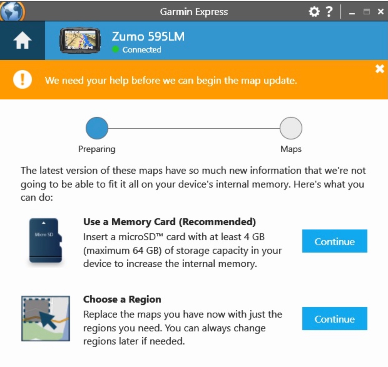

Heres the kicker to all of this and why I'm so upset with the Garmin Zumo 595LM. I had the original Garmin 276c (before the 276cx) gps that I purchased back in January of 2005. I used it until I purchased my 595LM 12 years later. The 276c was flawless until the internal battery went out (which can be replaced). I used that GPS for many, many cross country trips along with hundred's of routes with unlimited waypoints. Of course, I was on a Windows PC's back then using Mapsource which I.M.O. was waaaay better than BC for Mac. BC, GE along with Garmin GPS's play very well with Windows due to being Intel based. Mac user's suffer with BC due to all the stuttering movement of their maps while route planning. Connecting to a Mac is a nightmare as you know from the other post I made. One work around I came across somewhere lately is if you switch from 2D to 3D, the maps act as they should without stuttering. On top of all this, which really has me upset is that Garmin Express for Windows has had the choice since August of 2020 to place Garmin Maps on their internal SD Card. Why, simply due to the same problem that we have been working on here, no internal space (see forum & Pic below). I.M.O and experience, Garmin truly has a long way to go on these GPS's tech, build and support and even longer for Mac user's. I can't speak for the latest one's after the Zumo 595LM, just the one's I have paid good money for. I'll quit whining now..... LOL. Thanks again for all your help!! I do sincerely appreciate it. Ray 👍😊
Internal or SD Card Use:
https://www.advrider.com/f/threads/garm ... s.1461984/
GE Windows.jpg (222.48 KiB) Viewed 7536 times
