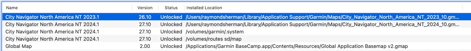

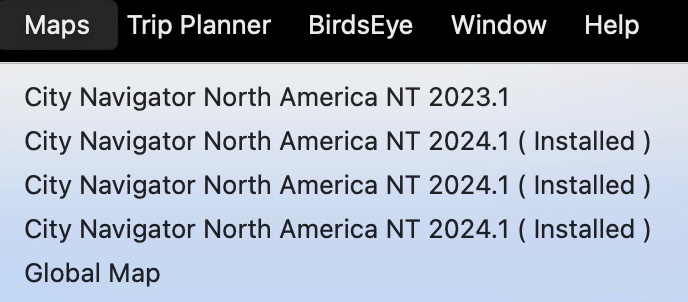

Hi, My Garmin Zumo 595LM is showing my device storage as full at 95%. After seeing this, I performed a Garmin Express update to version 4.60. Biggest problem I see is that the same map is downloaded three times under Basecamp Maps (see below). Plus, there is an older version there as well. I'm sure this is why I'm using up all the internal storage. I have never had this problem. Also, I always use a 32gb SD card for all my routing. If you know how I can get rid of these duplicates as well as the older version, I would sincerely appreciate your help? Thank you. Ray

If you load Basecamp with your Xt connected and wait for it to finish reading everything then click on internal storeage, it will list all of the maps that it can find.
It will probably duplicate what you already know. However, if you click on each named map it will give you the name of the file for that map. This will be useful if you decide to delete one.
You can delete files using a file explorer reading the Zumo's internal storage folders. However I suggest that you dont delete them but instead, rename them as something else. Add your initials at the end for example so that the can be easily put back to their original names later. After renaming, restart the zumo and see if any damage has been done.
However, note that some maps now come in multiple files - so for example, Europe currently has three sections. Sometimes it shows the 3 references to it, sometimes it gives the single name for the entire region. Dont assume that because it seems to suggest that you have 3 maps with the same name that they are duplicates.

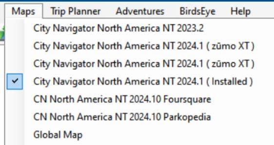

Windows "File Explorer" = MacBook "Finder"
City Navigator North America NT maps is in two files on my XT but installed to my PC as one file. The result is that it gets listed three times in Basecamp when the XT is connected. I keep one old version of the map on my PC so that gets listed as well so mine looks just like yours except that mine shows the device name on the two that are on the XT.
This is what mine looks like.
Edit: I am back because I realized that I failed to finish my thought that It does not appear that you have a duplicate map installed. The map has just gotten so large that it requires two files.

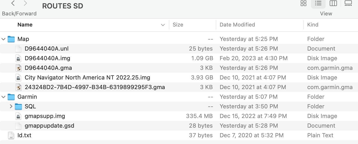

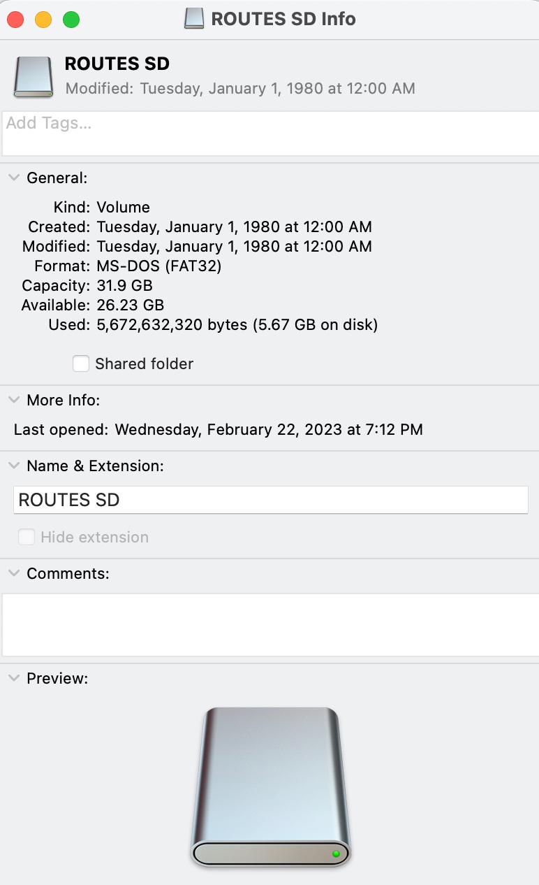

Thank you for the great information. I would agree that there is probably more information therefore, the mapping is broke up into different files. I went into both the Garmin Zumo 595LM internal 8GB folder and my 32GB SD Card Folder (below). As you can see in the Garmin folder, there isn't even a GB of information showing. None of those folders represent all the maps that are installed on the Garmin which is eating up all the space. As for the SD card, there is an older version of City Navigator North America NT 2022.25 at 3.93GB. I now have City Navigator North America NT2024.1 on both the Zumo and in Basecamp that I did through Garmin Express. This could be a hiccup in moving forward without the newer one in place.... I have no idea how download the newer version to my SD card. Obviously, there is a way... If I remember correctly, I did it through Garmin Express back then but, now there isn't an option to send it to an SD card. I've have to reduce the that internal storage somehow??? I can't even open a small route with a few waypoints without it hanging at about 40%. A perfect world would be moving the maps to my SD card and having alias's in the Garmin internal if needed. Thanks again for all your help.... Mr. oblivious here sincerely appreciates it. Ray

Difficult to know exactly what has happened but the older map doesn't seem to have been put there by Express as there is no unlock code etc there. You can remove it simply by deleting it.
Maps on the device are in a hidden .system folder, which is why you can't see them. If you want to see it, and it's hidden for a reason in that mistakes there can be fatal, try googling 'show hidden garmin .system folder'.
