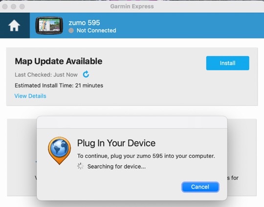

I've had my Zumo 595LM since it came out and been using Garmin Express & Basecamp. Now, neither one is recognized on my new Apple MacBook Pro M1 Max OS Monterey.
I'm up to date in Monterey version 12.3, Garmin Express version 7.11.1.0 and Basecamp version 4.8.12 (4.8.12) The 595LM has software version 4.60
When plugged into any of my MacBook Pro USB-C ports, the 595LM only turns on and charges. Everything worked on my late 2016 MacBook Pro for over 5 years. Yes, I'm using the same oem Garmin cable and have tried many others.

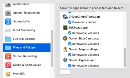

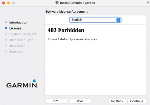

Since it doesn't show as a volume, I checked my Security & Privacy Settings in System Preferences and all items for Garmin we're checked (see below). In addition, I re-downloaded Garmin Express. During the installation steps under License it showed a 403 Forbidden error for English (see below). Never saw that before. English is my choice of language.

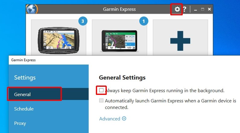

Make sure that Express is not running - even in the background. Make sure - load it up and select the option not to run in the background when it is closed down. This is in the gear menu on a Pc.

For Express, just click on continue and it install further. Works perfect after that.

Thank you Vespamarc for your help. I did select save and continued with the installation process for Express. It installed without any problems but, still doesn't recognize my Zumo 595LM. In regards to USB A, I've been using the oem Garmin data cable along with many other same type data transfer cables without any issues by using a USB A female to USB-C male patch cable since 2016 on my previous MacBook Pro. Now, with this new MacBok Pro M1 Max it's not being recognized. I've tried several different cables but, the issue remains. Other users are having the same issue (link below). Thanks agains again, I sincerely appreciate your help. Ray

I don't know about the Mac version, but on the PC Version it is set from the gear icon. Click the Pic for a better image.
Every time a new version of Express comes out, it puts the tick back again, I have to remember to not allow it to run in the background.

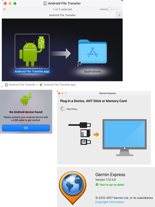

I'm a newbie and just had this problem with my Mac so try this:
Download a copy of Android File Transfer https://dl.google.com/dl/androidjumper/ ... ansfer.dmg
1. Turn on Zumo and connect it to your Mac.
2. Open Android File Transfer (AFT).
3. Once AFT opens and lists your files files, I open Express. It may take a minute for Android to open or show the folders so be a little patient.
4. Express should say in order to continue, AFT must be closed - click ok to accept.
5. Voila! It connects and I tested several times.

Sorry for the delay..... Thank you for your help. I found it running in my upper Mac tab and un-checked it. I tried to connect the Garmin in both situations checked / un-checked but, no luck. I just did another Garmin Express update version 7.12.3.0 which didn't resolve my problem as well. Thanks again, appreciate the help.jfheath wrote: ↑Mon Mar 21, 2022 7:38 pmI don't know about the Mac version, but on the PC Version it is set from the gear icon. Click the Pic for a better image.

Sorry for the delay..... Thank you for your help. I tried it, but it didn't recognize the Zumo as shown in the pic's below. I also did another Garmin Express update 7.12.3.0 No Luck........... Thanks again for your help.Bluenoser2 wrote: ↑Wed Apr 06, 2022 5:29 pm Hi There:

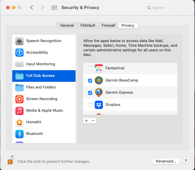

Does Garmin Express and BC have "Full Disk Access"? See screenshot. Was your Zumo on or off when you connected it?![Image]()
