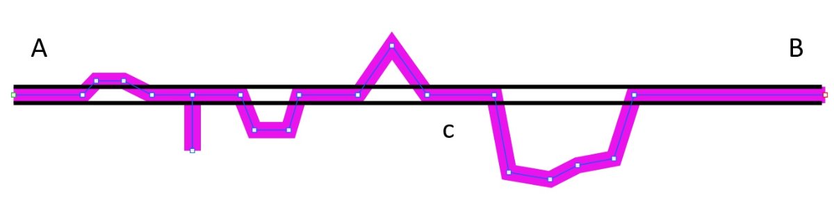

You may find it useful to observe what happens on a short test route.
Plan a short route near home from point A to point B - which is along a main road, but which takes short detours and then returns to the main road.
Something like this:
- Test Route Diagram.jpg (22.36 KiB) Viewed 5594 times
The magenta line shows the test route. The black straight line shows the main road.
Make one of the detours stay very close to the main road - like a lay-by - just so that you can see the detour and the main road on the same screen.
Make another one be a short detour up a side street, and returning by the same route.
Make sure that you have route points to force the navigation back onto the main road after each detour.
Make some of the detours have more than one route point - eg the last one on my diagram has 4, and make some of them Waypoints/Via Points (created with the flag tool in Basecamp/Mapsource and some of them shaping points.
Don't worry where they are, or what the ride is like - you are going to completely ignore where the satnav tells you to go and ride along the main road !!

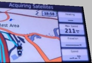

It might be useful to set up the 660 so that it displays the data view on the right hand side. Sorry, I can't remember how to do this on the 660, and the manual doesn't mention it. But you should be able to show Distance to End and Distance to Vias. Once you have the display on the right of the screen, you can touch any of the four data items and choose what data is displayed in it. Not important, but it might help, or you might want to leave that until alter.
