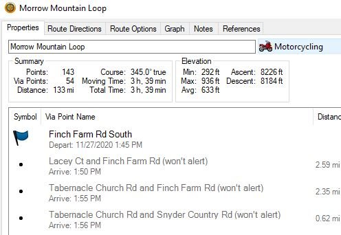

Strange because that's not my experience but if it were I would find it frustrating too. You do know you can set viapoints in BaseCamp to shaping points? If not either individually by opening route properties, right clicking the relevant point and selecting do not alert, or you can select a number of them to change all at once.

Using BaseCamp, have you 'opened' the route to make sure the waypoint was inserted into the route?

I've used both MapSource and BaseCamp for routing - still do use MS for my 450/550. Never experienced the problem you are describing with BC. If you double click on the route in BaseCamp you should open the route properties box. When you look at the points, the Way Points should be easily seen as flags or other symbols, not just "dots" as the shaping points are usually marked.

yes i'm reasonably adept at route planning - in spite of appearances :D - all waypoints show up in the route as do shaping points. I've been using routes for years so am fairly familiar with how they work - I don't claim to be an expert.
As I say, my problem isn't planning a route, it's getting my 395 to follow it. If you use it for simple find and direct to a location it works, if you add waypoints to that it struggles to locate them.
