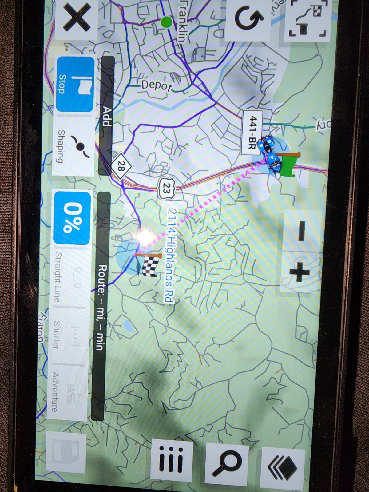

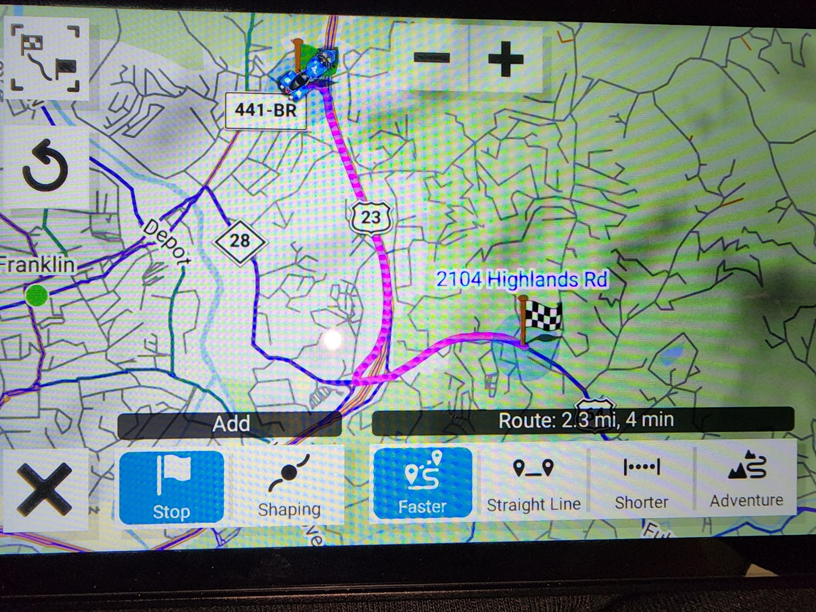

Well, my update, I packed it up and sent it back yesterday, and keeping my xt..
I thought 62 points would be the issue... Wow was I so wrong... Tread, and calculating... Heck I don't think tread changed any of my routes... But it broke calculations... The simplest.. Say route manner in the xt2, touch 2 close spots... Say 2 block away.. When it works, perfect... When it didn't like something I import with tread before, the same 2 points would sit at 0, and could not calculate..
I had a simple route, 2 shaping points, 1 stop, and 1 final... The XT2 would not start the route, I had to use the xt...
Tread, and something it does completely stops calculations..
Not having tread, and loosing wireless access to send stuff was a no go for me... The card is a pita vs drive in the xt.. Don't usually have my laptop on trips, so that's out...
Overall, if it would have been similar to the xt but improved, I might have kept it.. I got it on sale for $500.... Since it wouldn't calculate for me... I returned it... Still within my free return window... Spent days loading some of my routes, one at a time till it capped out... Then reset, and start over.. Cable, card, wireless with tread... It was crazy the time I spent going in circles with my xt looking patiently at me, saying I still work🙂 lol... (plus that's new too, Garmin exchange march or April this year)
Wanted to like it, and the features, like improved radar and radar in motion, I would have paid the 550$ for, probably... But I have hundreds and hundreds of routes, recorded tracks and the rest I couldn't start from scratch building again..
I'll see what the next xt brings, or keep an eye on some of the newer options... My catch is I like the xt cradle type, click on and off, without having to mess with the ram arms... Gps is always in the same location after switching bikes..
When working, takes like milliseconds... As expected..
When broke, it will sit like this for 10 minutes and do nothing.. (sorry it's upside down,)
