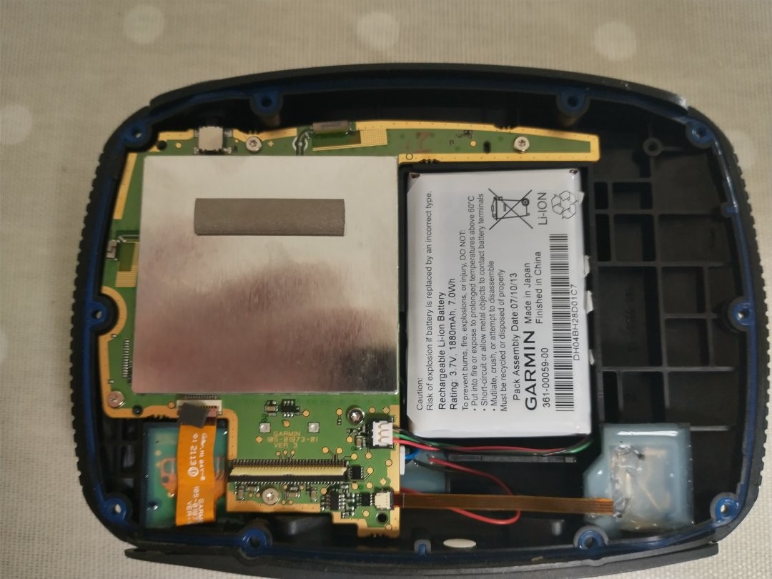

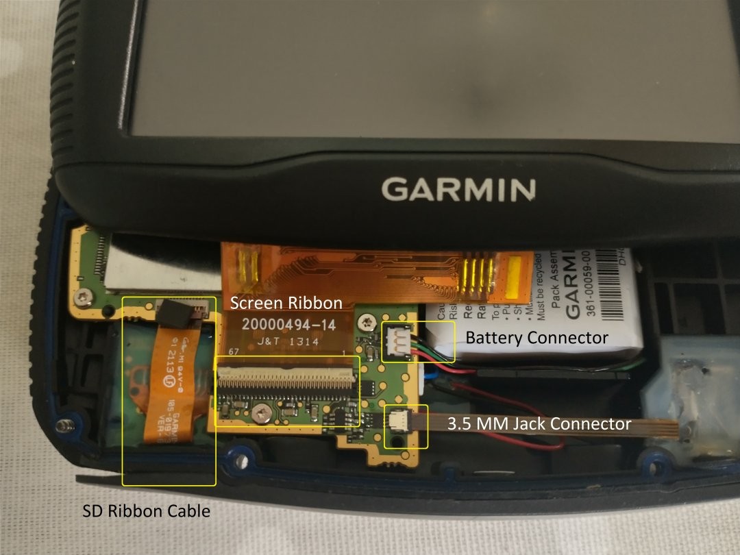

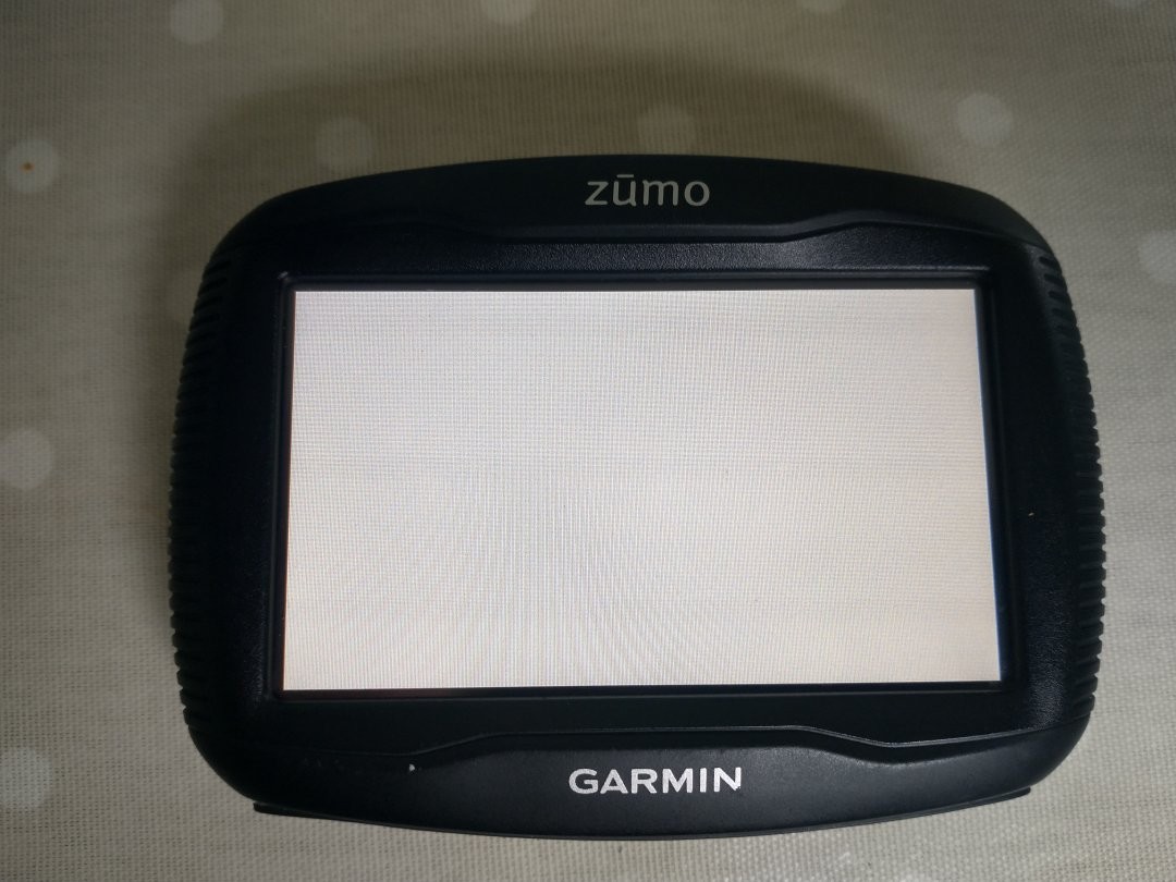

I have a little 340lm and a 390lm here is a how to replace screen which would also be useful if you wanted to change the battery.
I have two of the little Garmin 3XX series Satnav's (a 340LM and 390LM) that I use on my old R1150GS. The 390LM gets the bulk of the use and has been fine for many years I inherited it in 2016 as it came with a 2014 Kawasaki 1000SX that I bought. I bought the 340LM as a backup. Anyhow about a year ago it stopped reading the micro SD card in the unit and I was out last Friday around the Glens of Antrim and it did this.
Just a plain white screen.
Anyhow when I got it home I connected the unit to the computer and it was recognised by Garmin Express and Basecamp and continued to log the route I'd taken. So I thought I'd open it up. When I did I found that the ribbon cable to the Micro SD card slot had become dislodged so I put it back in its socket and inserted an SD card and connected the unit to the computer again and low and behold the SD card slot was working again. So do I have a go at replacing the screen? They are available for £25 delivered from Ebay so I thought that I'd give it a shot. The new screen arrived and I opened up the unit again. A T5 torx bit is required and there are 10 screws securing the rear of the unit.
The SD ribbon cable had previously been put back in its socket only the screen ribbon holds the front of the unit to the rear of the unit when the case screws have been removed. (to change the battery I doubt you'd have to remove the ribbon cable from the screen, as you could just fold the screen half of the case out to gain access to the battery and its connector..)
Be careful when removing the white ribbon cable security tab it can become dislodged and is fragile and brittle.
Front of the unit the display is retained using 8 T5 torx screws.
Checking that the two screens match.
As they say reassembly is the reverse of disassembly again be careful with the display ribbon securing tab as it is fragile.
Moment of truth was it just the screen??
390LM on the Left and 340LM on the right. Proof of the pudding will be it wobbling about on the Migsel Mount on the R1150GS........which does have a particularly wobbly cockpit
