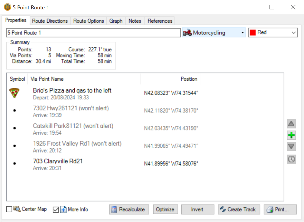

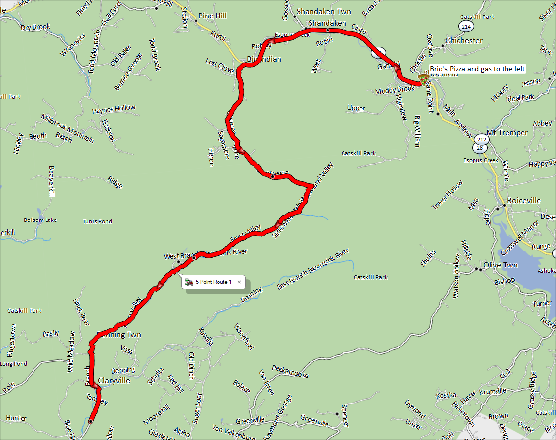

Double Route Line on Importing BC GPX route
Ok that's enough for tonight.
Summary - I have a 5 point route showing just the 4 route points after the Brio Pizza Waypoint. It shows simialr symptoms.
From Basecamp
5 Point Route BC Screenshot.png (532.85 KiB) Viewed 2910 times
5 Point Route List BC.png (197.3 KiB) Viewed 2910 times

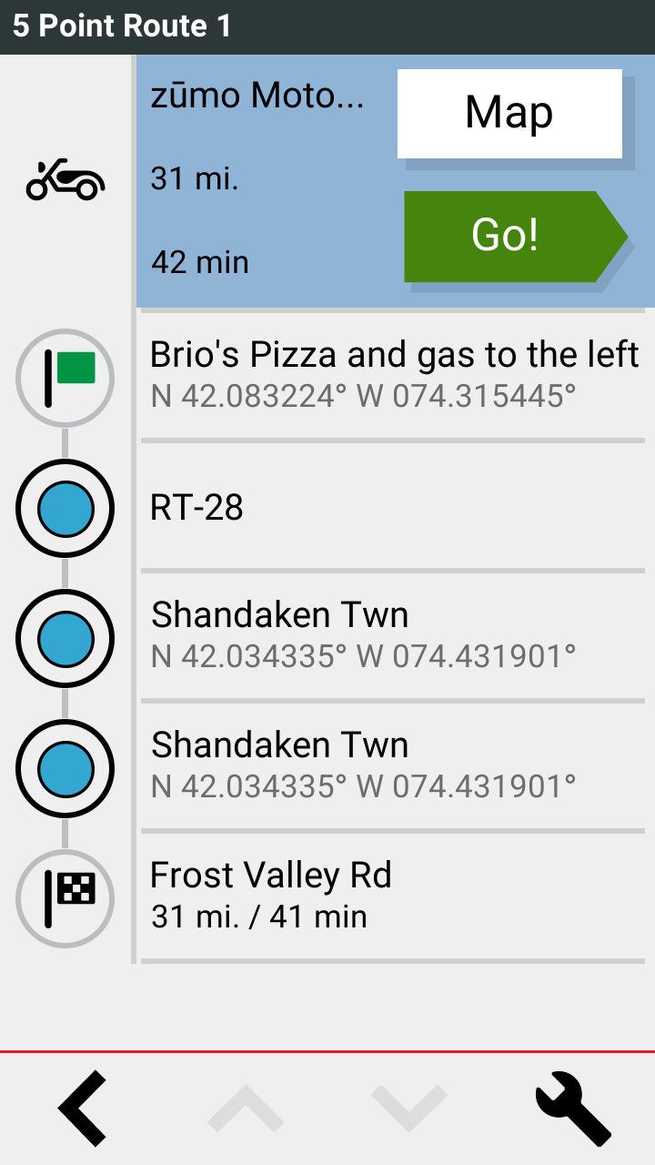

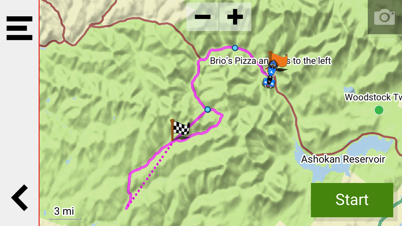

From the XT Screen
5 Point Route XT2 Map.png (1.15 MiB) Viewed 2910 times
5 Point Route XT2 List.png (122.66 KiB) Viewed 2910 times

<rtept lat="42.083224" lon="-74.315446"><name>Brio&apos;s Pizza and gas to the left</name>
<rtept lat="42.118192" lon="-74.381712"><name>RT-28</name>
<rtept lat="42.034336" lon="-74.431902"><name>Shandaken Twn</name>
<rtept lat="41.990648" lon="-74.494708"><name>Frost Valley Rd</name>
Conclusion
Look at the lat/long coordinates. The route on the Zumo has taken the first 3 points OK, then it has repeated the third point and then added the fourth point. It clearly knew how many points there were - 5 - and it has stopped creating the route points after its 5th - actually missing off the actual end point.
This has all the appearance of a programming error. Goodness knows what cause it to repeat point 3, but whatever it is, it could happen again. I wonder if there is an odd character in the tags following that particular route point that has caused a particular section of the program to abort unexpectedly, and as a result it has skipped the command to increment the route point counter.

In the XT2 verison of the route it is the first part of the rtept that is wrong. The 4th route point has got the location and name and sublcass for the third route point. All of the ghost points are declared correctly.
So we have rtept for section 1 Brios Pizza
Ghost points for section 1 after Brios Pizza
rtept for section2 from Rt28
Ghost points for section 2 after RT28
RtePt for section 3 from Shandaken Twn
Ghost points for section 3 after Shandaken Town
RtePoint for section 3 Shandaken town (Wrong, itshould be frost valley road)
Ghost Points for Section 4 from Frost Valley Road
Rte Point for Section 4 Frost Valley Road. (wrong, it should be Claryville Road)
End of Route

First, the route in the XT appeared fine however there were numerous duplicately named route points. I think there were three "RT-28" and two "Shandekan Twn". The number of Via and Shaping points shown on the XT map corresponded to the number of points in the routes list so I don't think they were duplicate points. I did not look at coordinates and have since cleaned after testing so can't easily check it. @jfheath, would this be an instance of renamed route points by the XT, an issue that you have mentioned often but I have rarely experienced?
Second, the first response by @jfheath contains an image of the Basecamp route points list. I see names like "7302 Hwy281121", "Catskill Park81121", and "703 Claryville Rd21". Typically, numbers suffixed to the street address indicate the sequential number of the occurrence of that address as a route point in Basecamp. I can't imagine that there are 1121 route points in Basecamp with the name "7302 Hwy28" so is there an explanation for these numerical suffixes?

I moved points 3 and 4 of the 5 point route slightly. Then transferred to the XT2.
The route list now had the correct points in the correct order. None missing.
But the map still showed the same sort of shape with the extra stright line limb. But the two shaping points that I moved slightly were now almost on top of each other.
Shaping point have adopted a fuzzy logic - the jump to a recognised point that is near the location but on the faster route between adjacent points. It is behaving as though that date is skewed. But again - recalculating on the XT sorts it out. But you lose your original BAsecamp route.
