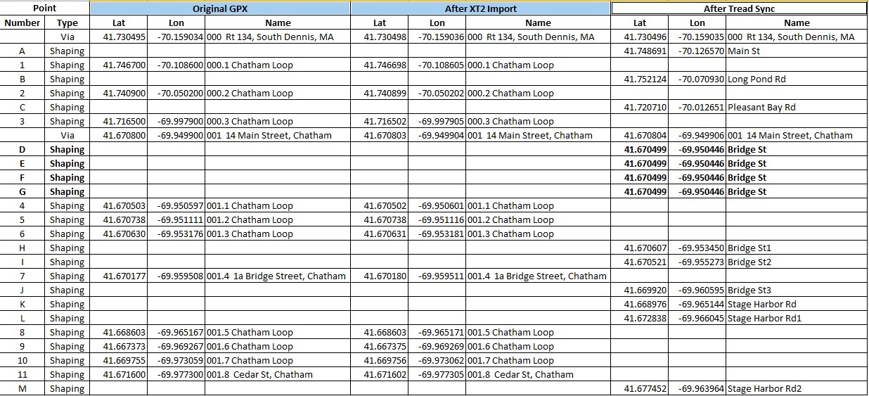

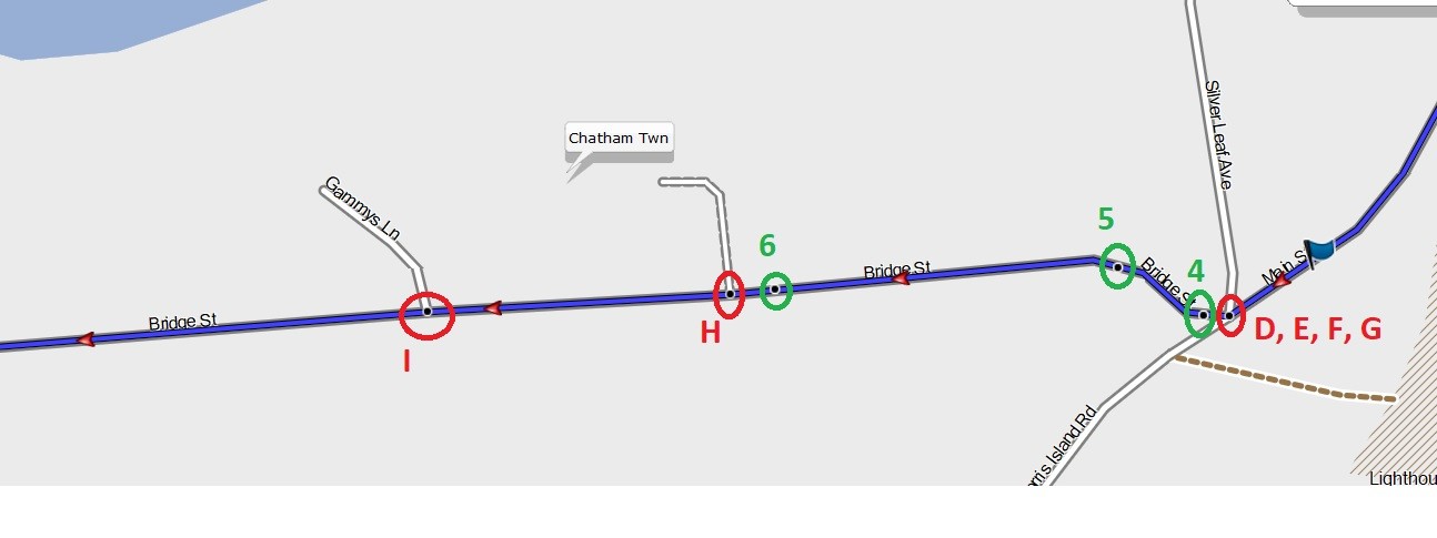

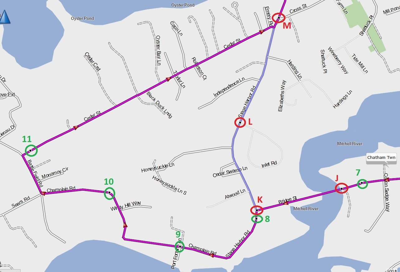

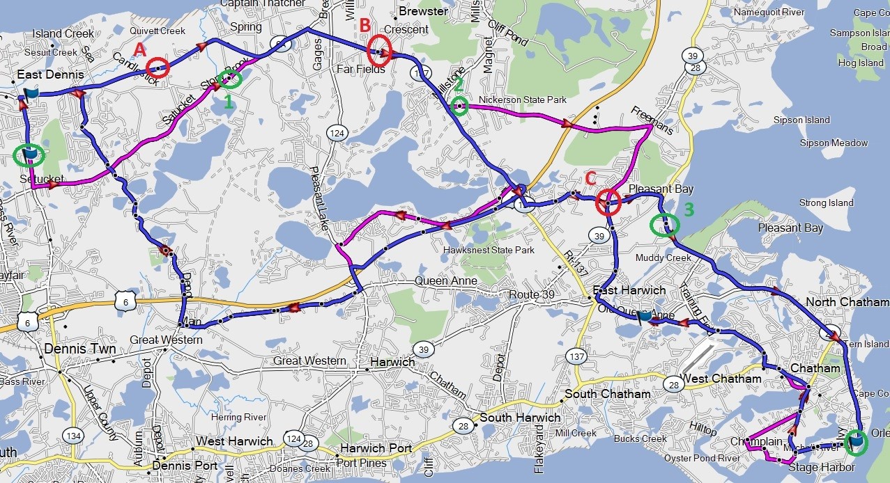

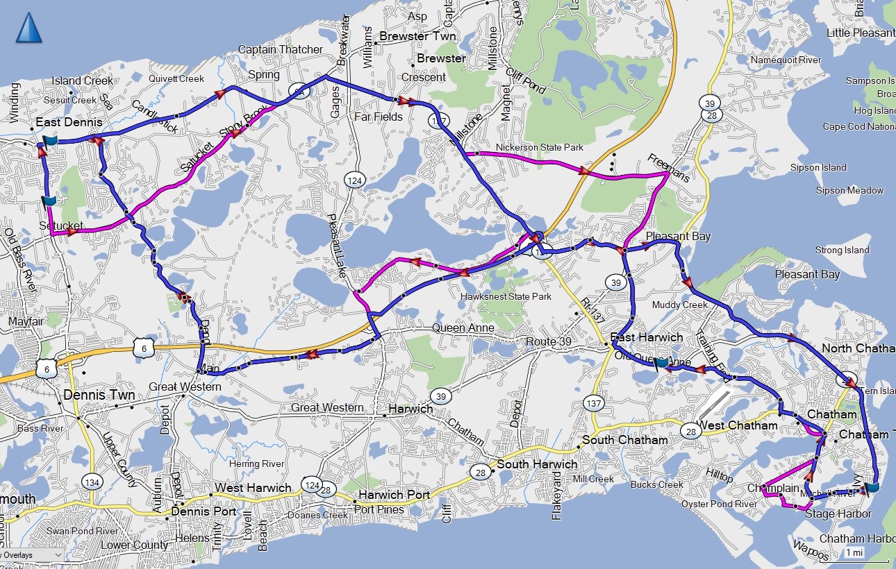

The magenta line below shows the original route which was imported to the XT2 and the route as re-exported before sync. They appear identical.
The blue line shows the changed route after Tread sync. The via points are identical for all the routes, The shaping points in the post-sync route are very different. In the next 3 images, the shaping points in the original (and pre-sync exported) route are shown with numbers. The shaping points in the post-sync route are shown with letters.
Note that Tread created the exact same shaping point 4 times at D, E, F and G.
Extracting the points from the 3 gpx files shows, consistent via points, very minor shaping point location differences between the original and pre-sync exported files, and significantly different shaping points in the post-sync gpx file.

Shaping points had all been repositioned. They were on the same road, but in slightly different locations.
With one exception. At one 'T' junction - from a side road onto a main road - the left hand turns is a very tight, downhill hairpin bend. The right hand turn is alsmost straight on. Basecamp refuses to produce a route that turns left here. But I put two waypoints to force it to turn left. On the bike it is doable. I do it every time I am up that way - but you need a good clear view of the road and you have use the wrong side of the road on approach and exit. The two shaping points that I had put there to force it around this bend had gone. Instead, two shaping points were added to a narrow side road which short-cut the junction fromabout a mile before, and emerges after the junction a mile later.
That is quite clever - but it suggests that for shaping points the XT2 works out the route and modifies it if necessary and then puts in some new shaping points to lock it in place. Which is why they all change their name. They are not the same shaping points. Perhaps. Certainly that happened witht he two points that had been created as Waypoints. The waypoints were still there plotted on the map, but they were not included in the route. Two new shaping points had been used in the route somewhere close by.
Test 2. The second test was identical. Except - I didn't use any waypoints. I recreated the route using the route tool. Point click, point click and build the route on top of the present route. The points were in slightly different locations - I didn't want to click on a point here there was a Waypoint. I created 6 Via Points, as before and the rest were Shaping Points.
The results were quite different in some respects. The route from Current.gpx was identical to the one that I had plotted - including the awkward junction. The route points - may have moved a tiny bit but not enough for me to notice. I plotted both on the same map, set as different colours and ketp switching from one to the other. No difference. This next bit was unexpected. Nearly all of the shaping points retained the name that I had give. Nearly all of the Via Points did not retail then name.
In both cases, I feel pretty sure that the route had been recalculated. In Test 1 there was evidence of that. No evidence in Test 2.
