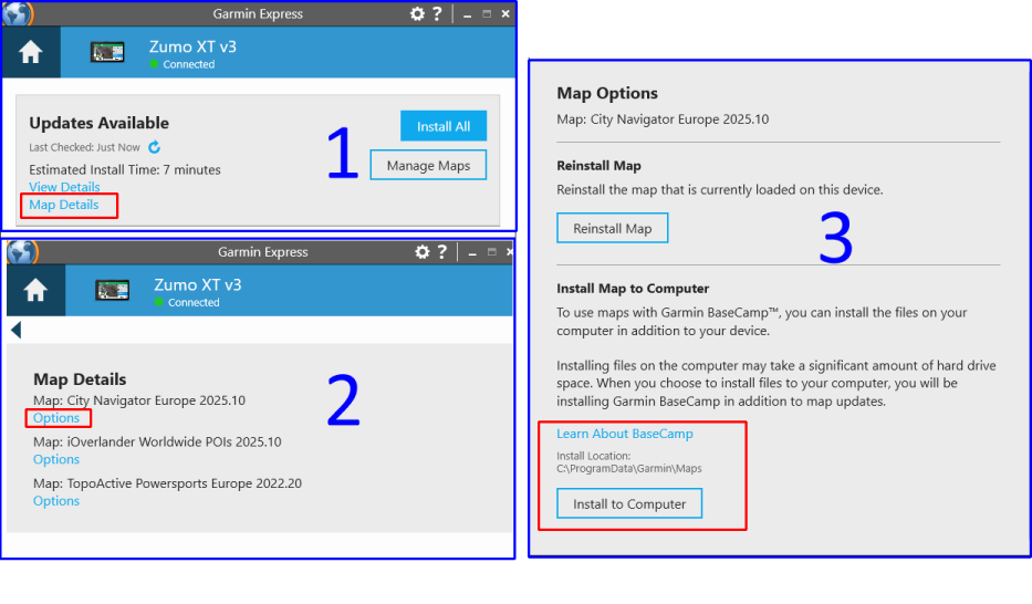

You can use Express to update the maps on the computer. I do it every time I update the map on the Zumo - as a separate process.suzjsteele wrote: Thu May 23, 2024 2:12 pm So I have had a Garmin devices for many years, previously I always used Basecamp for route planning but (i think) it is no longer supported and the maps are not updated/the same versions as the newer devices such as the Zumo XT so it is not compatible.
You may have to update your Zumo first, then update the computer.
I posted this imgae to someone else the other day. Nevermind, here it is again.

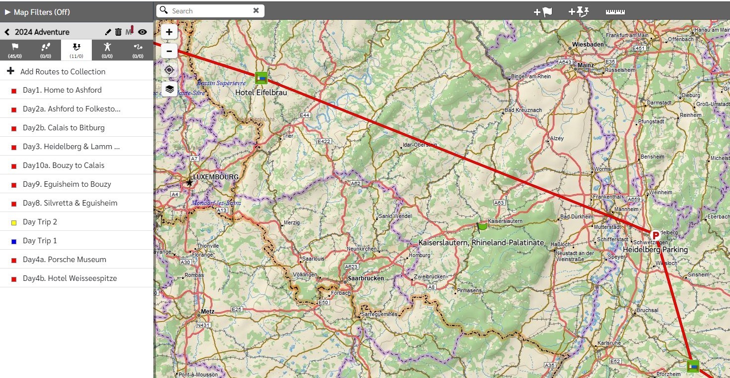

Thanks. I've checked and everying in Explore is visible.

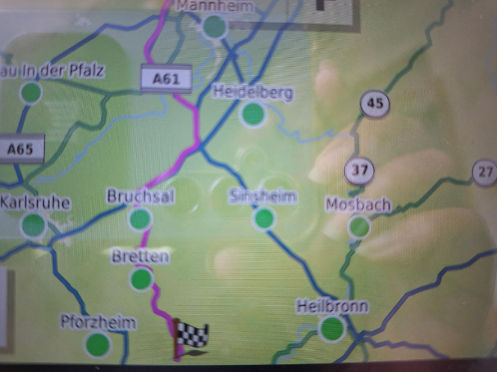

The waypoint isn't showing in the route which is what you have explained why below, but I don't recall that being a problem on my last trip.
I have attached the varying images so you can see
1. Screenshot of the route created in Explore
2. Same route in Zumo when synced
3. Map view in Zumo which shows the waypoints
4. Trip created in the Trip Planner App on the Zumo using the synced waypoints
(Click the image to getthe original larger version.)
I think the answer might be to edit the route in Explore by adding more shaping points rather than the waypoints

I am confused. (I've got the image orientation sorted out and the sequence now matches your text)
As I understand :
You cannot add waypoints to a route in Explore. You can add them to the map, but they do not affect the route in any way.
Waypoints do get sent to the XT - but again, they do not affect routing.
Routes in Explore consist of straight lines. If you make them short lines, the path created has plenty of corners. The route created by the XT will pass through every corner. As if they were shaping points. If you have Waypoints on these corners - it looks like they are part of the route - but they are not.
You can get the plotted line to follow the line of roads - but these are courses. Its been a while since I checked, but these could not be sent to the XT. Also, courses had a nasty habit of following footpaths and tracks rather than roads.
Explore doesn't have an option for plotting shaping points or via points. Only Waypoints which are not part of the route.
