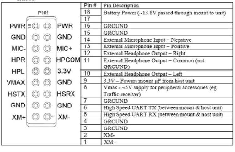

I have a similar issue with a 595 cradle. Does anyone know which pins I can test on the cradle with a DVM to make sure I am getting power to the GPS device?

Thank you for the pogo pin information. Seems as though my 595 cradle is broken. I have verified power at the cradle power connections and the fuse is good. I did not measure any power on pin 18. I've verified the GPS works in a car cradle so I know the GPS is working. This is the second time I've had a 595 cradle fail in my 2011 Harley-Davidson Electra-Glide Ultra in the last (5) years and about 95,000 miles. I'm not sure if the motorcycles vibration is causing the cradle failures, but after the 1st cradle failure, I purchased a TouraTech locking GPS mount (# 065-0791) for the express reason the TouraTech mount has rubber isolators for vibration protection. When I replaced the last cradle, the cost was US$69.00. Now the price for a replacement cradle has shot up to US$120. For that price I might as well purchase an XT2. And I leave tomorrow on a trip where I was depending on using my GPS for routing on all sorts of backroads. I'll probably just use the GPS with the car mount, usb cable and place the unit in a tank bag and figure this all out when I get back. If anyone knows what might be broken in the cradle and if it can be repaired, please let me know.
