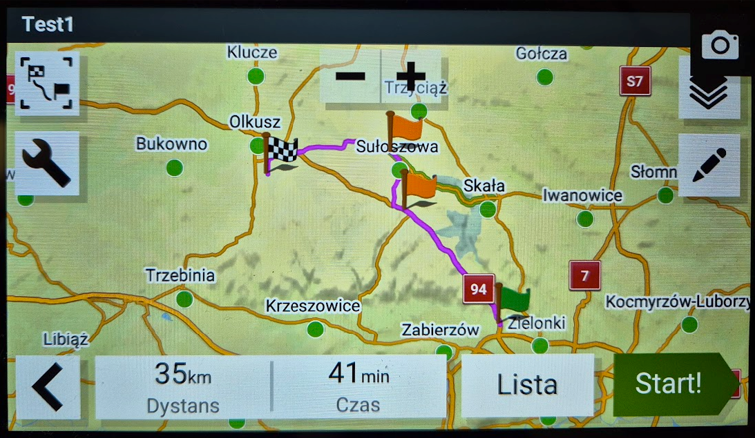

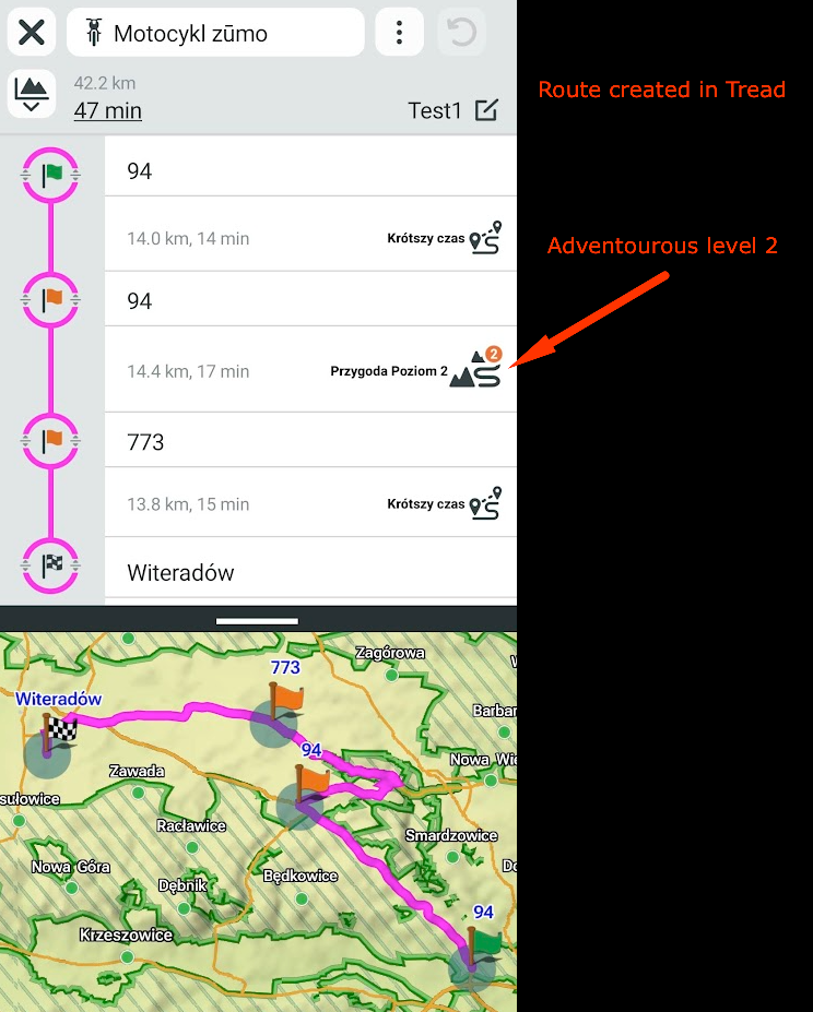

I also did some tests and found out that when creating a route in Tread (or XT2) we can use predefined calculation modes between via/shaping points: Faster time, Straight line, Shortest distance, Adventurous level 1-4 (names might be a bit different - I'm using Polish UI).
And I suspect that sync between Tread and XT2 is using simple GPX file with just via/shaping points and chosen calculation modes but the problem is that there is no distinction between Adventurous levels in that GPX file so XT2 doesn't know about different levels between the points. And it recalculates the route using some defaults (from my observation it looks that 'Adventurous' is treated by the device similarly to 'Shortest distance').
Route created in Tread:
Same route in XT2 (synced with Tread):

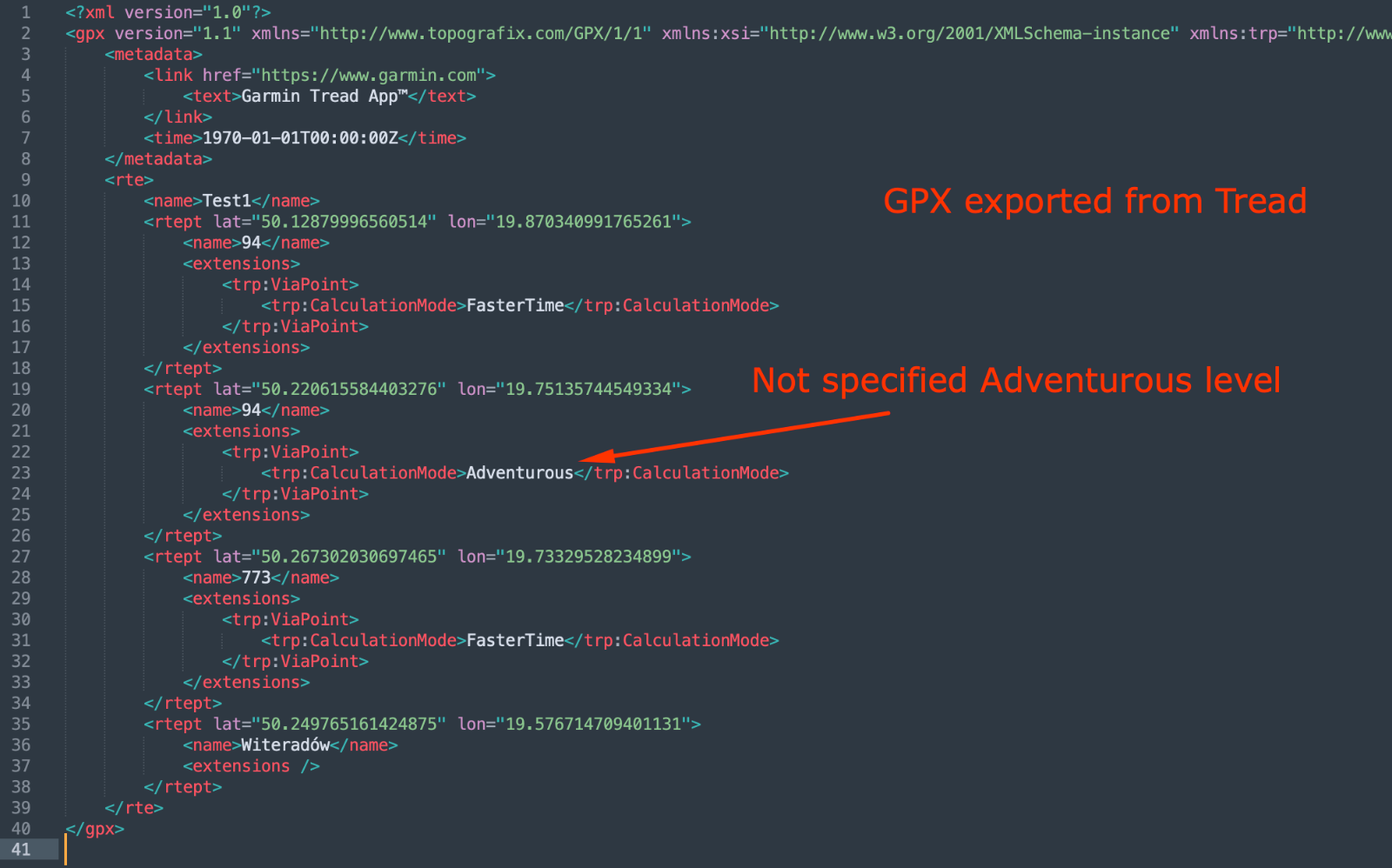

GPX exported from Tread:

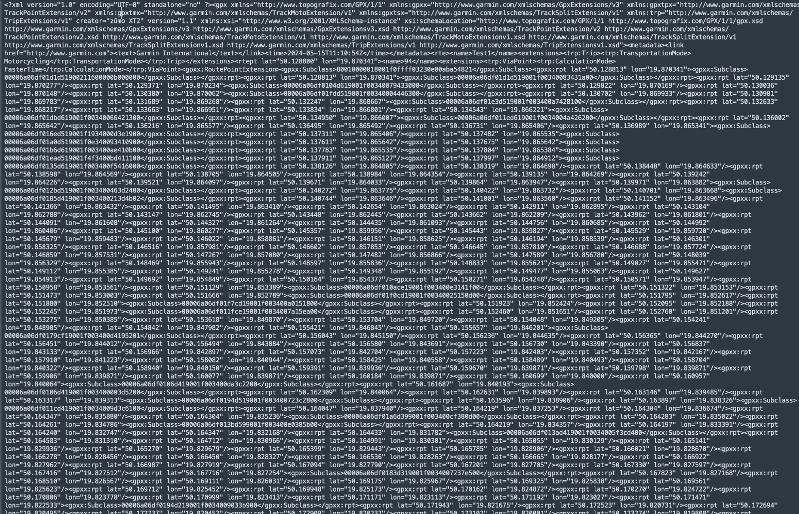

GPX for the same route exported/shared from XT2 (but already modified in the device) - it's huge, contains thousands of points, rather like a track, not a route:
It seems that Garmin needs to define another way of syncing between Tread and XT2 to get similar results in both.

It looks like the route from Tread exports juts the Via points, and an indication of the type of routing to be used. On the XT if you were to send it Adventurous - it would use its default setting of Faster Time. I guess that Tread is used by many different devices - just as Basecamp is. Some devices know about certain types of routing some do not.
The only way of finding out is to find a location on the map where you can distinguish between Faster, Shorter, Adventurous levels. That way when you send a route to the XT2, you know which method it has used to calculate the route. Thats what I had to do to establish that the XT defaults to using Motorcycle and Faster time if you send it anything other than what it knows. It only understands Car, Motorcycle, Direct. It only understands Faster, Shorter. Anything else it uses its default.
Perhaps you can set Adventurous on Tread, but the XT2 doesn't recognise it so it uses a default.
The thousands of points. Those are the gpxx route point extensions. They are thousands of individual route points that the Zumo joins up with very short straight lines in order to plot the magenta line accurately. There are two ways of preparing a route. One is to give it the start, end, and any via or shaping points. Let the Zumo decide how it is going to travel from one point to the next. The other is for the program itslef to claculate the route . In order to fix it in place, it has to send thousands of coordinates so that the Zumo can join up the dots with short straight lines. You cant see these points, but they exist. I call them 'Ghost Points'. BAsecamp uses these and whatever you send from BAsecamp - that is the route that the Zumo plots. Precisely. UNLESS - the Zumo decides it has to recalculate the route. In which case it discards them and calcualtes a new route wit new ghost points.
From Basecamp, if you send a route and you want the Zumo to stick to it, you must trun off automatic recalculation - because the XT will find many different excuses to recalculate the route. Maps differ, straying off route, Road closures are a good one - you can't stop those, short of turning your phone off.
MyRouteApp and Basecamp can produce both types of route. For Basecamp, the one without Ghost Points is called a Direct Route - you use the Direct BC profile to create it. Te default is to plot a route with the ghost points.
For MyRouteApp - it can do both as well. gpx v1.1 exports the start, the end, the vias and the shaping points. It does not send any ghost points. The Zumo has to calculate the route.
gpx v1.2 exports the ghost points - it also send the Via Points (hands), but if you have used any shaping points, it does not send those.
For v1.2 in a Zumo, Recalc must be turned off if you have used any shaping points, because when it recalculates, it only has the Via Points to work with.

Nb In Basecamp, you can turn a route into a track. Each ghost point is simply converted to a track point. But in BAsecamp you can see where all of those thousands of track points are, and you can use the track properties to see how far apart they are and select a whole section.

jfheath wrote: Thu May 16, 2024 2:52 pm Perhaps you can set Adventurous on Tread, but the XT2 doesn't recognise it so it uses a default.
Yeah, I can set Adventurous Level 1 - 4 (not just 'Adventurous') on Tread, and the same on XT2. But the problem - which is suspect - is that sync process uses only 'Adventurous', without specifying additional levels and XT2 is not recognising a route correctly (probably it applies some defaults).
