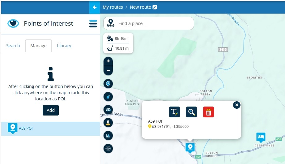

Adding a POI to the route. Click on the POI, there is the big 'plus' sign to click.
Adding my own POI (A59), and doing the same thing - there is no way to add it to the route.
No big plus sign in the pop up menu.
The only thing to do is to put a shaping point on top of the POI - which I think is what he was suggesting.

Exact. The POI created with "Manage" is only associated with the route open when creating it.
So, as described in my previous reply, I can see two solution for this:
1. Create what I call "a virtual route", ie open a new route, define all the POIs that are requested, with "manage". If I want all those points available in the "Favorites" library on the zumo, I can save the corresponding gpx file and import that route on the zumo. All corresponding Garmin waypoints are then in the "Waypoints" library (Favorites) on the XT2. Then in MRA, each time I want to create a new route with the disposal of the POIs previously defined, I start from a copy of this virtual route. But, true, the only way found to add one own defined POI as an MRA waypoint on the new route is to put a shaping point on top of, or close to, the POI (or drag an existing waypoint of the route to the POI). I doubt in this case that on the XT2 the waypoint corresponding to the POI will be "announced" when reached.
2. When in the route where the POIs where created, save it as a csv file, go in the library tab of the POI panel , click "add" and in the upload panel select the corresponding csv file. The POIs are then available for all routes in the Library tab of the POI panel. But again selecting one makes it appears on the map of the route you are making, but as you said, the only way found to associate this POI to the route is to put a shaping point on top of the POI.
So, it seems feasible to manage a set of POIs in MRA and to have that set imported in the "Favorites" library ("Waypoints" on the XT2) on the zumo.
But the "big plus" option to add in MRA one of the POI as a waypoint (via or shaping) to the route in order to force the route to pass trough the POI is not available for own defined POI. Only solution found is as you said to put a shaping point on top or in the vicinity of the POI (both also available for the route imported in the XT2). All that only thoughts, practicality for the real use of it still to be evaluated!

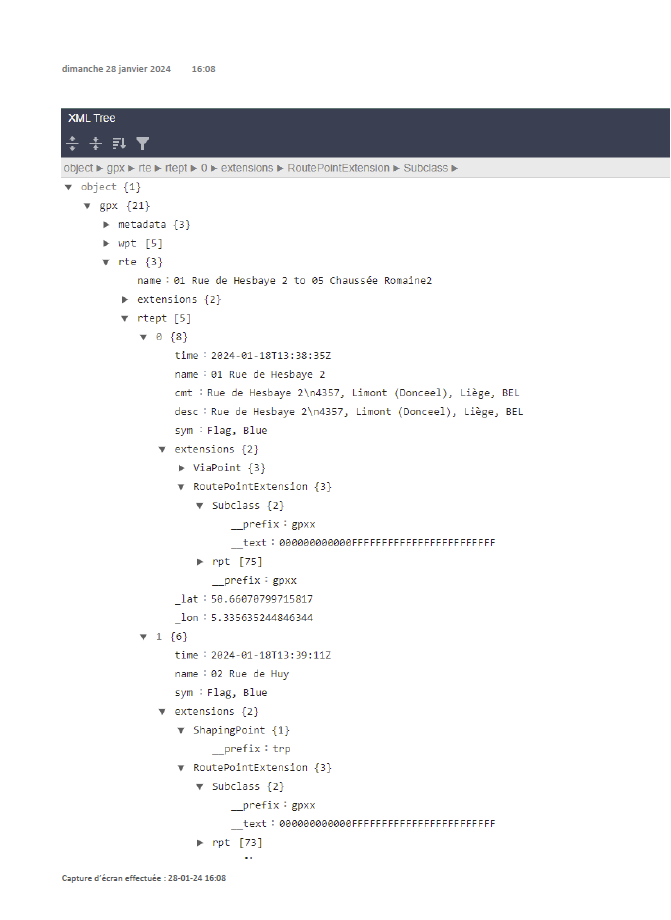

@jfheath: some additional informations about investigations of the incidence of the subclass _text of the RoutePointExtension (gpxx data) on the alteration or not of the name of via or shaping points on the XT2.
As highlighted by jfheath, if the route created in basecamp in based on predefined waypoints, this subclass is effectively a collection of "0" (12), followed by a collection of "F" (24), as shown in the XML content of the corresponding gpx file:
For this case, name of shaping points and via points unaltered.
Corresponding XML content for the gpx file when using in basecamp the route tool to create the shaping and via points is as follows:
So as highlighted already before by jfheath, no more "0" and "F" collections for the subclass _text of the RoutePointExtension, either for a via point or for a shaping point.
But on the XT2, after import, the name of the shaping points are altered but the name of the viapoint are NOT altered! So it seems that it is not only related to the content of the _text subclass of the RoutePointExtension (gpxx data).
I try to decode the content of this subclass _text, but without success (conversion of hexa content either to ASCII or to Unicode UTF8 leads to garbage data). Has anyone an idea how to decode this content?

Hi @jfheath. It is exactly that: the first xml content corresponds to waypoints in basecamp converted to viapoint (one shown) and to shaping point (one shown).
For the second xml content, the shown viapoint and shaping point were created by the route tool in BC, without going through waypoints first.
The Xml content shown is just obtained by reading the gpx file (which finally is an xml file) with a XML viewer. The advantage is that everything is well structured and identified (not like the content of notepad). Several viewers are available for free on the web.
