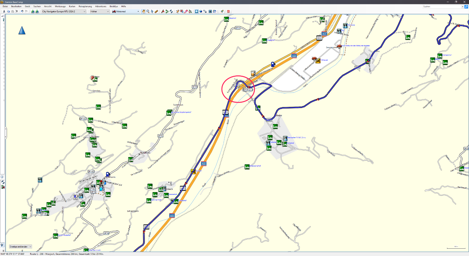

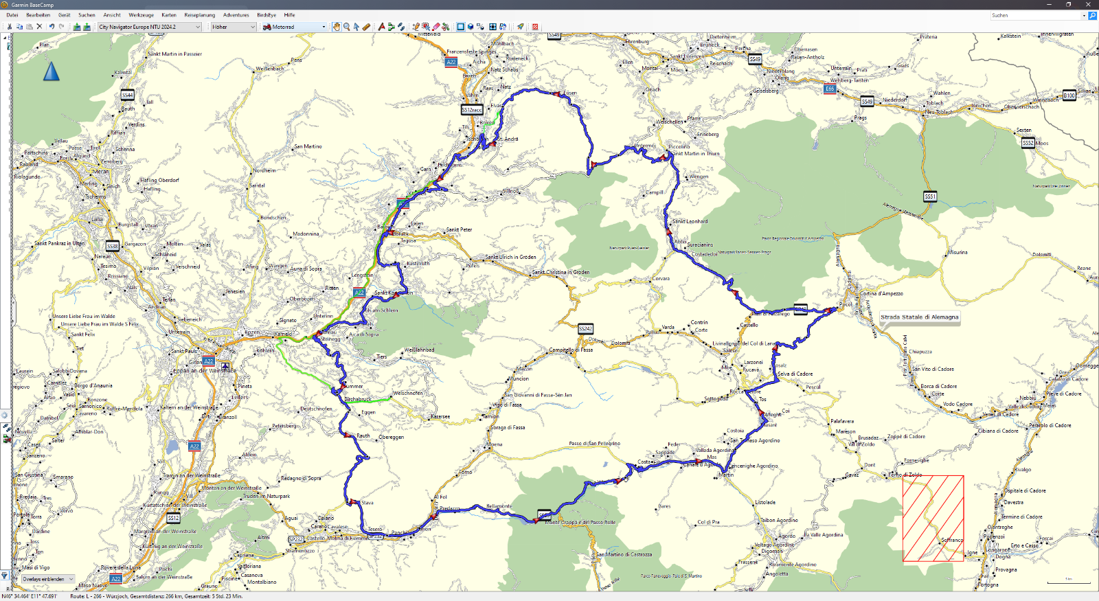

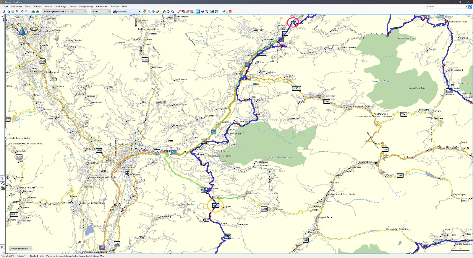

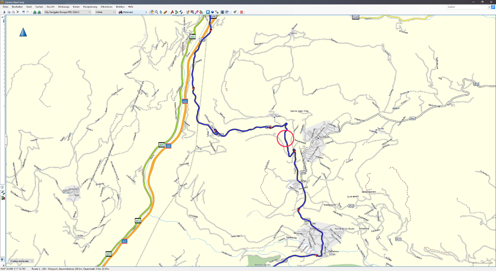

Re: Wacko traffic auto-recalc routing
For sure this can't be the only reason for this zig-zag weirdness re-routing!rbentnail wrote: Fri Sep 29, 2023 10:13 pm Looks perfectly logical to me. The XT is re-routing what it believes to be a closure. But you have forced it to visit each point on your original route so that's all it's doing- taking you from the calculated route, to a point, then back again. Repeatedly. Is it not as simple as skipping the points?
In my example from 2021, that i've posted above, there wasn't any via- or waypoint in the pre-planned route, only shaping-points and i got the same stupid zig-zag course with an extra of around 100km(!) after such a road-closed-rerouting....
