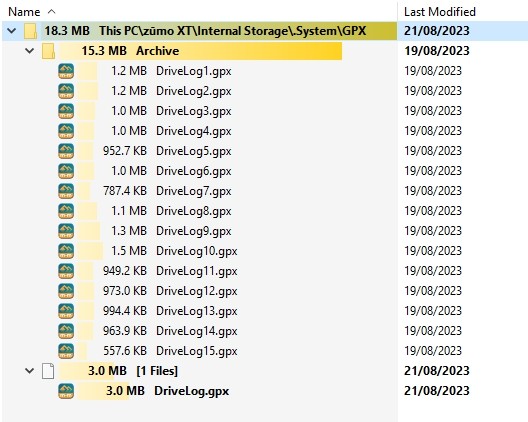

Long shot. Can you see the hidden .System folder ? In there, there is a folder called GPX, and that contains DriveLog.gpx which appears to be a duplicate of the CurrenTrackLog.gpx. The archive folder seems to have duplicates of the numbered archives but these are called DriveLog1.gpx, DriveLog2.gpx etc. They may still be there if the Archive contents were deleted accidentally - but they do not survive a system reset.

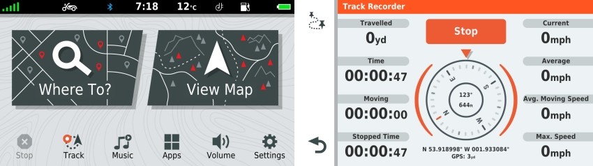

Recording a Track Manually
Some screen shots. Click the pic to get a slightly laregr version.
Note the little recording orange disc on the Track icon.
You must press Stop in order to save the recorded track. It will keep recording each time you turn ont he Zumo as until you press stop.

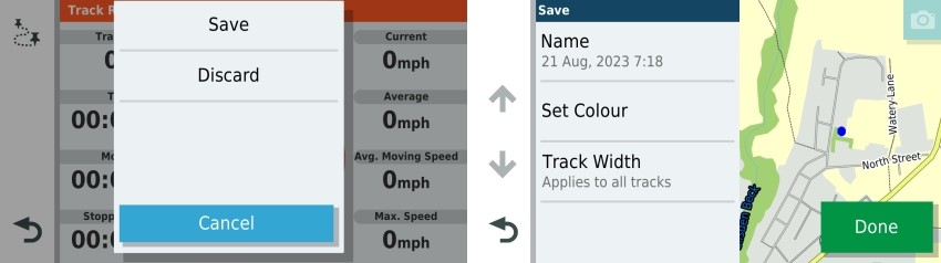

When you press stop, you get the option to save or discard. Tap Save.
Only then does it give you the option to change the name - which you can do by tapping the name label on the left.
And then - you must press 'Done'.

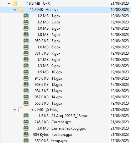

Here is my view of my files and folders.
This is after recording a very short track of my Zumo moving 2 feet across my desktop.
Curiously - I also have just 15 files in the archive - and these are all set to the same date - 2 days ago.
I had never spotted that before. My CurrentTrackLog.gpx file is also large at 3MB
Note at the bottom is the contents of GPX with the same standard 4 file names (Current, CurrentTrackLog, Position and Temp). The saved track log is there - with the name given by the XT by default - I didn't change it.
If you had saved it, then it would be there. I see that @FrankB has added other ways of getting the track log out of the XT - but you must have saved it first - and in your folder list, for whatever reason, it is not there.
It is possble to delete these tracks using the Track apps.
XT GPX Folder.jpg (53.29 KiB) Viewed 1577 times
And this is the GPX folder inside the Hidden .System folder showing the DriveLog files.
XT System GPX Folder.jpg (58.16 KiB) Viewed 1577 times

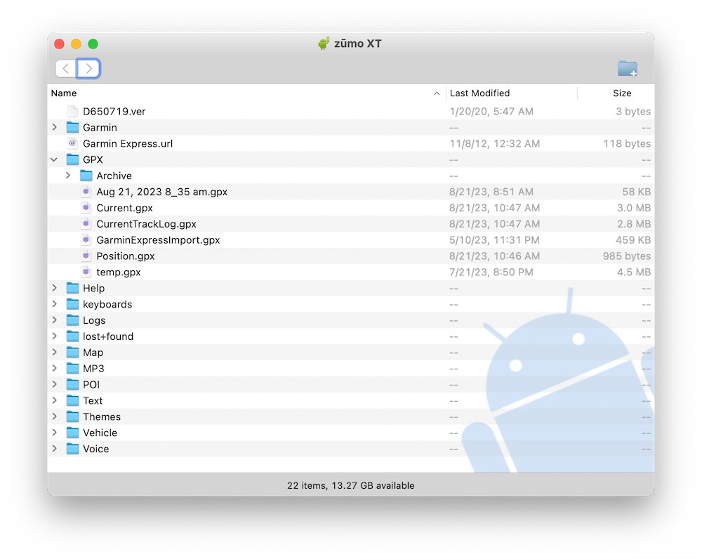

Encouraged, I plugged a USB cable into the zumo. Once mounted (via Android File Transfer), I opened the GPX folder and there was my track, properly named.
Screen Shot 2023-08-21 at 10.49.09 AM.jpg (108.33 KiB) Viewed 1561 times
You can see it there at the top "Aug 21, 2023 8_35am.gpx." I dragged the file to my Mac desktop and tried opening it with Utrack and Google Earth again, with the same positive results: The speed and elevation data were properly saved.
