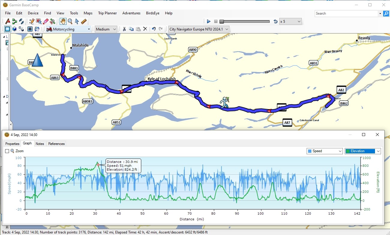

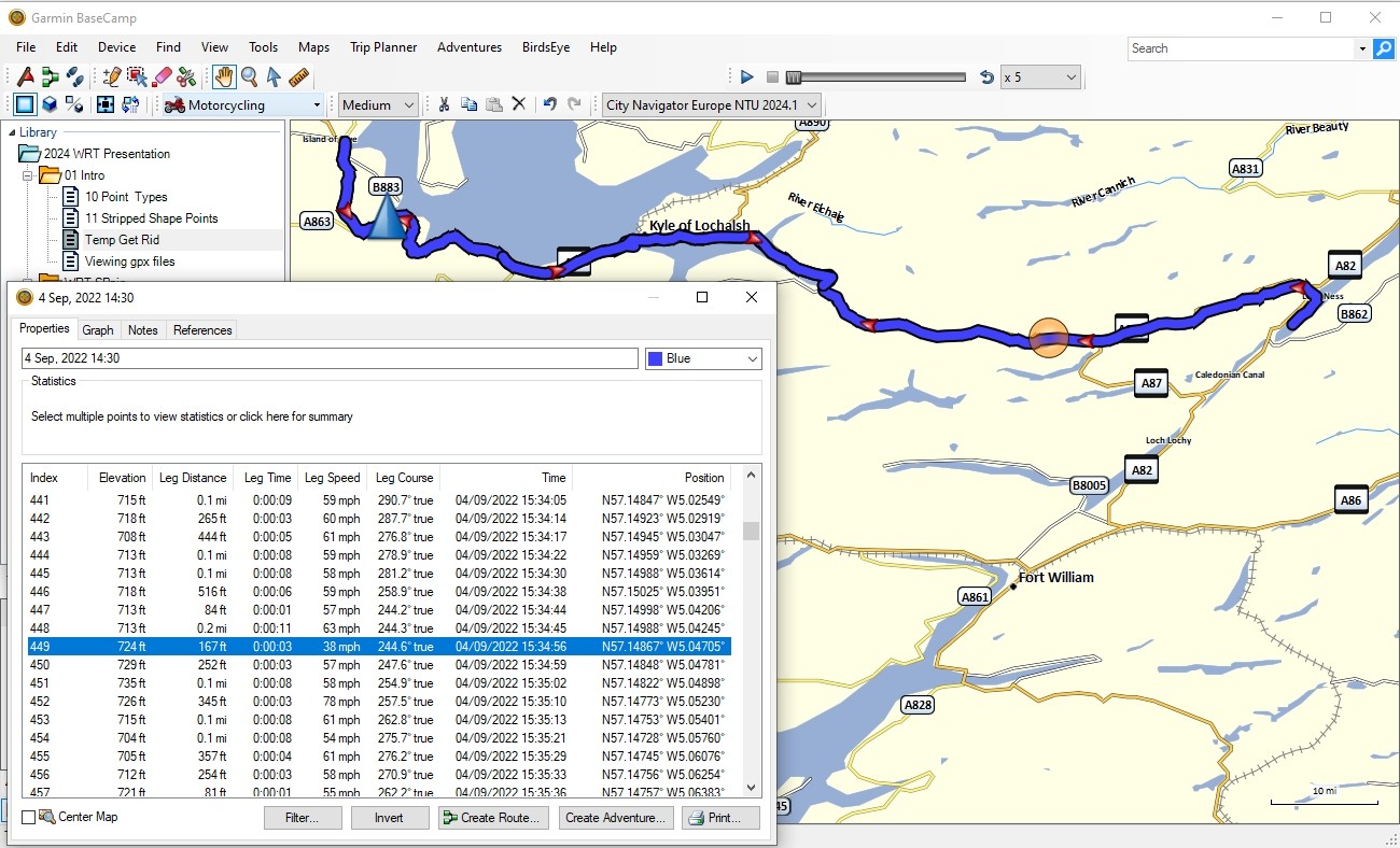

Below are attached two screen shots from Basecamp.
One shows the graph and the runner indicating the point on the map.
The other shows the detailed table of points and their recorded values. The circle on the map plots the point that is currently highlighted in the table. The contents of this table are easily transferred to a spreadsheet.
Timing of the recorded points seems to be a little odd. Often out by an hour - something that is not explained by Daylight Saving Time.
Note that satnav recorded speeds at a given point cannot be relied upon. For an accurate speed you need a couple of position fixes and the time recorded for those points. You can then calculate the speed.
This isn't just this satnav. GPS satellites do not know the speed. The satnav can calculate your position, but even that is subject to error of a few metres. An error of a few metres in the space of one second, can make a significant difference to a speed calculation. A total error of (say) 4 metres over a distance of 400 metres will result a calculated speed which is subject to only 1% error.
Note that your satnav NEVER shows how fast you are currently travelling. It shows an average speed over the last few seconds (I think it is 5 seconds, but I don't know). So althought he avergae is pretty accurate, if you speed stays the same for that time. It can be wildly out on twisty roads, in areas where the vision of the sky is limitied (mountains, tall buildings, ....) and very noticably when you brake or accelerate quickly. The displayed speed lags behind the true speed.
I don't know which value is recorded in the active logs. The graph suggests that it is an inaccurate spot check.
The thumbnail attachments below will expand to full quality screen images if your browser is using the full screen and you click the thumbnail.
Case in point: For that stretch of road I was travelling at 60mph. I don't break the speed limit. Yet a couple of points further down it suggests an illegal speed. I have a few of these throughout this file. In one set of readings it has me at 51, 105, 0, 107, 54, 0,107, 54, 0, 54 with 1 second between each reading. Most of the readings either side of this are between 55 and 58. A weird glitch.
But by highlighting a number of consecutive points in the table, BAsecamp will show a summary of the elapsed time, distance and average speeds. Not average of the recorded speeds - but the real average obtained by dividing distance traveled by elapsed time.
A Fascinating tool. Worth half an hour of anybody's time !

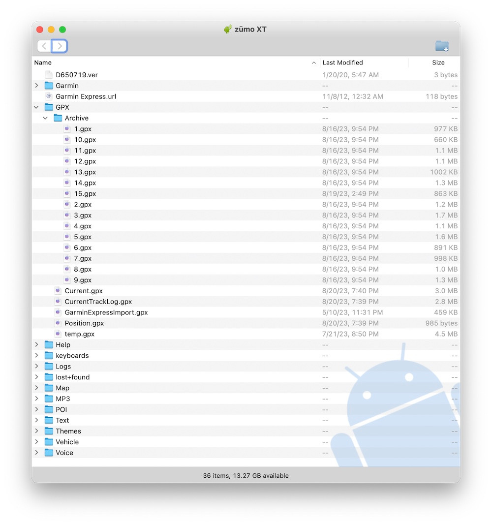

I knew that the XT saved "Active Tracks" but I was more interested in using "Track Recorder" function so I could control exactly when the recording started and ended. That was always my routine when I used the 660: At the beginning of each day's ride, I'd clear the current trip log and start riding. Then when I arrived at that day's destination, I'd call up the log, "View all segments," and name it/save it. I figured it would be much the same on the XT, but of course it's very not.
Thanks to your information, I was able to retrieve the tracks from my recent trip which had fortunately not yet been overwritten. Some of them are broken apart across a couple of files, but I can work with that. And I imported them into BaseCamp and saw all the graphing possibilities – Interesting!
Much of the same functionality as the "uTrack" site (but yes, the time's not right and the speed tracks seem way off). And they also work for the high-speed helicopter tours in Google Earth which are always fun.
But the tracks I saved on purpose using the track recorder still don't seem to have retained the "time" data. I wonder if it has something to do with the transfer method? It's clunky on the XT – I select a track in the "Tracks" app, hit the wrench and select "Share." My options are Bluetooth (to share with another Garmin device), microSD card, or share using the Garmin Drive app. I use the Drive app, and once the file is "received," I can AirDrop it to my Mac. The file always has the same name (bt_shared_tracks.gpx) and if I've selected more than one track they all get smooshed together into one file.
After I realized that, I'd import them one at a time, re-naming them as I went to keep them organized.
But no time information seems to have come across. I just imported one into BaseCamp and tried that "Graph" function, and the only thing it would show was "Course Over Ground" which is basically the compass directions at each turn. The "Speed" and "Elevation" options were gone. I also tried using a microSD card with the same result.

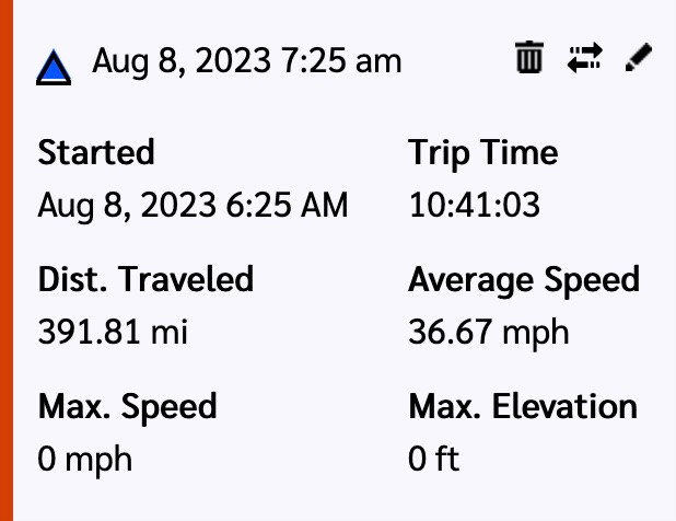

Re: Zumo XT doesn't save time information in Tracks?
Curiouser and curiouser!
I DO have my zumo XT linked to Garmin Explore. I'd forgotten all about Explore until just now. I went to the site and my tracks were there.
Interestingly enough they captured my distance and travel time, but "Max. Speed" and "Max. Elevation" were both zero.
I'll try to un-link my XT from Explore and see what happens. I probably won't be able to get out until next weekend, but I'll post the results in this thread.
Thanks again!
Thanks again!

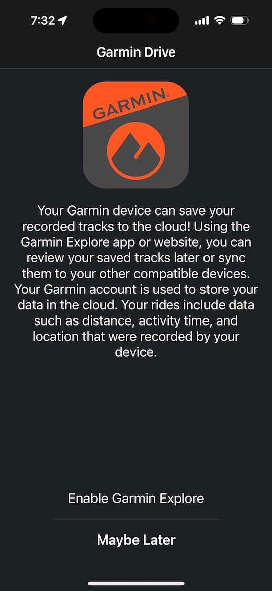

I had no idea it was so complicated to divorce a zumo XT from Garmin Explore! Lots of long threads about it, and I thank those who documented the process.
I think I've successfully disconnected my zumo XT from Garmin Explore. I deleted the Garmin Drive app from my iPhone and powered it down, cleared the Explore database and shut down the XT. Powered everything back up, downloaded a fresh copy of Drive, woke up the Garmin and re-paired it to the phone.
But the Drive app wants me to log in to my Garmin account. Can (should) I do that, or will it re-connect me to Explore?
I like the functionality I get from the Drive app (like traffic and construction updates) but I don't want to deal with Explore any more.

I can connect to the zumo XT with a USB cable, but my "recorded" tracks don't appear to be anywhere. At least, nowhere I can find them.
I'm on a Mac, so I have to use "Android File Transfer" to mount the zumo XT on my system. I end up with a window that looks like this:
As you can see, I've opened the "GPX" and "Archive" folders to see what's inside. The numbered GPX files (1.gpx, 10.gpx, 11.gpx, etc.) are indeed the auto-saved "Active Log" archives that the zumo creates. But each file contains several tracks, often several days' worth. For example, if I open up "5.gpx" I get six actual logs, spanning different parts of July 29th and 30th. And each one does have all the track info: speed, distance, elevation, etc.
But I can't find the tracks I manually recorded using the "Tracks" app. They show up on the XT (in the Tracks app), each one named with the date they were recorded (like "July 30, 2023 7:45 am")
Since they're not in the GPX folder, I figured the "Log" folder might be another likely location, but the only thing in there is another folder called "fit" which is apparently empty.
And actually, now that I've completed the separation from Garmin Explore... my saved tracks are gone!
Were they only stored offline on the Explore app? That's annoying.
Next time I go for a ride, I'll try manually recording again and we'll see what happens (which was the plan in the first place).
Oh, and thanks for the info about (re-)connecting to the Drive app. I entered my Garmin account info and got this page:
I tapped "Maybe Later" which hopefully means "Never."
Thanks again – I'll keep you posted!

I should have read further before posting this. SO I have told you how to do somethingt hat you have already spotted. Never mind, I'll leave this answer here becsue it contains additional information.
Near the top of the list
CurrentTrackLog.gpx
And then all of the numbered files in Archive
ie 1.gpx, 2.gpx, 3.gpx etc.
The CurrentTrackLog is added to, each ride, until it gets too big, when another numbered file is added to the archive and a new CurrentTrackLog is created. The oldest numbered files are eventually deleted to make room for more recent files.
If you want to keep them, I suggest you copy the contents of Archive soon. The zumos use to keep the latest 20 files. The XT claims to keep around 6 months before it starts deleting. None of my 3Xts to date have reached that figure to find out.
I'll post this and add more in a minute.
Back again. Curious that all of your numbered archive files were last modified on 16 Aug 23. Im not sure how the 3Mb of the currentTrackLog gets broken down into 1Mb (approx) archive files. Older Zumos would archive as soon as Currenttracklog got to 1Mb. I have spotted that the XT has modified the last two archive files after they were first created. I know that they claim to keep tracks from the same day all together.
