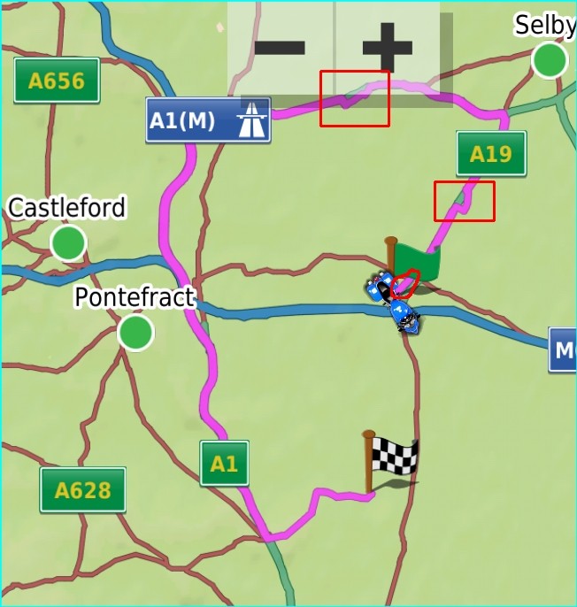

The 'track trip' behaviour is interesting. If you deviate, it's job is to get you back on track and it seems to do this by finding it's way to the closest point on that route. It helps if you first observe following a track. Load a track and say Go!. No navigation commands, but the xt plots a dotted straight line to the closest point of the track. Leaving the track completely intact.
Like this:
If you then plot a new track that is essentially 3 sides of a long rectangle, and convert that to trip- a 'trip-track' - and set off on that then you get navigation instructions. If you then deviate and head along the more direct 4th side of the rectangle, rather than the route which goes round the other 3 sides, you can observe very similar behaviour. It chooses the closest point of the (parallel) original route but this time calculates a way to get to that point along roads. Constantly updating as you ignore its instructions - finding a new closest point. In the picture below I am heading south in the direction of the arrows. The route is heading south on the parallel original route to the left of the screen.
Like this:
The new section of route from your current position to the closest entry point now becomes part of the actual route - continuing from the closest entry point along the original. It's important to remember that - the closes entry point splits the original into two parts, and 'discards' the section before the clsoeset entry point. It tags on the newly calculated section from where you are to the closest entry point.
But if you deviate in exactly the wrong direction - 180 degrees - the closest point to the new route is always behind you. Does that sound familiar?
The Trip-Track also gets stuck in a RUT in these circumastances.
So my suspicion is that certain operations performed by the XT use the routines associated with triptracks, rather than calculating to the next route point. I suspect that closest entry point and skip button use these triptrack procedures in order to calculate a route - rather than the one that plots a route to the next point. Which is why I think that a route does not get stuck in a rut if the Zumo has not recalculated the route - under those two circumstances. I have yet to find one.
Abandoning the route and then rebuilding the route on the XT screen, using the identical saved favourites will result in a route that behaves itself. This I think supports the idea that the XT has more than one method of creating a route. My suspicion is that after tapping Skip, or using CEP, a new route is built using a similar algorithm as the one used to create a track trip.

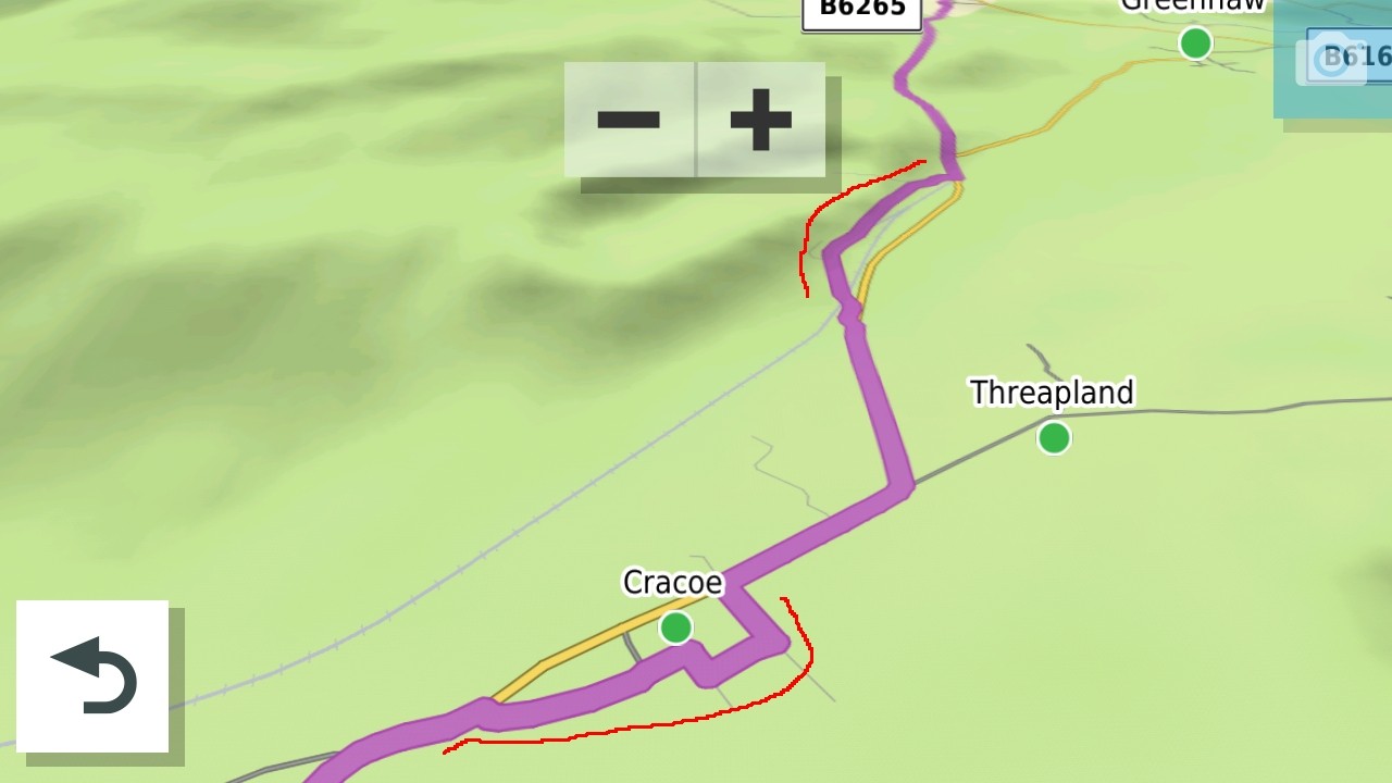

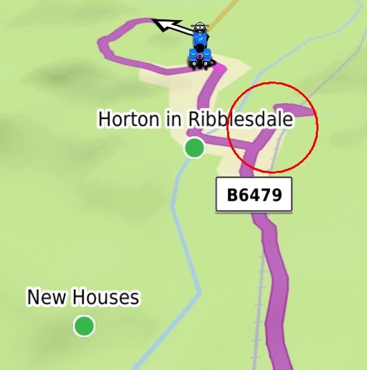

- A route that is actually 'stuck' in a series of U turn requests. These are difficult to spot. Only if the distance time ahead is less than the time to go back can you begin to suspect that you may be in a RUT. Even then, you would have to eliminate road closures ahead as the cause, and you cannot do that until you have continued to the end !! However - there is a clue. If you turn U-turns off, the xt has to find other ways of getting you to go back. This usually means taking a roundabout or side road that will lead you back on a parallel road for a short distance.
This detour off the main road is very visible on the preview map, and they become part of the route back. And I think that this is definitive evidence that the XT is no longer attempting to take you to the next route point. Attached are three examples of this behaviour. Click the image for a better view.
The route back includes all of the places where it plotted a way for me to turn round. If it was plotting a route to a particular point, it would not include those loops. The only conclusion that I can draw from this is that it isn't trying to get me back to a route point. It is trying to get me back to the last point where it told me to turn back. Repeatedly.
On the map showing Cracoe, the motorcycle is off the top of the screen. The satnav is wanting me to head south. The marked locations are where it attempted to use side roads to loop me back - and they are still part of the route that it has plotted for me to go back.
