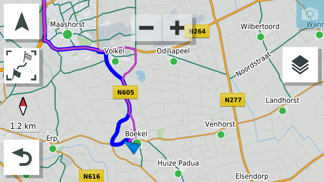

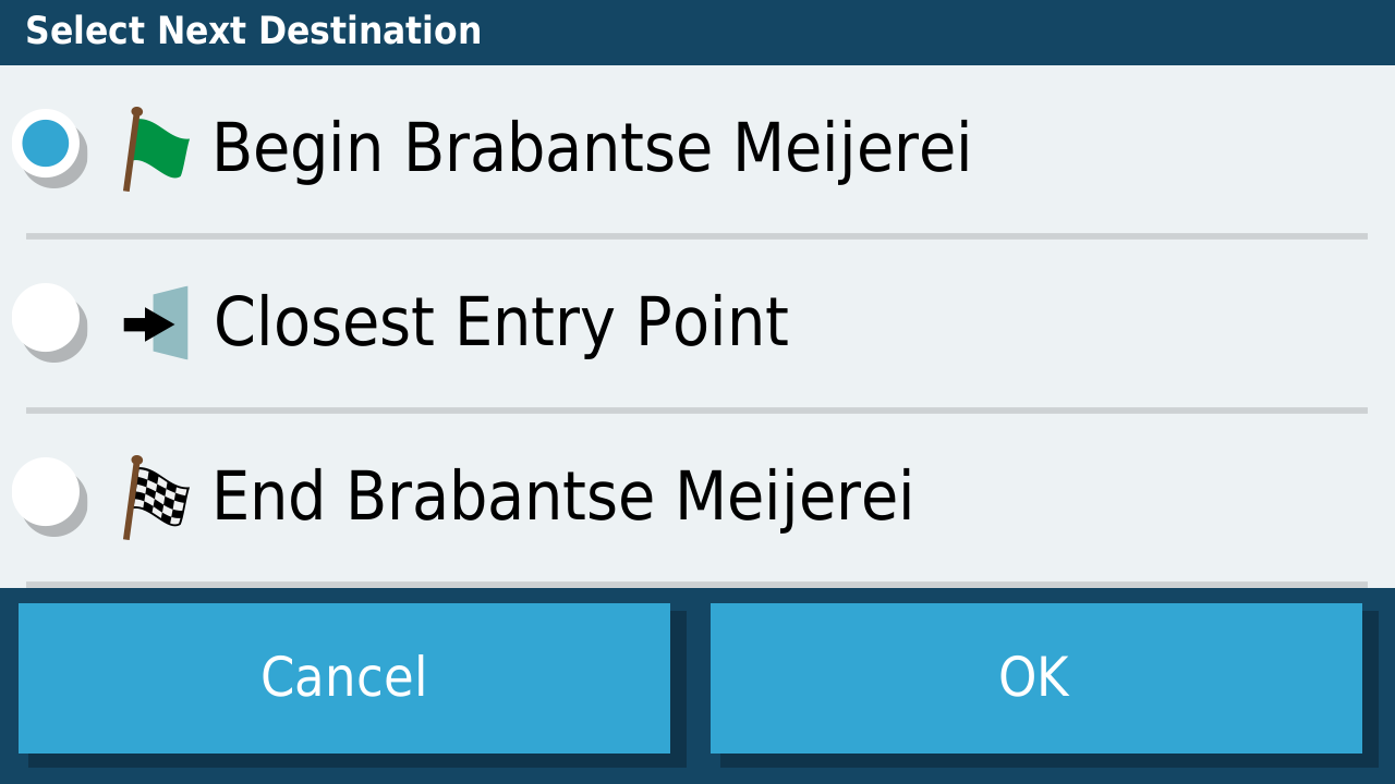

I drove a route yesterday and observed something that might be worth mentioning. If you start a trip on the XT and select 'Begin' the route from where you are to the beginning does not have the U-Turn behaviour. I was > 25 Km from the begin and I deviated 2 times from the XT proposed route. Both times there was just one U-Turn request, and then the XT calculated a new route.
Agreed: This is just one case. And it's not really a solution. But I think it adds more proof to the statement "Routes created on the XT dont show U-Turn behaviour"
Will think of a test case that reveals more.

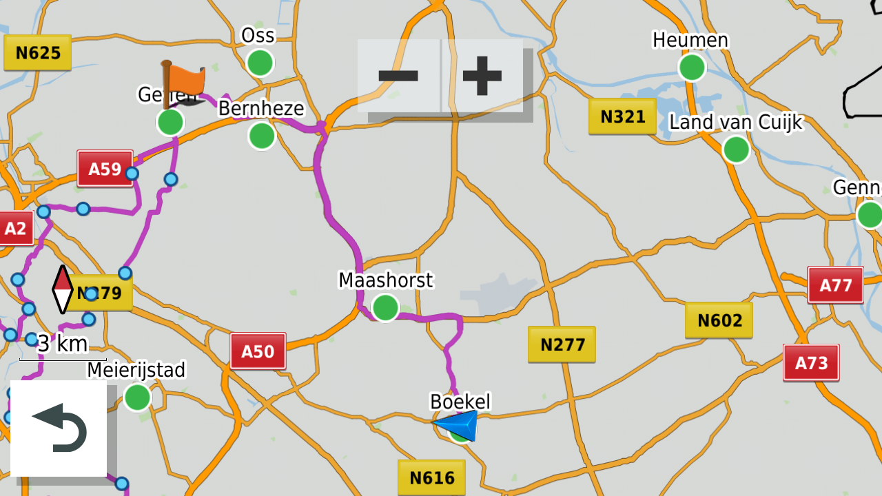

To make it absolutely clear to everyone
How I start the route/trip:
The route calculated by the XT from the current position to the Red Flag. (approx 25 Km)
The blue line is the track I actually drove. Deviated twice
FrankB wrote: Wed Apr 12, 2023 1:57 pm Yes. But then very much further away. instead of 200 Yards > 25 Km. (15 Miles I believe) So you have a chance to deviate from the route calculated by the XT
