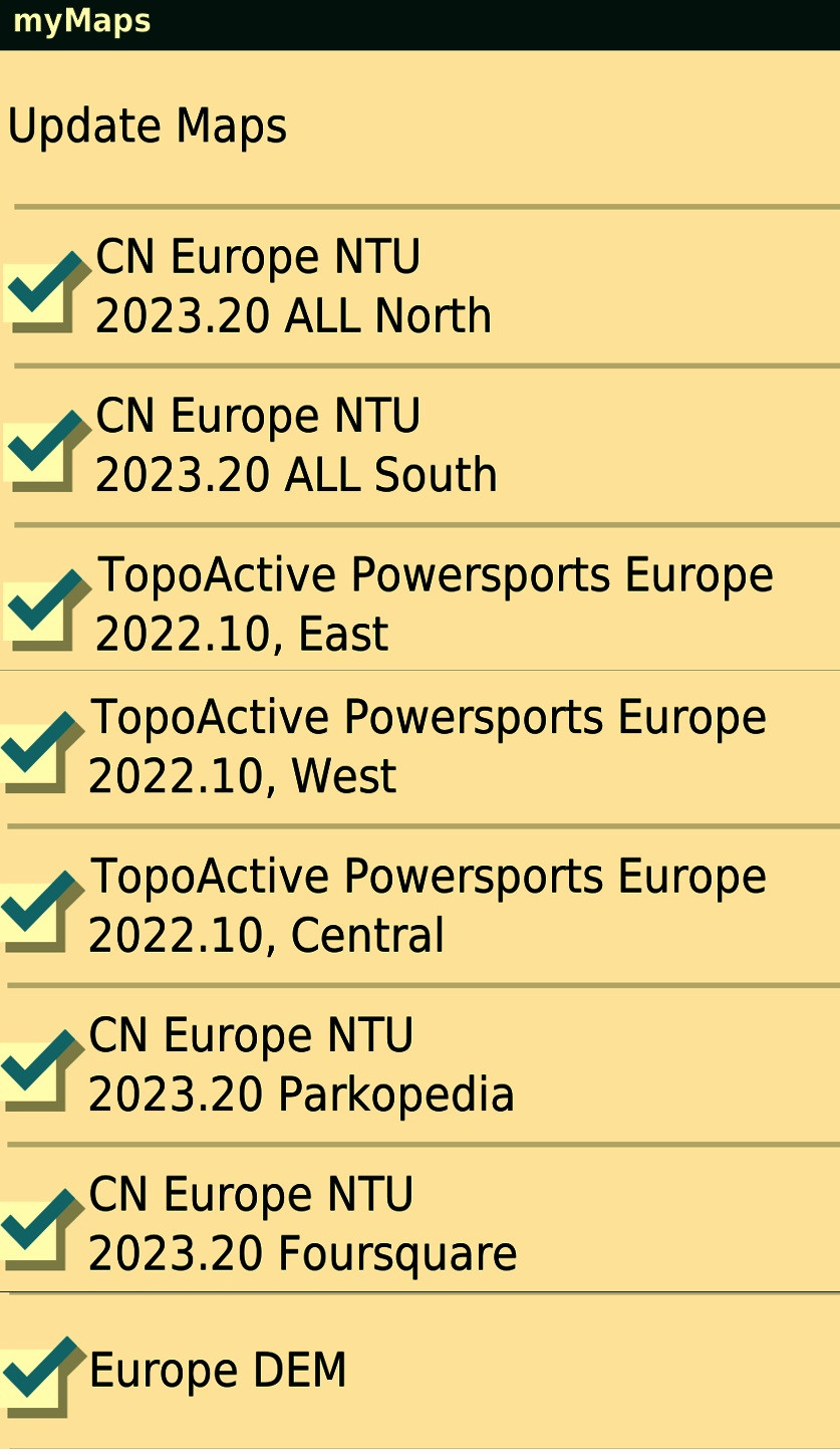

sussamb wrote: Tue Feb 28, 2023 6:57 am Do you keep all maps selected then? If they overlap this isn't a good idea and can cause numerous issues. Perhaps you've found the cause of your problem.
On my side I only have the City Navigator Europe NTU maps ( North + South) enabled + the other stuff shipping standard with the ZÜmo. The "other stuff" I understand (from you actually) is non-routable material and should not be a problem. That being said ;) I have also tried with only the CN Europe NTU North and South maps enabled. Same result (calculating)

Sorry Chris - I was answering Frank, and anyone else looking in subsequently - I know that OEM maps are not the issue with your set up - you sent me the screen shots. It was one of the first things that you checked out.
In fact for everyone else not aware of our previous conversations - as far as I can tell there in absolutley nothing wron with how your XT or your route is set up. All of the possibilities that I wondered about have been tested and eliminated as suspect.

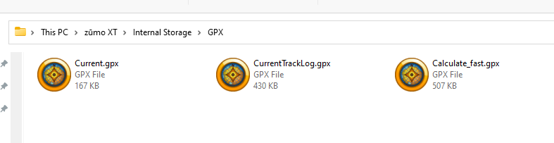

yes. GPS connected to the PC with USB. Then your file copied to the XT using the file explorer .
correction:
The first time, I imported your GPX in Basecamp then used Basecamp / "Send to Device" to copy it to the SD card. Using this method your GPX file is not loading any faster than the original one (~2mns)
The second time I copied your GPX file on the GPS without importing it into Basecamp (using the file explorer) like in the picture below . In this case the route is imported in less than 1 or 2 seconds
