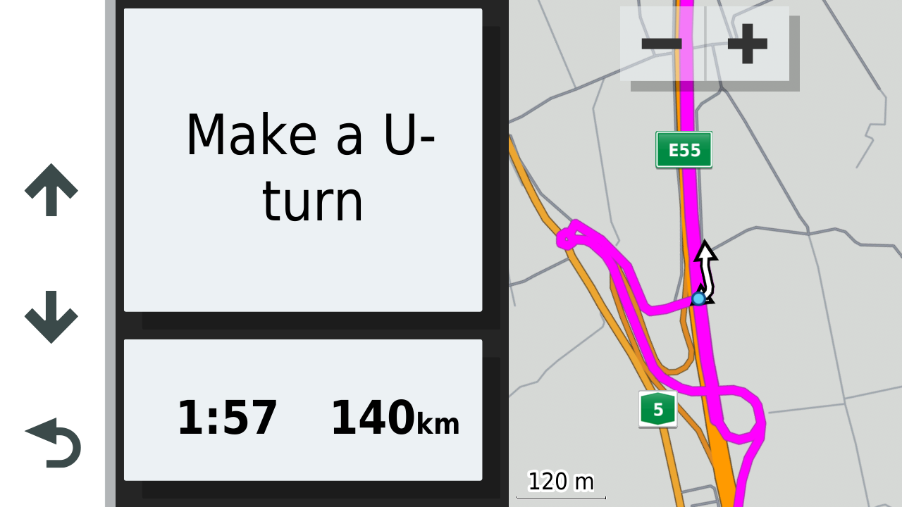

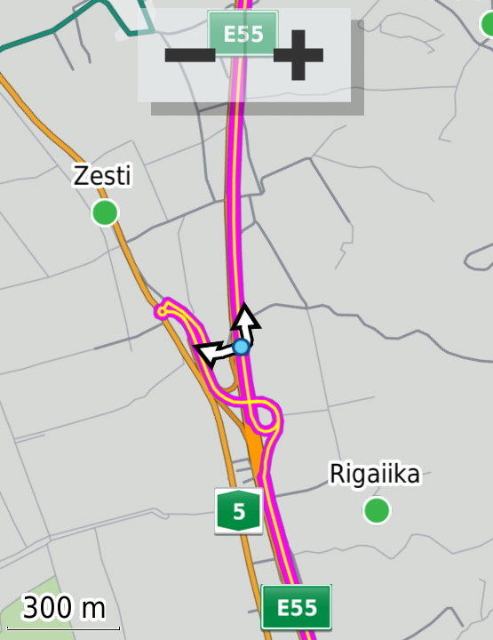

Bingo! I analyzed one of the routes and thanks to FrankB's suggestion I found one of the places that caused me a lot of problems.
Zumo told me to get off the highway and then told me to come back on it, the problem was that I had to pass the toll booths, but they did not issue a ticket, they did not have the option to pay by card, they wanted cash, and we didn't have that
Blue shaping Point are visible, I didn't see it while driving. Now I wanted to correct this route in XT, but finding this point is not easy, because the points have only GPS coordinates in the name, I found it by counting them, because in the turn map it had number 16 This year, I have a more longer route than 5000km to cover, I will have to analyze each of the stage designed in MRA, but most of them, due to such errors, I will design in Basecamp.
I took screenshots to show the problem, unfortunately the attachments (.png format) added to the post are displayed as green or grey rectangles

Re: How to see shaping point on map while navigating
Oh, I see now. My suggestion:Mikul wrote: Sun Jan 29, 2023 3:58 pm screenshots problem solved - had to use Chrome instead of Firefox
NEVER place points in an intersection or (in your picture) a highway interchange. The 595 model would sometimes mess up and do something stupid like that and the XT for some reason seems much worse at it. I place my points well past the intersection/interchange so this problem doesn't appear.
