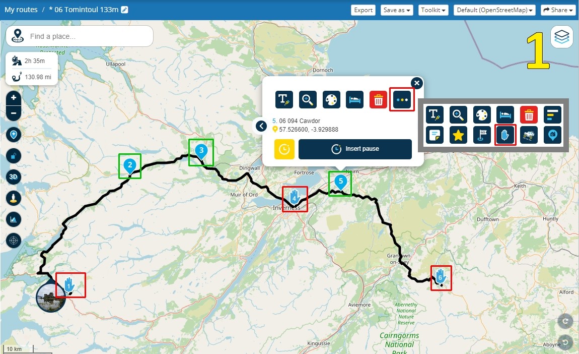

Pic 1 shows an MRA route with 6 route points:
#1 is the Start Point. Always a Via Point.
#6 is the End Point. Always a Via Point.
#4 is a Via Point.
#2, #3, #5 are all Shaping Points.
The start and end points are always Via Points. Other route points are
placed by clicking on the map. By default these are placed as 'tear drop'
shaped Shaping Points - but if you click on any one of them, a menu pops up
with 6 icons. The 3 dot icon produces an expanded menu with 12 icons. One of
these is a hand, and this can be used to change the shaping point to a via
point. Of course, if it is already a Via Point, then you get to change it to
a shaping point.
Two icons to the left of the hand is a star button. This is for creating
'Favourites' which adds the selected point to a list of saved locations
which can be accessed from the left hand menu (not shown above). Favourits
can be added to other routes - which saves having to locate places on the
map again. However, these points simply place them in the route as Via or
Shaping points. They are not the same as Garmin Waypoints, and do not get
transferred to the Zumo XTs list of 'Favourites' (UK) or 'Saved' locations
(USA). AT present they are restricted to being stored for use in MyRouteApp.
