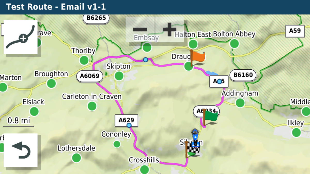

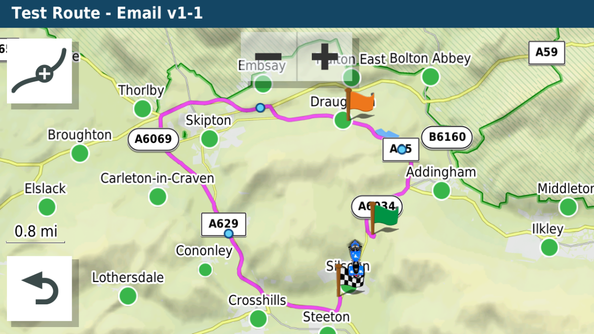

Version 1.1 on the XT screen. Not that Via and Shaping Points are all shown. Click to see a full sized image.
GPX V1.1 On Import.png (929.54 KiB) Viewed 801 times
GPX V1.1 After Recalc.png (930.47 KiB) Viewed 801 times

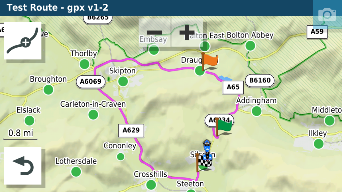

Version 1.2 on the XT screen. No shaping points, but the route has not been recalculated on import, the file contains all of the 'ghost points' and the route remains intact.
GPX V1.2 on Import.png (931.21 KiB) Viewed 801 times

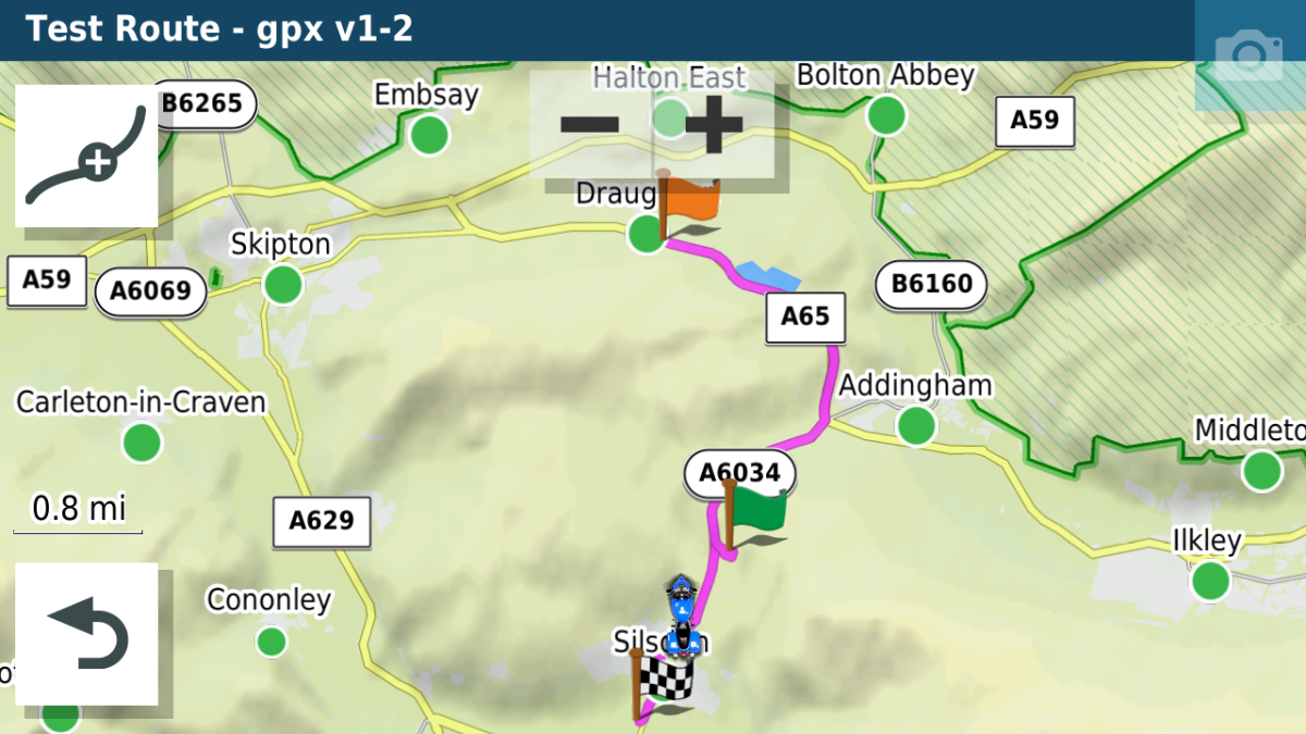

But here, after forcing a recalculation (change vehicle), The route loses its shape as the XT has no shaping points to work with.
GPX V.12 after Recalc.png (833.64 KiB) Viewed 801 times
