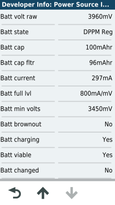

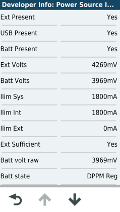

There are a couple of options for displaying battery and mount status. One is in the Developer Info - accessed by the hidden menu - long press the circular speed button. Two screen shots attached.
The other is obtained by long pressing the battery icon in the top right hand corner of the main screen. When in the mount, mine shows it is int he motorcycle mount and the mount voltage is 3.20 volts. Battery voltage is around 4 volts.
