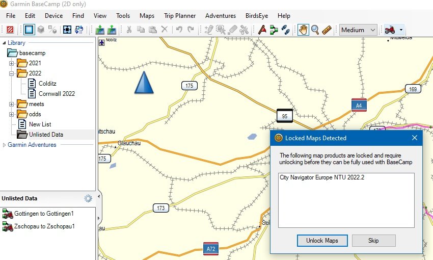

However, when I open BaseCamp, it says that the maps are locked. For the last 2 days I have been installing/uninstalling maps/Garmin Express and Basecamp as administrator as directed without success. I have spent ages on the phone with Garmin and exchanged 15 emails with suggestions and screen dumps of the issues etc.
I have reached the stage where if the XT is attached it says that the new maps are installed do I want to use them? The do not show in map product manager with or without the XT attached. If I say no then I can use BC and the maps on the XT, definitely not ideal. If I say yes, the maps do not work correctly.
In the Programdata\Garmin\Maps folder the maps appear to be there as I am used to seeing them previously, but there is also a folder named RMU??
Surely, there must be a way of solving the install issue, or at least, a way of unlocking them with a code. When I select the unlock option in the dialogue box nothing happens. Also, the page about this on Garmin says that the unlocking option is no longer available.

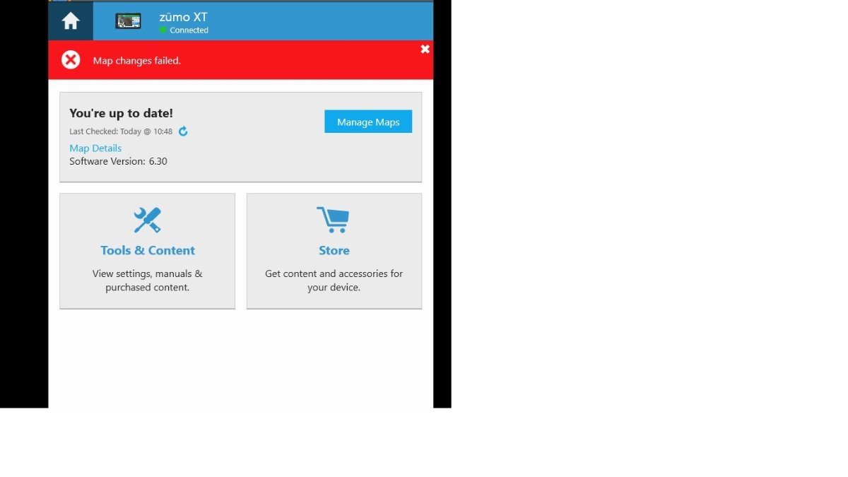

Just tried reloading the maps using GE as administrator and got the same result - all the way through the process including windows installer asking permission for changes, then an error box saying that 'map changes failed'. I've attached screenshots.
