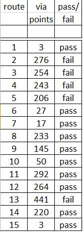

I have added an attachment to cross-reference via point quantity with import success/failure.
I thank anyone in advance for your assistance.

Re: Cannot Calculate the Route
Well routes fail due to complexity and length but I know of no method to pre-determine whether they'll import or not. I'd look at splitting those that have failed into 2, or reduce the viapoints, until they will import. Changing many of the viapoints to shaping points should also work.
