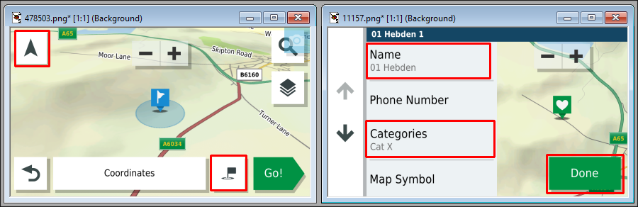

Create Waypoints for your Route
  • Waypoints are saved locations. On the Zumo XT they are referred to as Favourites (UK) or Saved (USA)
  • View Map. Tap the map screen and the display changes. It places a symbol where you tapped. Ignore it for now
  • Tap the North Up arrow.
  • Zoom the map in or out and scroll until you find the place that you want your first saved waypoint.
  • Tap the map to plant your flag point. If the flag is not accurately placed, zoom in further and try again.
  • Tap the black flag on the white background.
  • Tap Name. Change it eg 01 Hebden, and Tap Save
  • Tap Set Location. (bottom of the list int he right hand image below (scroll down) - if it is not there, then the GPS receiver has been turned on again - probably because the screen shut down.
  • Tap Done
CreateRoute 1.png (151.46 KiB) Viewed 4214 times
To explain the above, jfheath wrote: This sounds like a lot to do - but basically, you are planting a flag/waypoint and naming it. Setting the current position keeps your bike position on the screen at the last point that you placed. It makes finding the next point so much easier. Particularly if you are planning a trip ine Europe and you are sitting at home in California. Each new point would require you to scan across the Atlantic.

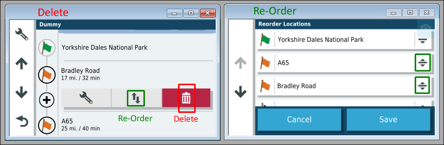

Editing a Route / Trip
When you put Waypoints into a route, they default to being Via Points - orange flags, but any Waypoint can be set as a Shaping Point.
  • Apps->Trip Planner->Saved Trips->Select your Route / Trip from the list
  • That returns us back to the same screen that we had after completing the route / trip.
  • Check the order of the route points.
  • To delete, tap the point in question and on the bar that is displayed, tap the red bin.
  • To re-order the route points, tap on any Via point, and on the option bar that is displayed , tap the double arrow.
  • This displays the entire route, and evey route point, via or shaping, has a double arrow icon at the right hand side. You can point at this and drag the entire line to a new position in the route.
  • When you have route as you want it, tap Save The route will recalculate to adjust to the modified order.
