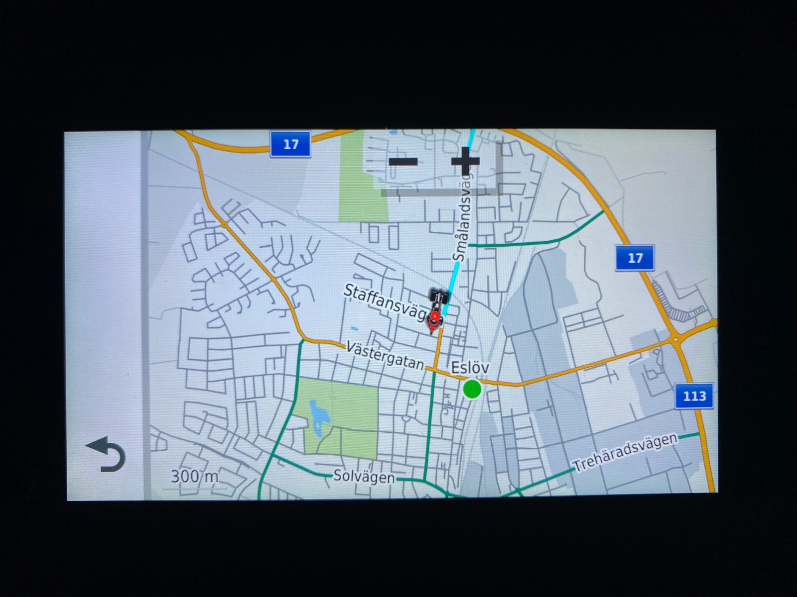

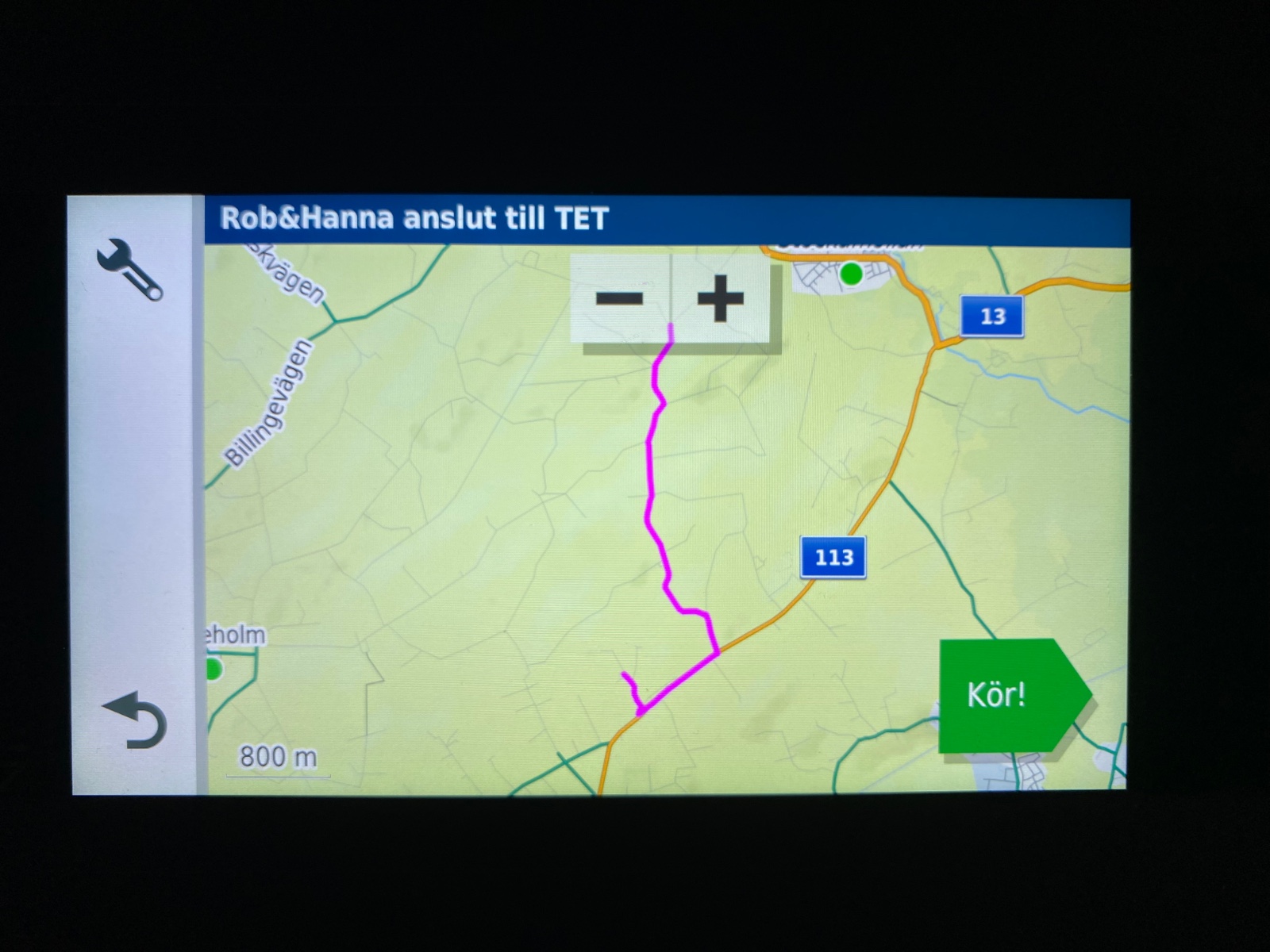

Hi all. New here, but not new to GPSs and Garmin devices.
I have the Zumo XT and I do not use Explorer since I want the old school way of controlling my track display. Recently my XT stoped displaying the wrench symbol when I go into the Apps->Tracks. Some of the tracks still has the wrench symbol but most doesn’t.
One peculiar ting is that the first time I transfer a track from basecamp (Mac) to the device I can always access the wrench and display the track on map. But if I chose to not have it displayed and switch to another track I can no longer see the wrench symbol on the first track.
On the attached pictures you will see the wrench symbol on one of the tracks, but not on the other. What is going on?!
Thanks
Magnus
Thanks
Magnus

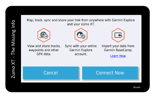

1) When you select Where To ? -> Explore - do you get another menu or do you get a screen with 3 icons and two option buttons 'Cancel' and 'Connect Now' at the bottom. (sorry - you will have to translate that into the language that your XT is set for (Swedish).
When you first get an XT it is difficult to know what is about to happen - and you set up Explore without realising it. You cannot get rid of it without a system reset. This applies whether or not you have the Explore app on your phone.

1) reveals whether the XT thinks that it is using the Explore App in which case the option for turning tracks on and off is in the section in the Explore menu Collections. Tracks are made visible by turning on the collection to which they belong. Probably 'Unorganised'.

I cannot find a map that looks like yours.
I have found one that is similar by going to
Apps->Tracks->Saved Tracks and selecting one.
but for me, this shows the spanner / wrench
and
by viewing an active route, tapping the banner, tapping the map icon
This shows a preview of the active route, without a spanner/wrench tool - but it does not show the cyan track - which is usually the colour for your active logs - "where I have been" - but for me, this screen does not show that cyan old track.
So the next question is - how did you get to that screen ?

From Home->Apps->Tracks->Saved tracks->[select track]-> and I have the screens I posted. Some times with the wrench, and some time without the wrench. Track colours are defined in BC and carried over to the device. That is why I have different colours on the tracks in the screens. I might not follow fully..
