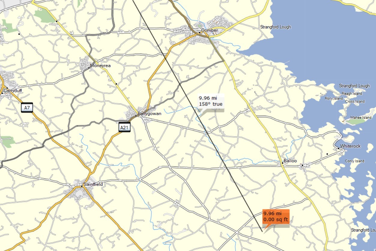

twowheelstom wrote: Mon Feb 17, 2025 3:24 pm I never experienced what is called the RUT issue, my only experience is with the 550, and from what I know so far about RUT be what i read, I think that just putting in a waypoint destination only with no shaping or waypoints, just allow the zumo to calculate on its own, will solve RUT, will this work?
Yes, but many of us define convoluted routes on the many small roads that we have in the UK and Ireland rather than going from A to B. These are some of the Little roads within 10 miles of where I live.
Screenshot 2025-02-17 193729.jpg (239.81 KiB) Viewed 2936 times
For those of us who have ended up with an XT, that I have or XT2, it means that Basecamp which was WYSIWYG with older units (in my case I also use a Zumo 340 and 390). Getting to grips with the foibles of the newer units is somewhat frustrating.
