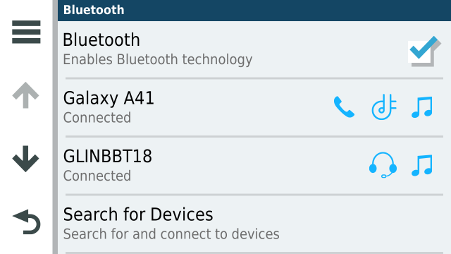

So in the Bluetooth connection list on the XT, you should see something like this.
GLIBBT18 is my cheap headset for testing things on at the desk. It does the same job as your Senna as far as the phone is concerned.
Galaxy A41 is my phone. It is running the drive app - but i have not allowed it to install the link with Explore. This means that data can come from drive through to the XT.
The phone symbol implies that the headset is also acting as the phone - which you do not want.
So you need to set this up before the Sena is connected and then click on the list of connections on the XT.
You then need to tap on the phone connection to get a menu that looks like this for my Galaxy A41.
In the BT list shown above, there may also be a 'Smartphone Services' depending upon whether or not you have an Apple phone or an Android. It controls notifications. Android devices control notifications inthe Drive App. iPhone notifications are controlled from the Smart Notifications.
Garmin Dive is connected. OK
Phone calls is connected. Not OK - you want that unticked.
Media is connected. Probably not -you want your media to go to the Senna, not to the XT. Untick it.
Drive is connected to the XT.

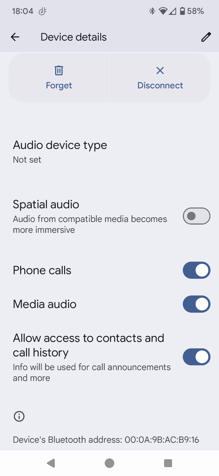

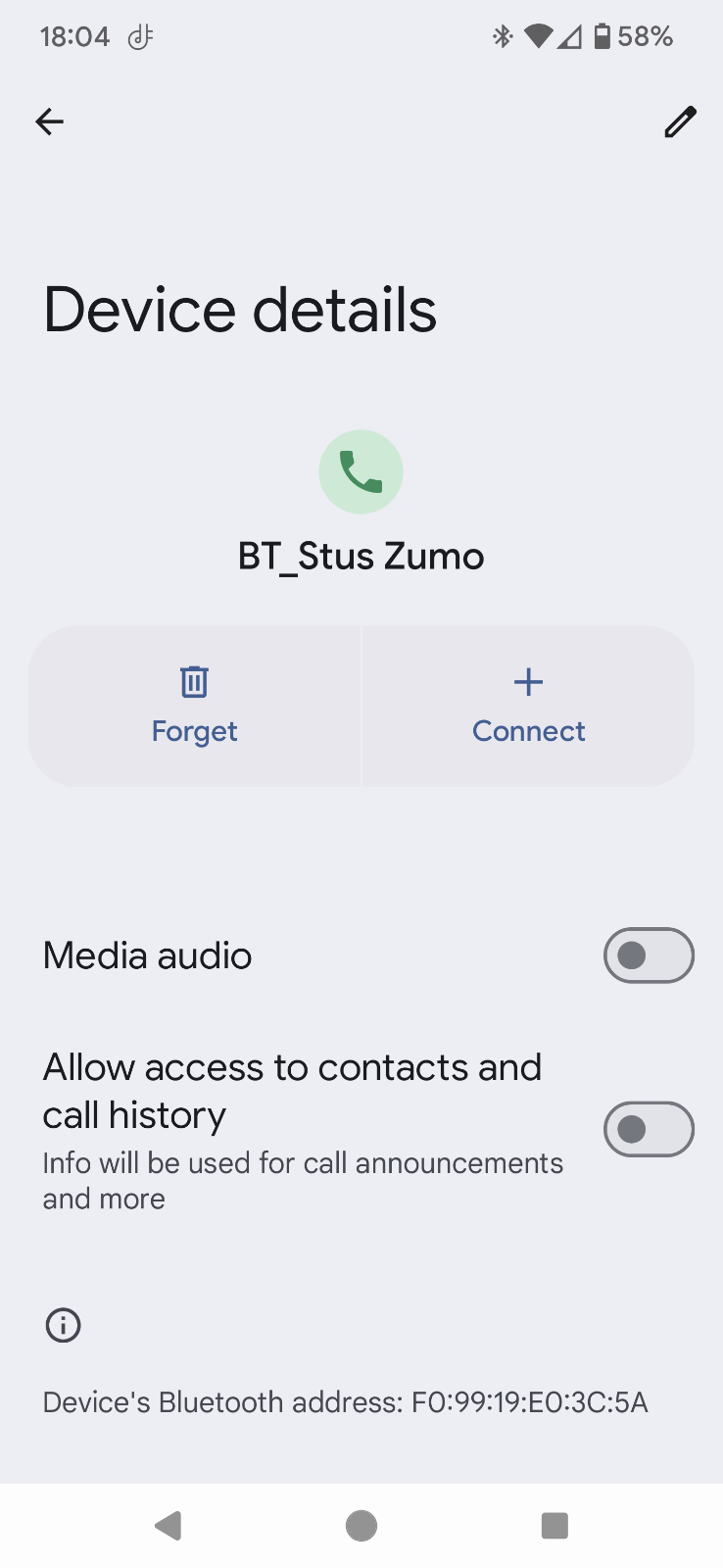

The settings you need to change are on your phone not on the XT
connect everything up then go to bluetooth settings then click on the settings for the XT
This is the settings I have using a Cardo Edge
This is the settings for the Zumo
