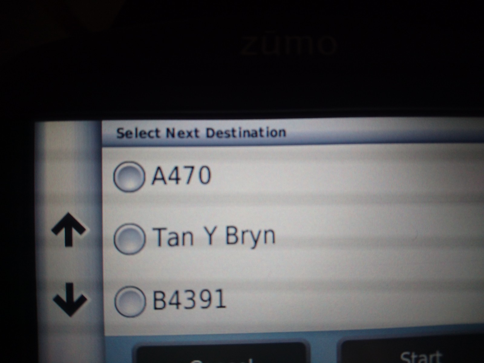

I'm attaching (hopefully) a screen shot from my Zumo and also of the route (in magenta) in Basecamp. As we can see, the Zumo is asking to" select next destination" which brings me back to - where am I an the route!?! :D
I don't know if it's the way I'm using Basecamp?
Thanks again.

OK
Thanks for that Info - so the Zumo is treating those Basecamp flags as Via Points. (Alert on Arrival).
Good to know that the battery is OK. It should retain your route and just continue to navigate when you plug it in. But that doesn't answer your question either.
A few things that you can try. (ie they work for the later Zumos, and may work for you). It will involve a little experimentation.
1. Load the navigation map and zoom out. That should show your current position and also the various flags via points.
2. I believe that the 340 has a Skip button. If you tap that, it will remove the next route point from its list - but on later versions it prompts you beforehand and gives you the name. eg "Skip Tan Y Bryn" and then to buttons - Yes & No. I couldn't say whether the early ones did this, or whether they just skipped the point, or didn't give the name. You'd need to check. If it gives the name, then that is the next point that you have not yet ridden through. So then cancel the Skip operation.
3. In Bascamp, double click the route and higlight all of the points between the first and the last point. (Don't highlight the first or last).
Right click on one of the highlighted points and select the option to "Don't Alert on Arrival (Shaping Point). Then choose one in the middle (your stopping place) and right click on that and set that to "Alert on Arrival" from the pop up menu. Send that modified route to the Zumo and see what it looks like when you start a route.
What I am trying to find out is whether your 340 knows the difference between:-
* Via points (Alert on Arrival) (flags)
* Shaping Points (Do not alert on arrival) (discs)
On later models, only Via points which Alert on Arrival are listed as the next destination.
So What you get when you start the route is just 3 points - the start, the finish and the coffee stop to choose from. But there are disadvantages with that - which I explain in #5 below,
4. When you load a route, and say GO - do you get a preview map of the route ? If so, that can tell you where you are in relation to the various route points. MY 595 has the option under System->Navigation->Route Preview. But my earlier 590 does not have the option - the preview map just shows up automatically.
When I had my 660 and when I used my 590 I used to name all of the route points with a 3 digit number. The 3 digit number referred to the milage from the start - something that I obtained from the Route planner list in BAsecamp (with 'More Info' selected at the bottom of the route list). Double click the route or the name of the route to get the route list. Then by doubleclicking on each route point, I could add the milage.
eg 123 Tan Y Bryn
At the start of each ride, I would set the trip meter - either on the satnav or on the bike (On most zumos you tap the speed display button, bottom left) From the menu on the display that follows, you can reset the trips. Then you have a figure that you can compare with your route points.
I hardly ever did this in this country - but when going abroad, it was essential - I had no idea where the places were in relation to the route. It was the only way that I could come up with that I could use to get out of problems.
So your list would look something like :
023 A470
050 Tan y Bryn
087 B4391
So if your trip meter says 065 - you know where you are in the list.
It is contrived and a bit of extra effort. But I did use it in Spain and Austria - and it worked. In fact I still put the milage in front of the names of locations - something that was scuppered by the later Zumos - they rename the route points, but I found a way round that.
5. Now if you change most of your route points to shaping points to reduce your list, then when you select the next destination - it will take you straight to that. So Say your only stop is at Betws, and you are heading north. You stop somewhere near Dolgellau and you need to retsart your route. Your only point is Betws, becasue the others are shaping points. If you select Betws - it treats that as your start point and takes you direct to Betws - so it will miss out all of thos excellent roads to the east, and take you up through Barmouth and Harlech instead.
So there are pros and cons about using Shaping Points. The mileage method worked well for me. I don't mind standing and working things out at the side of the road, but with a pillion. In the rain. Getting Cold. Feeling hungry. Fed up. Tired. Getting dark........ I like to have a security blanket, and naming my route points with the mileage was mine.
So 2 favourite methods.
* Use the preview map and count the number of flags that are behind your bike. You want the one after that.
* Use mileage in front of names and remember to set a trip meter when you set off.
Stick with using all Via points for now. Shaping points provide flexibility but they are a lot to take in if you have only ever used Via Points.
Later Zumos - starting with the 595, and similar Zumos - get around the problem. In the list of route points, they have "Closest Entry Point" and that takes you to the closest point on your route and navigates from that point onwards.
