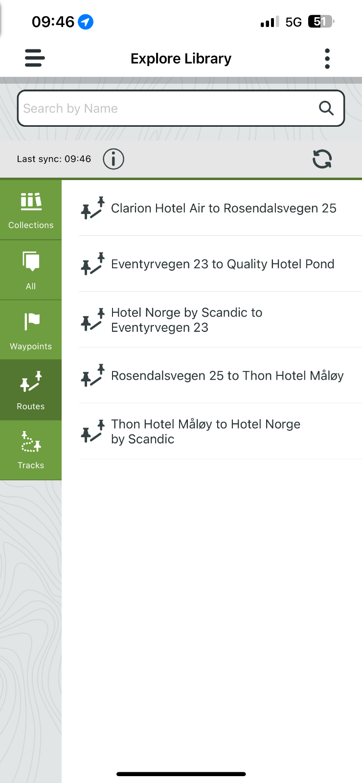

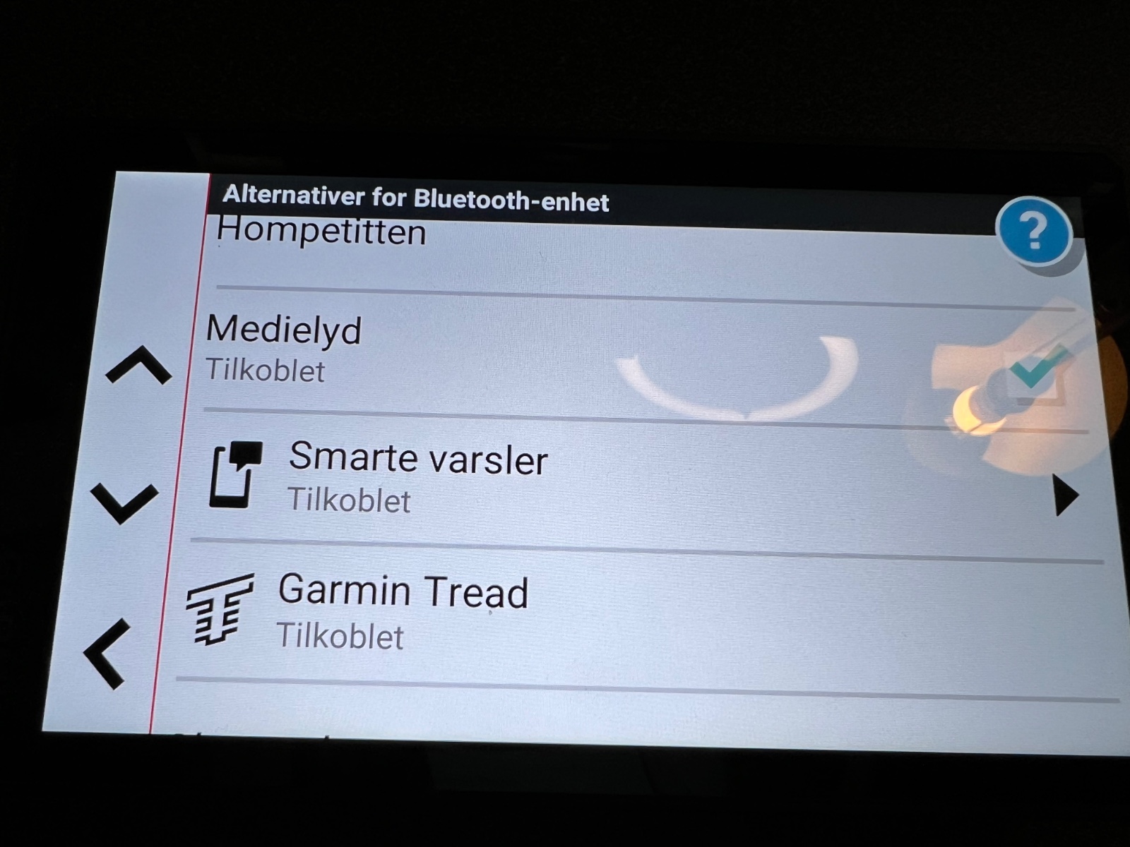

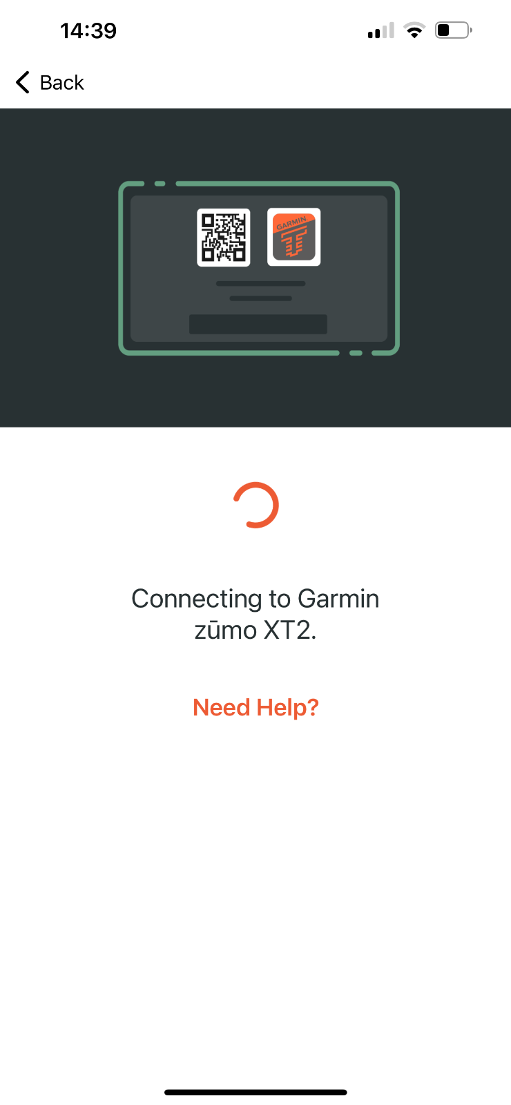

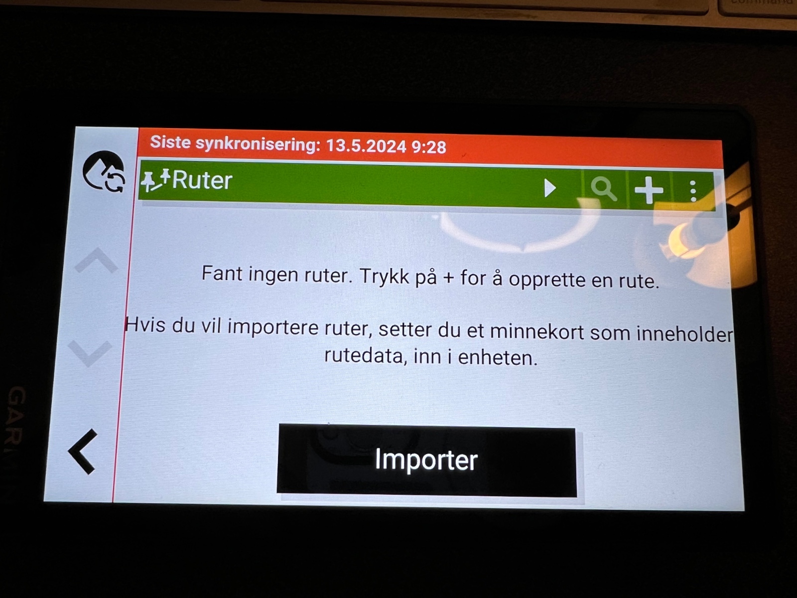

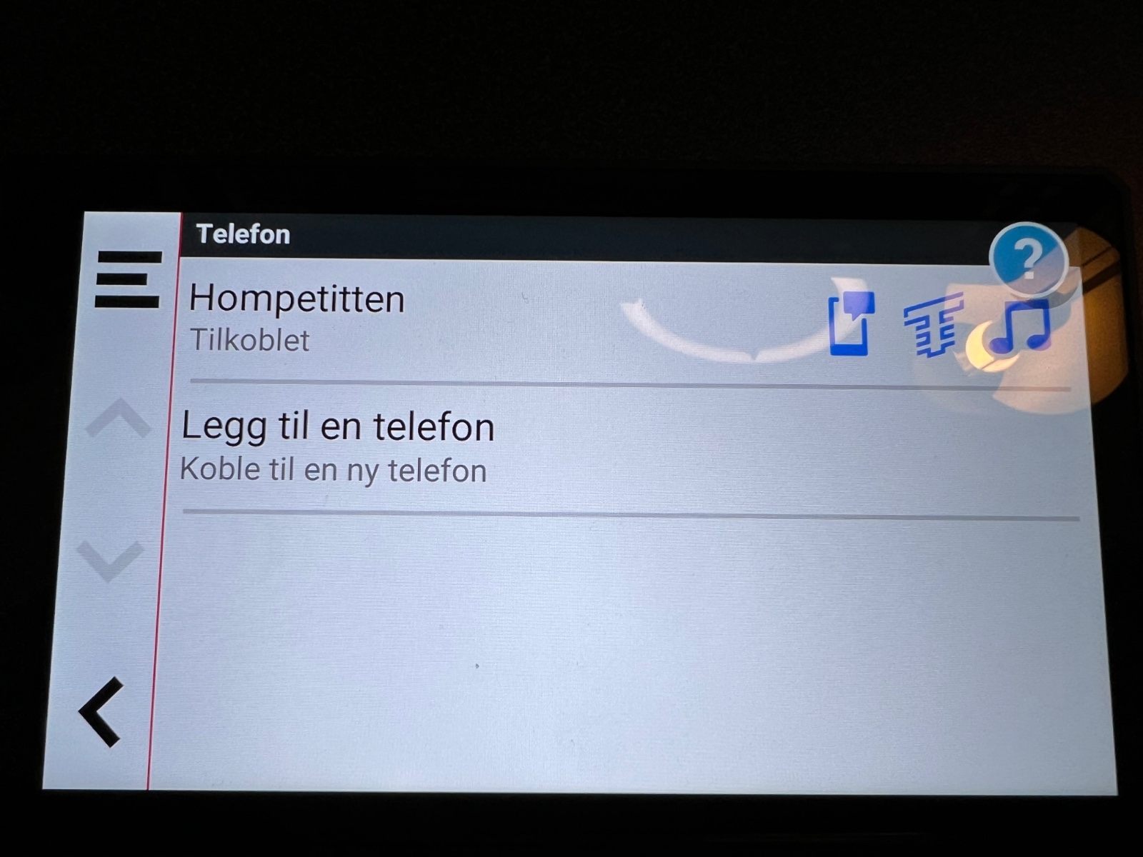

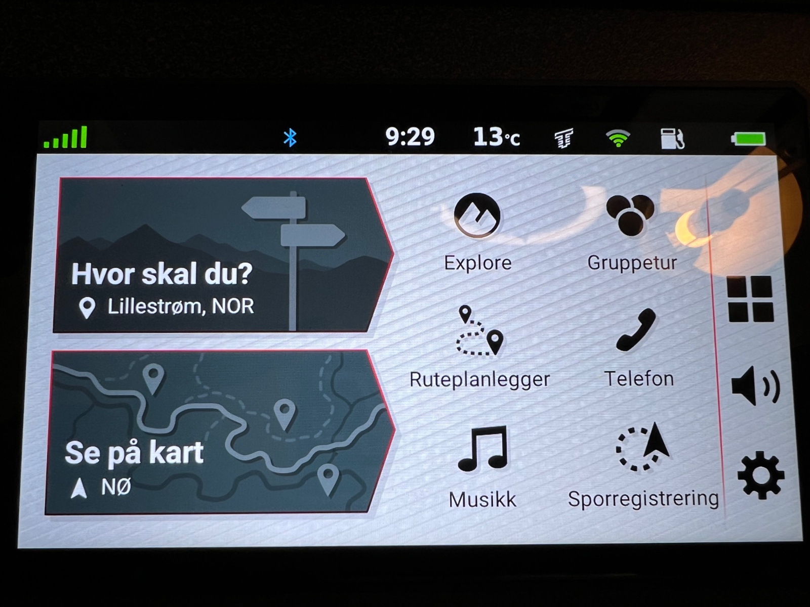

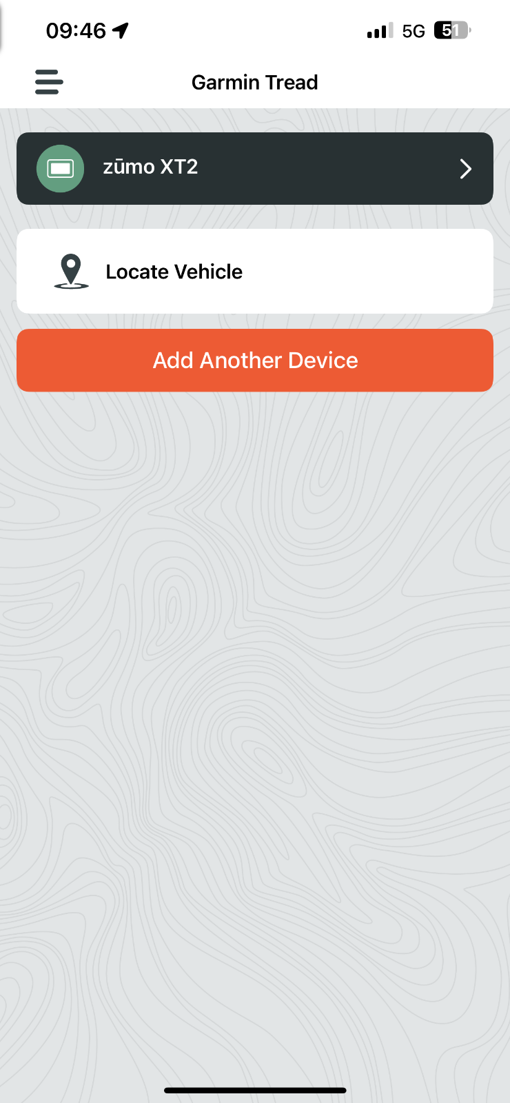

Tread app and XT2 are connected and syncs. But only from the XT2 to the app. Routes on the app are not synced to the XT2. Why?
I’ve rebooted the XT2 several times. I’ve uninstalled and installed the app. No difference.
Attached are pictures of the app and XT2
Thanks
Thanks

Thanks for the reply. I can import via the SD card, and it works... I am now importing my GPX files into Explore on my Mac, then entering the explore app on the phone, and exporting to the Tread app, and it somehow works... So workarounds work, but not as intended with the Tread app in a easy way

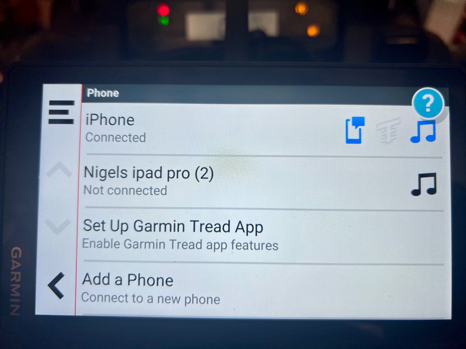

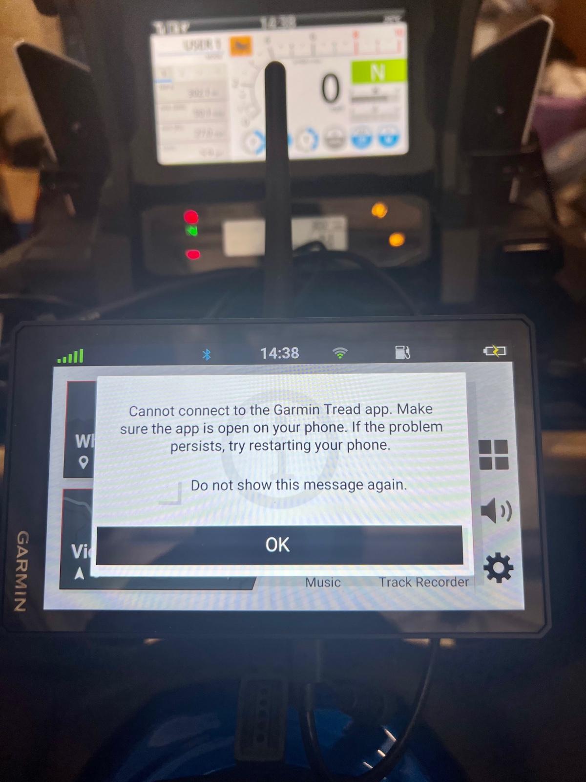

Hi Guys,
I’ve just invested in the new Garmin Zumo XT2 to use on my Honda Africa Twin.
I can’t seem to get a proper connection at all to the Zumo using my IPhone 13.
It. Connects partly, but won’t connect to the threads app.
Is this the bugs in the app as mentioned above?
Re: Tread app not syncing to XT2
Welcome to the forums !
I think that your phone may be connecting to something else rather than to the XT2. Your iPad Pro perhaps ?
Take them both away from any other devices. On the phone, forget the Zumo. On the Zumo, forget the phone.
Take then both for a walk away from other devices, and get one to search for the other.
That may fix it - but you will need to check that the phone doesn't go playing away the next time it goes back into the house, preventing your XT2 from connecting. Remember - your XT2 will keep turning off if it doesn't have a constant supply, and it will break the connection.
But once established - my XT2 and phone connect first time every time when they see each other. And it will connect to other devices as well - but once it has its priorities right ....
