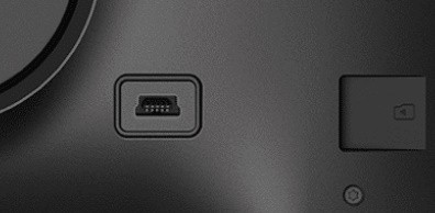

The side view of the USB plug is poor, but I think it shows a mini-USB. Looking at my micro plugs, lighting at that angle shows a single line between light and dark sides, while a mini-USB plug shows a dark line at the indentation bordered by bright reflections on each side.
I found a rear view of the Drivesmart 65 at [url]https://funtreks.com/product/garmin-drivesmart-65/[/url.
Looks like a mini-USB to me, same orientation as the XT.
Specs show ample power, so I think it would work.
I checked the part number for the adapter (320-00239-50) supplied with my Garmin XT car mount kit and found it also works with about a hundred other Garmins, including the Drivesmart series.
Although I think this charger would work, I would use a generic multiport USB adapter with at least one 2 amp port and a separate USB cable. Search for a "USB 2.0 A to Up Angle Mini-B Cable" of about 3 feet. The adapter and cable will be less than half the cost of the Garmin version.
