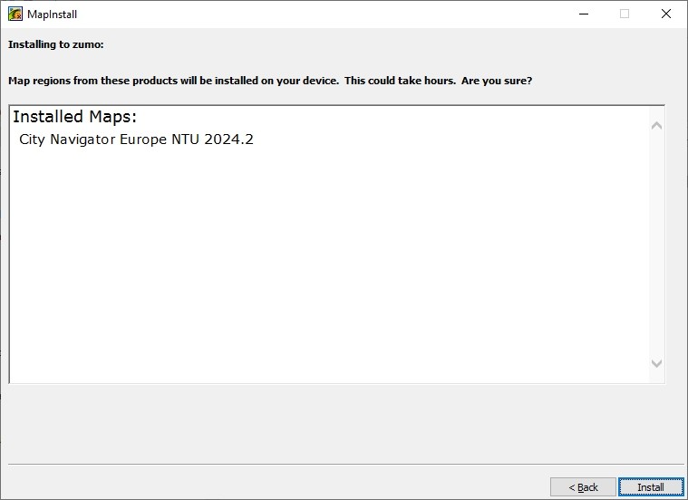

Open Express, click the gear icon to see this screen.
Untick all of the boxes. Click OK. And then close Express

Install, load Mapinstall onto your PC.
Let it find your Zumo, which should be plugged into the PC via its PC port.

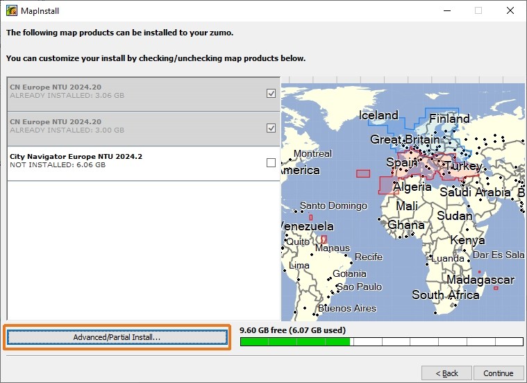

When the Device box shows your zumo, click the customize buttom
Observe maps installed and the amount of free space available. If there is not enough space, you may have to make some by deleting the existing maps. For that you need to go into the Internal Storage / Map folder and get rid of the relevant .img, .gml, .unl files. Which ones, I do not know, but I know that you can use Basecamp to find out which numbers go with which maps. It would be a good idea to copy all of these to your PC, so that you can put them back again should it go wrong. SOmeone with a 660 at hand will need to help you if there is not enough room.

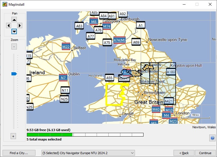

Back to the plot, assuming you have space. Click the Advanced/Partial Install button
On this screen, you can zoom in and select the regions that you want to install. Click the region to select it for install - it highlights in yellow as you are over it, and then in black outline when it is selected. Use CTRL and left clcik to deselect a region. You can see the green progress bar showing how much memory is used and is still left.
I suggest that you try this with a couple of small regions before doing an entire area - just to make sure that it works. It'll save having to wait a few hours for it to complete, before you find out whether it worked or not.

Happy new year to you and yours,I have managed to down load the maps to my pc only and using map install with the 660 connected it tells me I only have 8 gig or so space to use even though I have a 16 gig card in plus what the unit has so Western Europe will not fit.can I simply remove the card and put a new one in or does some of the software go onto the units drive?the 660 works fine as is and the maps it has are 2018 which are newer than I thought.I ride a bmwr1250gsa and have use of the connected ride app as a back up,so until I can be 100% sure I will not mess up the 660 I think I will leave it alone for now.one thing I have picked up this forum knows more about garmin nav,s than garmin do!or do they just want to sell new kit?.many thanks for all your replies they are very much appreciated happy trails bud…..
